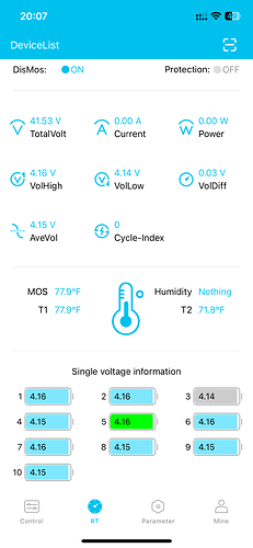

Hi! Does anyone here use JBD BMS? Why it is “only” charging my battery to 41.5V, instead of 42V? Maybe it is some settings?
What’s your charger voltage at?
I measured 42V.
I’ve seen that happen a lot. I wouldn’t worry about it cause you’re only losing like a single percent of battery capacity and it is a bit healthier for the battery to just keep it like that.
It might have charged to 42.0V.
Every pack will settle back down in voltage a little after charging stops. This is normal and as @Akbrock47 mentioned it’s only a tiny drop for your setup. Your pack is fully charged. :slightly_smiling_face:

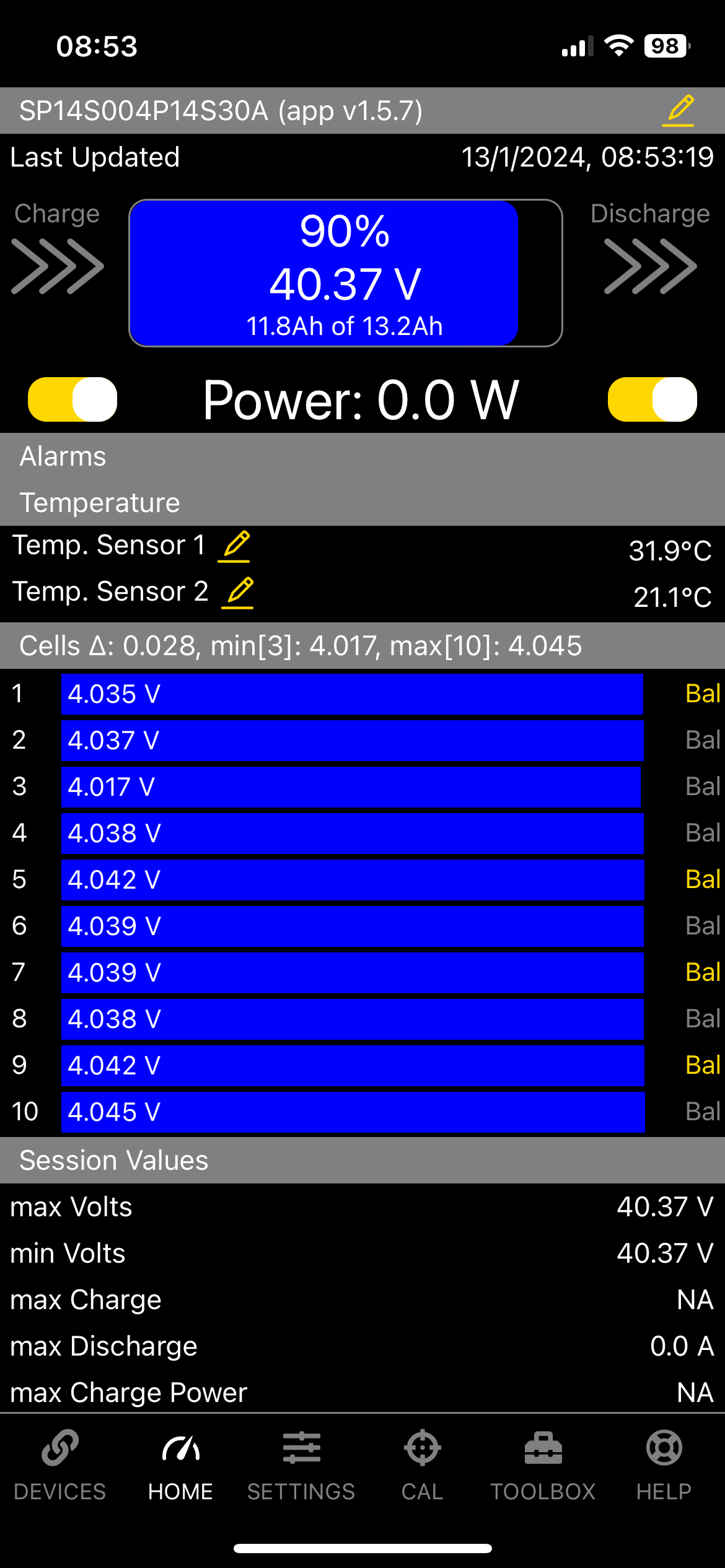

The BMS has been running for 7 days, drained the battery by about 10% (bluetooth + balancing). I am going to add a physical switch to turn it off completely when not in use.
All the time cell 3 is a bit weaker than the others, and the best delta voltage I can achieve is about 20-30mV. Is this an acceptable value?
When I am removing BMS and I am trying to balance with my active balancer I achieved 0.009V. Then it goes out of balance a bit when I remove the active balancer.
Two pictures there from the first and last day:
Good idea.
That’s fine. Tighter voltage grouping is a complete waste of charging/balancing time unless you know how the cells match as they discharge. A 30mV spread won’t affect performance IMO.
That’s no problem at all. I regularly balance to a 45mV-55mV spread without worries. It speeds up charging and doesn’t result in any performance issues since I am not trying to run down to low voltages (where imbalances start to show up).
