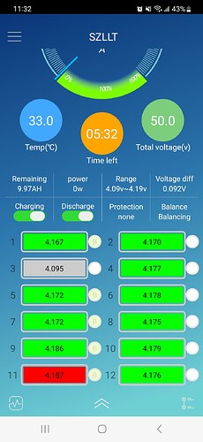

So this is a 12S4P with 40T cells I built a while back.
Currently lives in my Khymera build.
And I would like to ask on a scale of 1 to Kaboom, how much of a bomb is it right now???
Pretty notable voltage differences.
Do I need to take it out ASAP?
Is it ok to try to balance it?
This was after riding a 4-5 miles last night.
And this is after charging.
I have set it to balance, and it’s slowly coming down.
Not super bomby. I’d get it perfectly balanced and try it just a little bit (going easy) and see if it breaks balance. If it does, it absolutely needs p-3 replaced. If it doesn’t, it’ll likely need a bms change.
I can’t emphasize enough how easy you need to take it when you bring the charge down.
And by perfectly balanced I mean ~ .020 delta
Co-sign w @Akbrock47 but I’d say that maybe replacing group 3 isn’t necessarily the right move. Cycle it a few times pay close attention to the groups that are highest and lowest and how they behave.
Group 3 is charging more slowly than the other groups and is well below the avg SOC but tbh, I think group 11 is more problematic and may have some broken welds. After your ride it was right in the middle of the avg voltage of your pack but then ended up as the highest group after your charge.
What are your parameters? Is the LLT set to charge to 50.4v? Did you try and take it to 50.4v during this charge? Did an overvoltage cutoff prevent you from completing the charge to full?
Yeah 11 seems to be having some bad issues too. Didn’t notice that.
I think they key takeaway is to do a bit more testing and really keep an eye on 3 and 11
Fairly certain I just have it set to charge at 50.4
And something I did not mention is this pack maybe 2-3 years old, and has seen lots of miles.
It is inching down slowly…

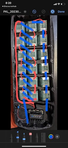

The reason for the weird pack is that I’m trying to fit an 18s into a single stack enclosure and modding the deck to suit. It was Cadding it up that got me thinking about the balance wires and how I was making the packs wasnt going to be simple with balance wires. So I had a look at it today when it wasnt 2am and came up with this which has the BMS at the back and I think the pack works if I havnt cocked it up.
If I’m on the right track I can continue making the packs while I wait for the nickel to arrive.
