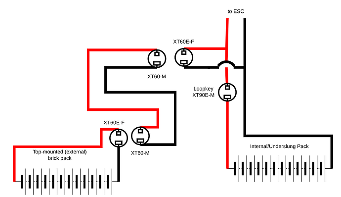

for an “AUX pack” like exway does, like a secondary topmount battery pack for underslung battery boards… how should I go about connecting it?
my initial instinct was to just run a parallel port in my underslung enclosure and parallel the batteries when both were at a similar SOC
then I thought of running it into the charge port, but more questions came up, like would that work with the underslung BMS? how would charging need to work?

Best idea imo is just using it as a swap-pack. Store it on the board, charge it separately, and use a swap cable to switch between the internal pack and the top mount
I want the underslung enclosure to be self-contained and semi-permanent. Would this mean I need to fit a second loopkey port to disconnect the internal pack and connect the external one? Or rather, I guess I’d just run it into the parallel port, and have the loopkey disconnected while using the swap pack, having the loopkey port between the internal battery and the parallel port.

Should this connection have antispark? Would having the female side mounted on board be okay?
I would make it so the cable that connects between the two IS an antispark, so when you switch the plug from one pack to the other, you won’t have to worry about it
You could alternatively have one lead (negative) permanently connected, and then have an AS150 as the other lead that you connect to one pack or the other

so taking into consideration both of your methods this is the schematic I’ve come up with, charging not included as that’ll be handled by each battery’s BMS individually.
Loop key should be closer to the ESC so it shuts off both batteries. As it is, it will not shut off the top mounted battery to the ESC.
I figured the method for shutting off the topmount battery was to unplug the cable, acting as a loopkey.
alternatively, I could have a loopkey mounted into the topmount battery as a separate shutoff.
It will spark then. The capacitors in the ESC is what makes it spark.
so would I need a double loopkey setup? just needing to swap a single loopkey between 2 ports to switch between 2 batteries? or 2 loopkeys?
Just one loop key

so this just means I can only connect the packs when the voltage is close, say within 100mV?
The math has been done somewhere, but even at 1v it’s only about 10A charging or something like that in my experience. It drops pretty fast as the voltages equalize. I use a DC clamp meter sometimes when connecting if I’m not sure.
if my pack can handle up to 24A charging current can I connect them with a larger delta?
theoretically, I don’t intend to do it if I can help it
