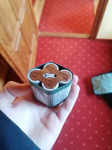

Hey guys, i would like a little help regarding my battery build. My plan is to stack 2 or 3 layers or nickel on a 4p p42a group, series connections will be double 12 awg, nickel is 0.15*8mm (see attached pics for layout) unfortunately I’ve read that stacking nickel is not up to current standards but I’ve already welded the first layer on the groups, my question is:
How can I make it as safe as possible this way (without tearing up the nickel and redoing it) also I would like opinions regarding if I should use 2 or 3 layers.
Any help is appreciated

As I’ve wrote earlier I’m more interested in stacking of the nickel strips in a safe way and also if I should use 2 or 3 layers.
Originally I was thinking about 3 (0.15*8mm). in the configuration I uploaded technically all strips going to the series connection only carry the current of one cell. Since I won’t be running the pack at full all the time maybe only 2 layers will do, opinions?

If you need to deliver more amps to the series wires, you could solder 4 of them, one between each cell. This creates minimum hotspots as each cell sends its current off on 2 directions, fully utilizing the available nickel. Hypothetically good for 30A per cell with 0.15x8mm
Don’t need to do all of them, just 3 is fine.
It’s not about the capacity of the wires, but the path current takes through the nickel. Refer to this hasty napkin drawing:
(Red = current source, blue = current sink)
Leaving out one wire will redirect two of those “17A” arrows to “overlap” with the other ones, reducing the capacity of the system
I see what you mean. If you leave out the 4th one the nickel.needs to deliver more current from the left hand cells
