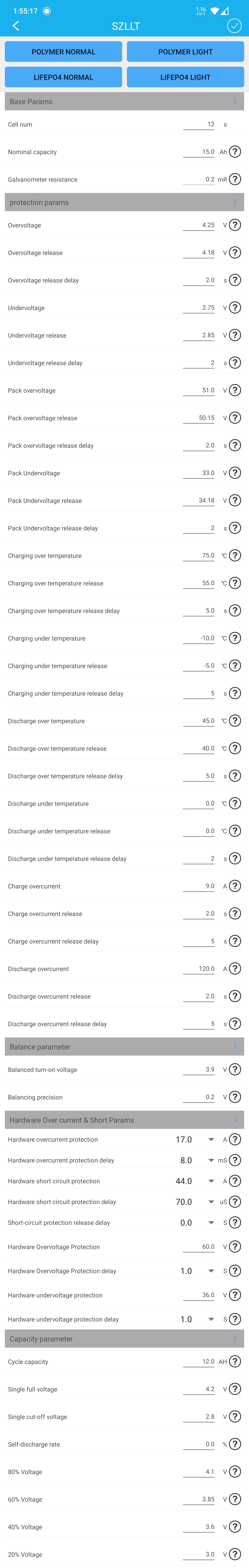

So here’s what LLT is showing:
Meanwhile on the charger:
And heres my LLT settings for completeness of info:
My question is, is this bad/ how do I fix it?
Ps: My battery had a delta <0.2V before plugging it in, was almost dead. I’m not worried about my delta I’m worried about this odd. behaviour. Unless the two are related.
Charger is broken.

So my 13s charger behaves the same way, and a 3s charger is also behaving the same way on a 3s3p pack I built.
The flickering has different timing on all of them but is happening on all of them, using a DMM to monitor the 3s pack.
Seems the BMS is done then. Bump the charge overcurrent setting way up, if it still happens, new BMS.
Seems I need a new BMS. Fuq.
