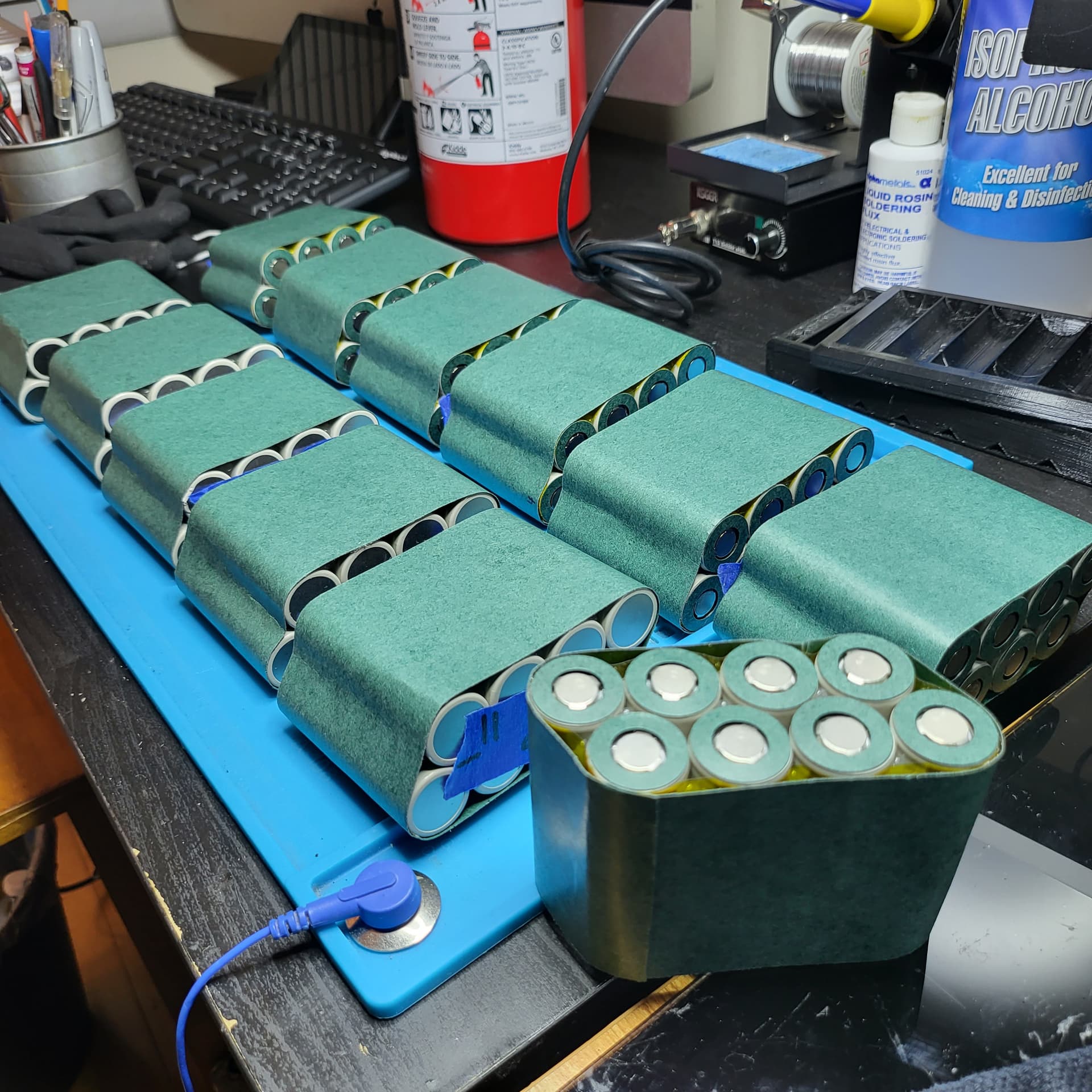

Is Kapton tape an electrical isolator or should I replace with a new battery wraps
Yes
Depends, if you wrap the groups, no.
thx…
The positive side isolation rings should be fish paper or is carboard sufficient? I noticed the ones I’m using are cardboard. I placed an order (thx @DuckBatterySystems) for fish paper rings because I don’t like sparks. I just want to know what the standard is for positive side isolation.

Welding starts tomorrow. First true battery build without modules.
Anyone used crimp Clamp pliers or end nippers to remove welded nickel strips from cells? I saw someone post somewhere (I know, I know) that it worked well and really minimized the amount of Dremel cleanup needed afterwards.
Speaking of removing nickel…should I replace this or leave it as is?
Don’t rely on this it doesn’t always work
I wouldn’t see it as needing replacing, but I’d wait for one of the big brains
thx, I totally missed the positive post on that weld
