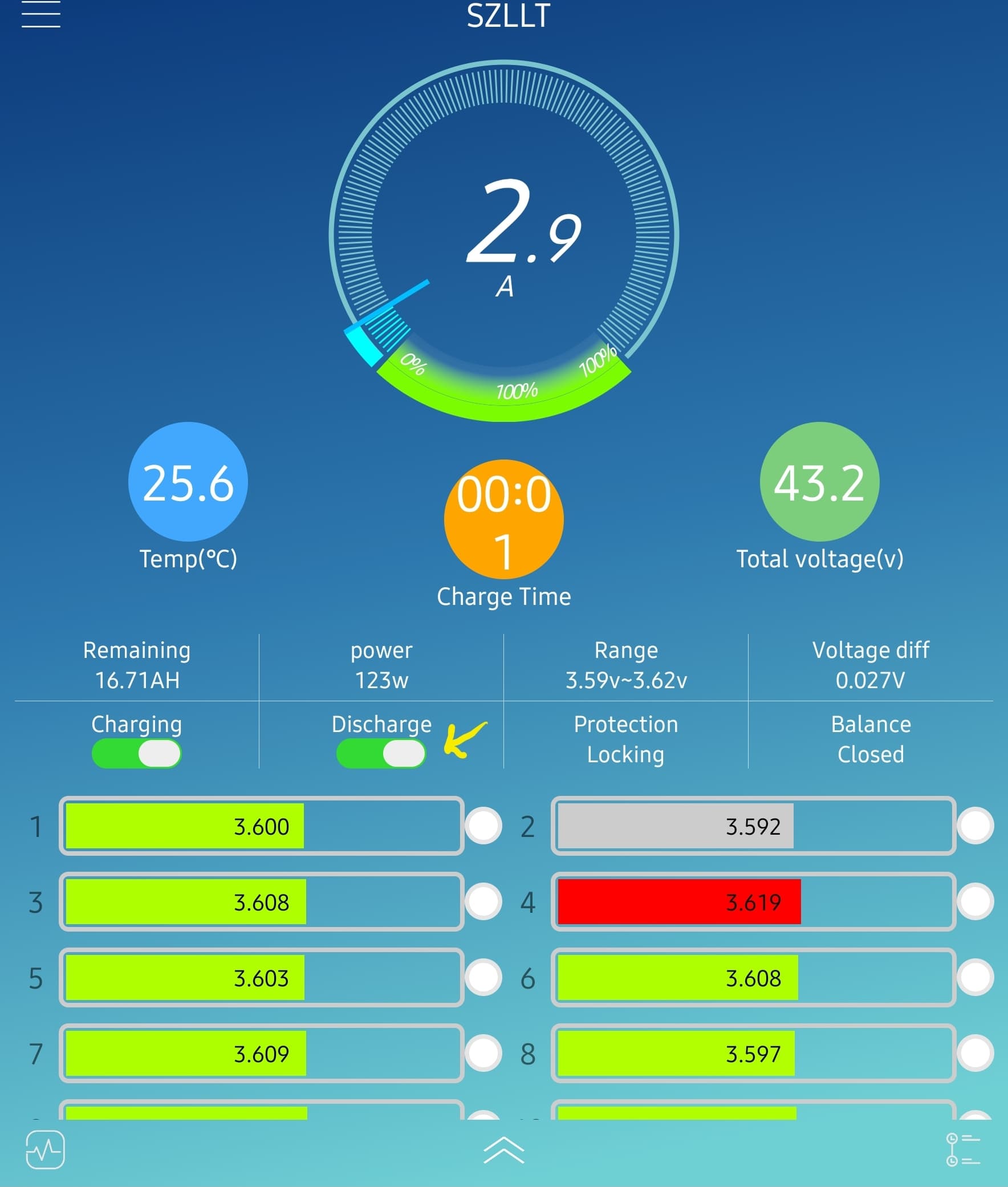

Switch function enables the function of the power switch port. Discharge enables, you guessed it, the discharge. If you run headlights off your main pack this function makes for a great soft switch for turning them on, no physical switch needed.
Connect the output of the BMS to a NO relay, then nobody can activate your board but you
Thx, So I would enable the switch, discharge on the BMS… Wire the light to the BMS discharge. Do I need to use a buck converter or does the BMS take care of that?

You absolutely would still need a buck converter unless your lights are capable of the same voltage as your battery

That better be a solid state relay or it’s gonna get welded shut pretty fast
You could wire the relay to an anti-spark switch instead tho
As long it’s solid state.
Traditional coil relays won’t survive long on a thane board…

Thx, I’ll wire some light on my next battery build. For the BMS switch, is that a rocker switch or a momentary switch…does it matter?
