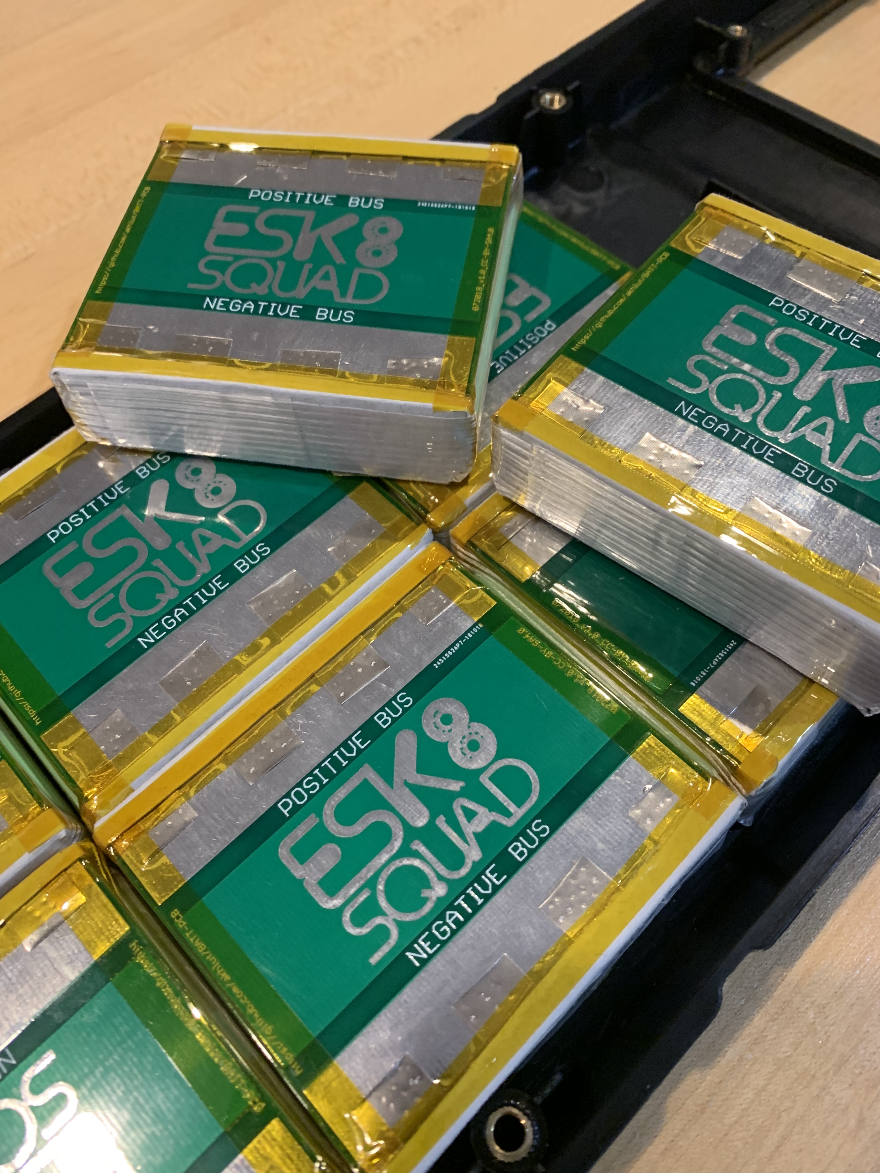

Ok, its time for me to chime in on this excellent thread, we have been working on some big battery packs and have some excellent results.
The Falcon evo, 12s6p sanyo 20700c 30a cells in a eboosted enclosure
on a D124 12s bms set up for quad, built to pump out amps.
