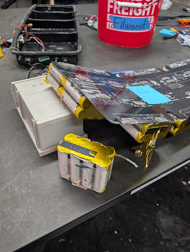

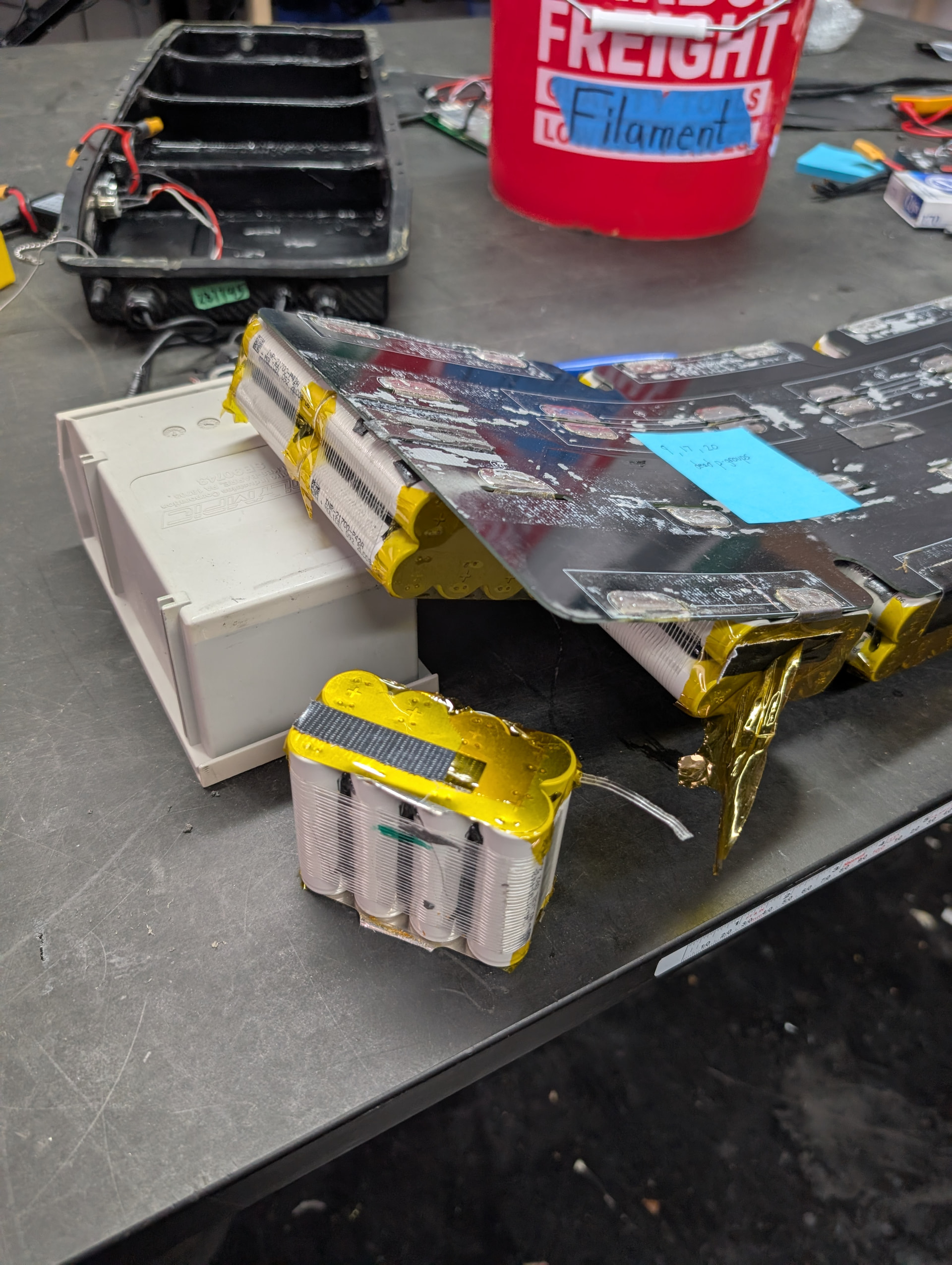

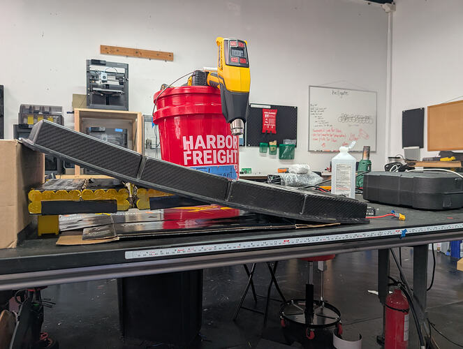

Has anybody ever forgone the battery heat shrink wrap, and wrapped their battery pack with a 0.5mm or thicker silicone sheet?
I received some 1mm thick transparent silicone sheeting today. I going to use the silicone sheet for padding, instead of neoprene above and below, mainly for increased thermal transfer to enclosure bottom and walls, but then thought why not just wrap the battery like a present with the silicone rubber sheeting, sealed with a silicone adhesive?
is not silicone used as thermal insulator?
In my limited practical experience with it, i’ve found silicone to be reasonably good at conducting heat… way better than i expected it to be anyway
Silicone can be the best non electrically conductive thermal transfer material.
How’d you cut the tabs? I used an angle grinder :rofl:
I…also used an angle grinder :grin:
Gonna have an assistant do the rest once I teach him
More as a thermally-resistant material than as a dedicated insulating material.
But as @glyphiks and @hummieee alluded to, it’s a heck of lot better at conducting heat than air. :slightly_smiling_face:
