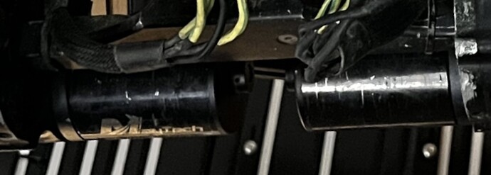

I see Maytech 6396
I have a set, so if yours happen to be 210kv too you seem the right person to ask how many amps do you think they are good for?
I know they can do more than the 80A it says on the website at least the high kv variety.
I ran em at 12s 90A
Thank you, 12S here too.
I am hoping to reach a good bit more. While Reachers are obviously more powerful than Maytechs I have some ideas for cooling and if I scaled a 6385 205kv to a 6396 210kv (I measured stator size not outer size ofc) it would do 150.4A for 10 seconds according to Reacher’s rating.
I have more time than money so I can drill ventilation holes, remove the big old bearing and lathe shallow fins.
Late edit: I’m light and I know 90A for long is tough, I was more thinking of peak current if I wanted to try some 0-20 times.

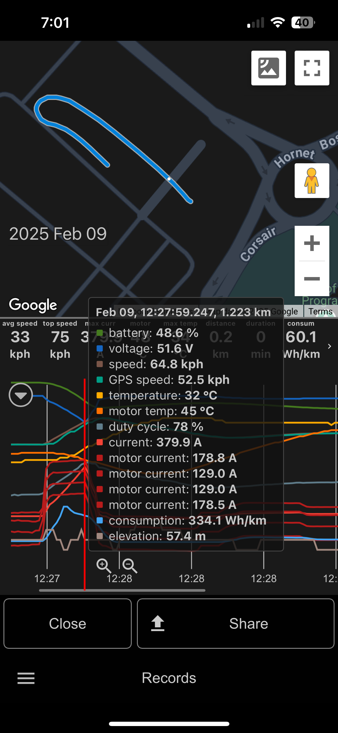

Some impromptu drag racing at i2s tonight had me set a new power record. First time hitting the endstop on my remote for any appreciable amount of time lol.
49.9V * 353A = 17.6kW babbyyyyy
The motor currents are basically a step function up to their 160/130A limits. :rofl:
Can probably push my setup to do way more then that, but TBD idk if I feel the need for more power :rofl:

Looking at the Megan data I can back-calculate my times.
timestamp/calc notes
Start @ 42:16.135
10mph @ 16.968
20mph @ 17.566
30mph @ 18.169
40mph @ 18.970
When writing down these times, I assumed worst-case and used the time of the first data point higher then the speed. So if anything, my actual times were probably less then this.
Note: I started on a hill, hence the non-zero current at start
It was for fun, so we were doing it uphill… about 1~2m of elevation gain (according to GPS). Odometer says about 24 meters for the 0-40 run. So roughly 4~5% uphill grade.
~4% uphill slope.
0-10mph: 0.833s
0-20mph: 1.431s
0-30mph: 2.034s
0-40mph: 2.835s
It’s only ~5hz so it’s accuracy is limited, so take these times with a grain of salt. Even so… LFG!

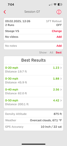

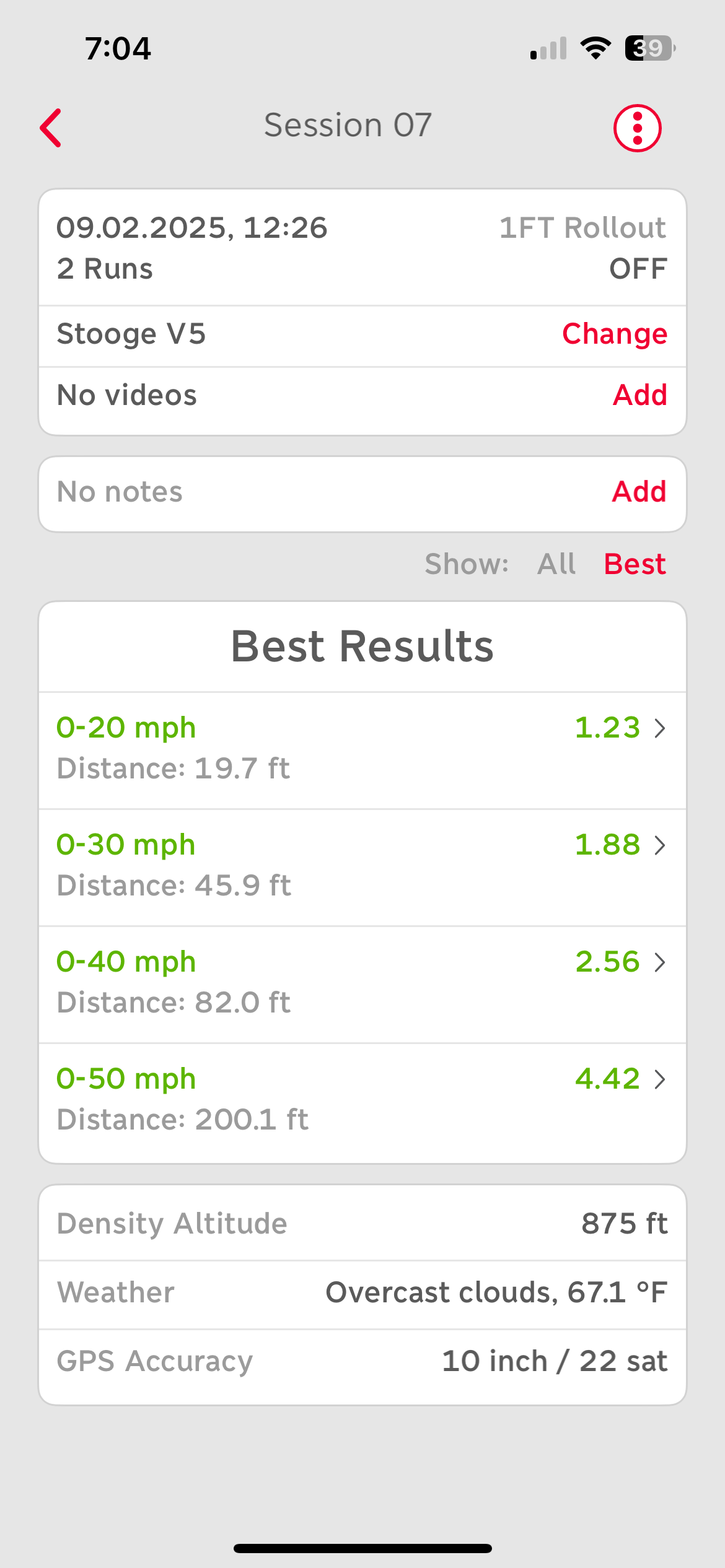

I arrived late to track day today, just in time for us to get kicked out.
So we moved to another location and spent the whole time doing drag runs
A full battery of runs later,
Also, not that anyone is tracking this, but also set a time for 0-50mph
Also also, hit a new PB for power at some point
19.6kW :checkered_flag:
Megan logs
