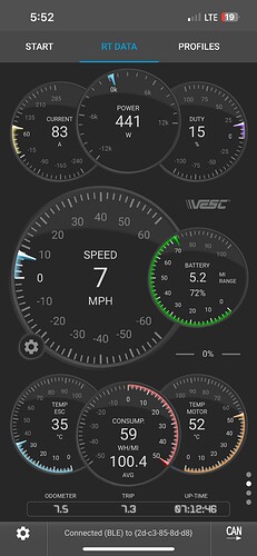

Here’s one of the screenshots of vesc showing the mid-90Wh/mi efficiency

Here's a bonus screenshot of me breaking the silly 100Wh/mi barrier, taken after coming off the track for qualifying(and after my motors cooled a bit).

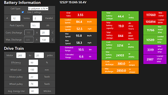

esk8 news calc for either pinion size, for your convenience.
