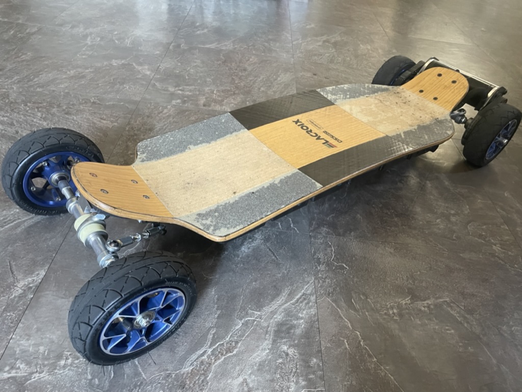

After going to esk8con and seeing Jack and Estelita’s apex bro race boards with SRB 3-links, I’m exploring the idea for my nazare, as the apex airs don’t really supply the turn I’m after. Not knocking airs, I’m doing something they aren’t meant for.
Let’s post pics and what not of different MTB decks with SRB 3-links. I’m pretty set on using SRB trucks, so let’s keep this thread focused on solving the challenges that arise when using the SRB 3-links on angled decks. If you bring drama in here I’ll flag the shit out of you. :kissing_heart:

Yes, everybody knows I notched my Deck so that I could prevent wheel bite and not have to extend the wheelbase making the deck longer.
The front truck is orientated normal, and the rear truck is reversed 180° so it goes on the board exactly like the front truck does with the nose pointing to the front of the board. I then de-angle a lot out of the rear truck so that there is almost no steer from the rear for me personally

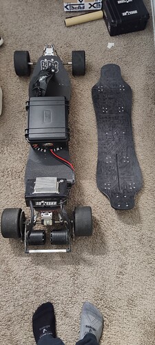

Here’s a couple photos from my deck swap to the new deck along with me on the new deck.
Jack, that is all fantastic info - thank you :pray:
Of course. Happy to share all info! I don’t like hiding secrets about what I currently ride, only what I have planned! If you have any more please feel free to ask I just might not see right away. Much more active on my Instagram @HAIRYMANJACK if you want to reach me directly and quickly :))
