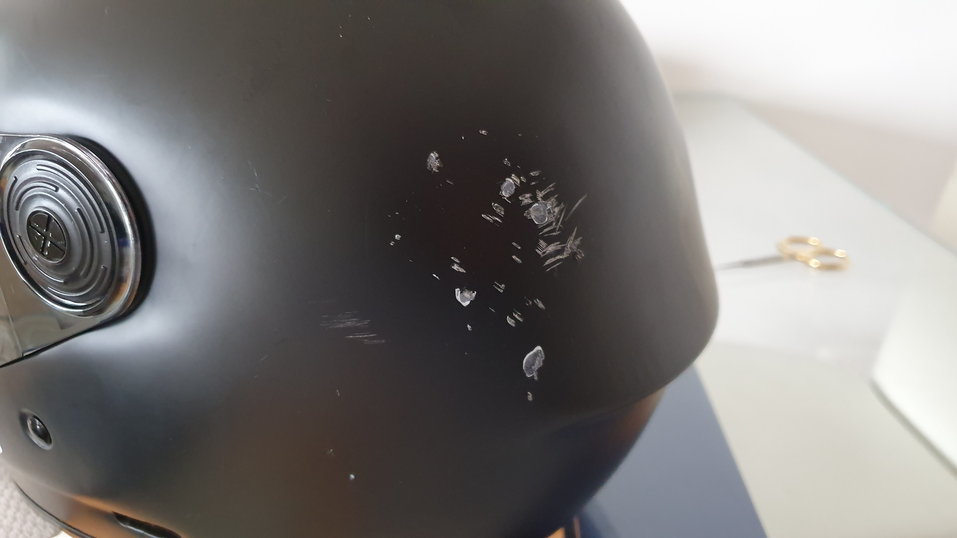

So I had a bad fall today on my way back from the grocery store, I got away with just a few road rashes on my knee, elbow and hip, no broken bones fortunately, but a really hard knock on the side of my TSG Pass so my head is healthy as a baby. I wonder is it still wearable.

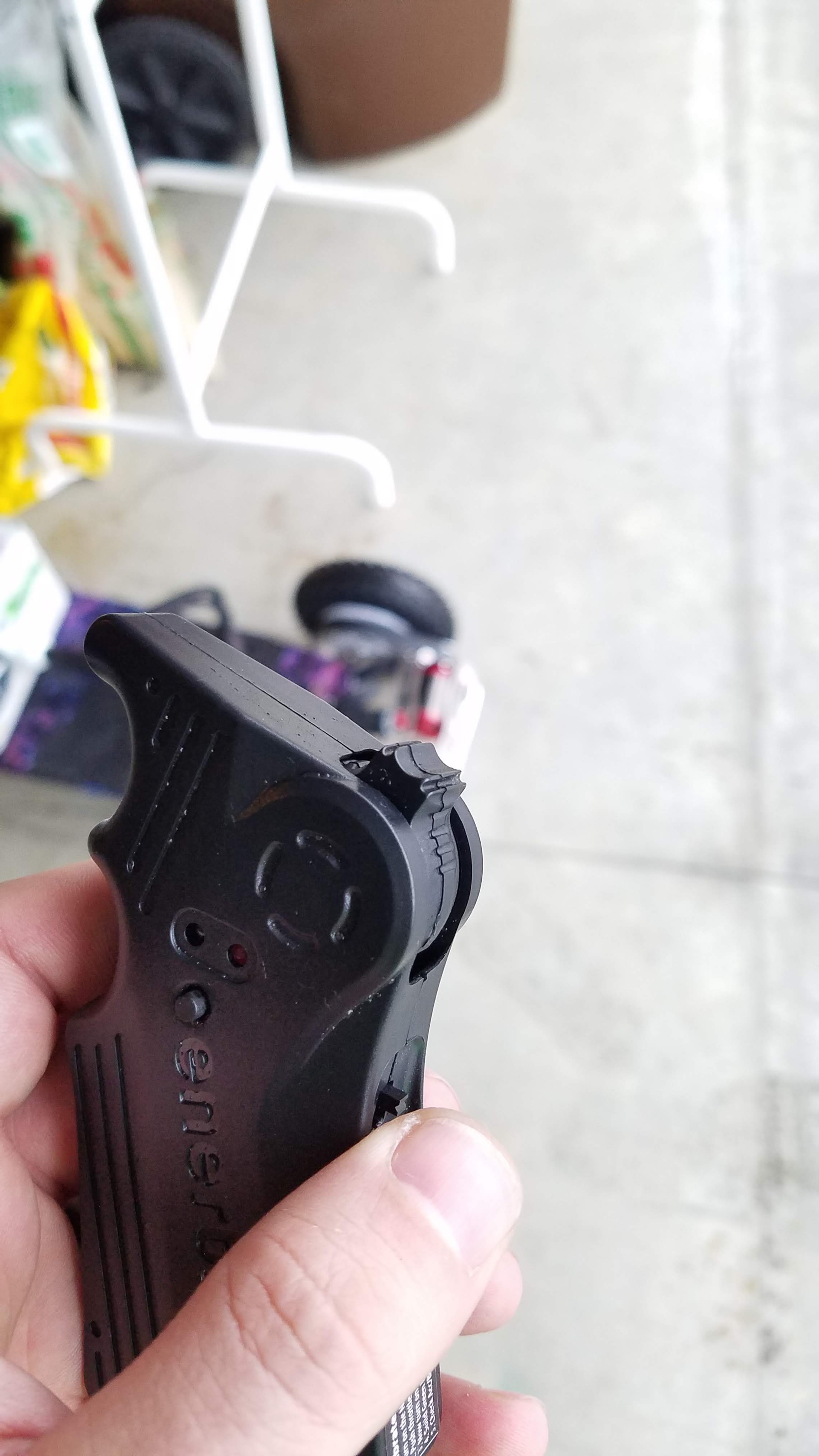

I found the Enertion Nano X was acting up disconnecting just after it connected, connection was not very reliable, but I rode it anyways, my fault.
It seems on my way back the connection was lost for a second and came back right away, this caused the calibration to be lost and a minimum pull of the throttle caused it to full brake.
Since today I officially hate this kind of autoreseting systems which cause this really dangerous situation, I think there is one more remote that works like this not sure if it’s the Benchwheel or Maytech, they should all be forbidden from the esk8 market.

No remote should cause reset in calibration when signal is lost. This is crazy, even if the connection is rock solid interference could cause disconnection, but it should not reset calibration because a minimum move of the throttle will make it go full throttle or full brake
Not the benchwheel remote. I have 2 and love them
Its the 2.4 nano v2. It has the same internals as the nano x. Mine is in a printed nano w case. As far as I know the calibration only occurs when the remote itself is turned on or off, or loses power, not loss of connection to the receiver. I calibrate mine before I turn the board on.

Glad you’re ok. A great reminder to wear a helmet EVERY TIME you get on a board. Even for a store run a block away.

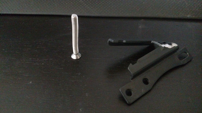

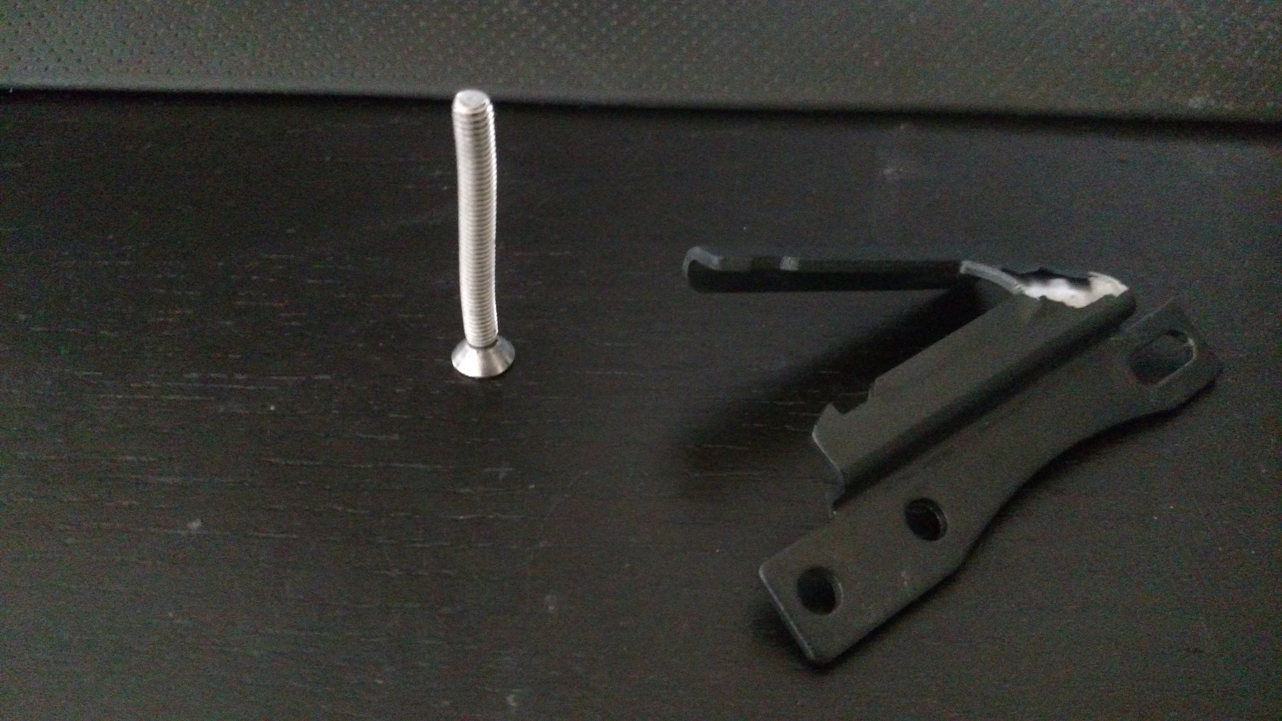

First time using my brand new nano-x. Worst remote ever.
What about physical design failures?
Mechanically stuck in full throttle :cry:

I’m really glad I had the helmet on, I even use it on grocery shopping around the neighborhood. This kind of fall with head injuries when you do not wear helmets is the one that fucks your life forever, instead I’m having a nice Sunday with my family.
