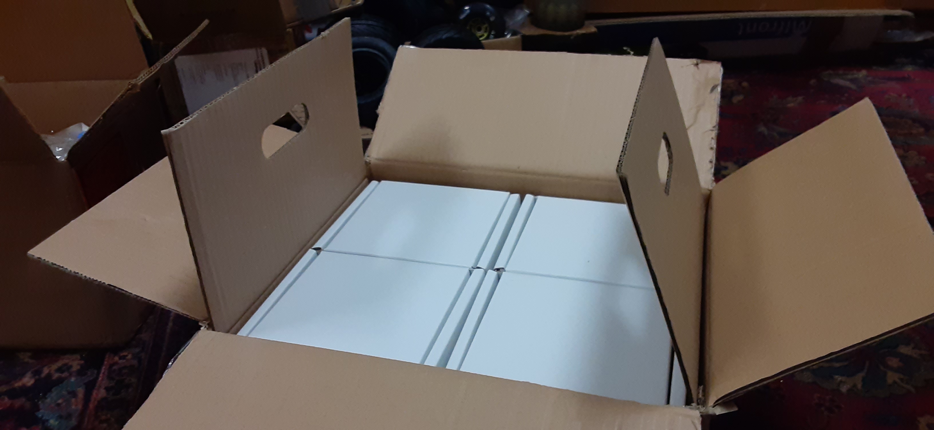

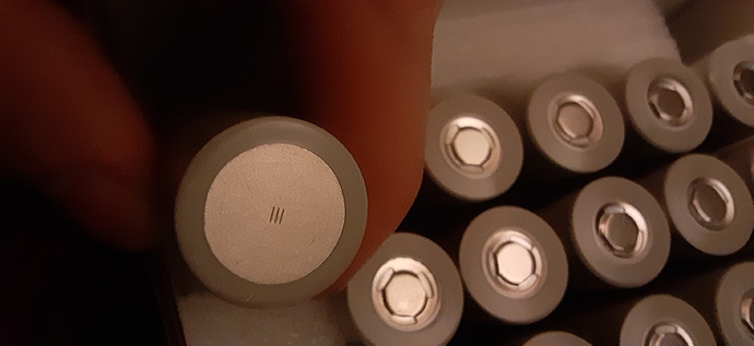

Got mine in from BB finally. Shipping took forever and they did damn signature confirm which really pissed me off tbh (messing up my beauty sleep, and fedex won’t schedule beyond “by 9pm on day X”), but they were well packed, and the cell holders are a nice extra if nothing else than ease of handling and bulk parallel charging.

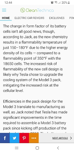

I was reading that model 3 cells have a lower flash point than other well know cells due to chemistry. Also the need for all that heatsink glue and active ac cooling. Should my new build allow for airspace between cells…a fan…passive air cooling …thermal heat sink silicon intead of clear aquarium stuff??? Or just do it the same old way and seal it all up b/c I dont know how to put heat sinks on parallel packs

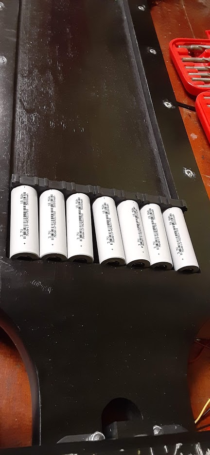

6 wide fits quite well

So 150-180 degrees vs. 350 degrees doesn’t bother you atleast alittle
