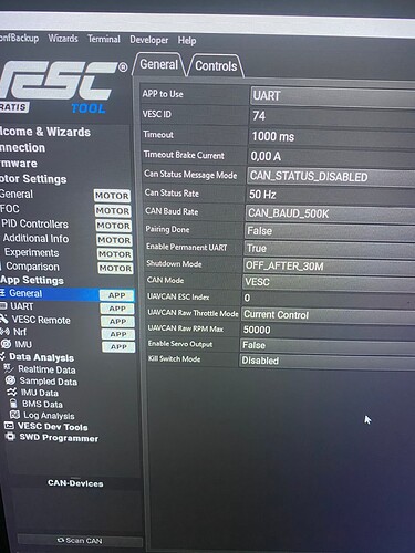

I’ve read other discussions where other skaters said to update on Vesc took the configuration of the control from “ppm & uart” to “uart”, I’ve done it…but it doesn’t seem to be working, and at this point, I have absolutely no clue what to do!

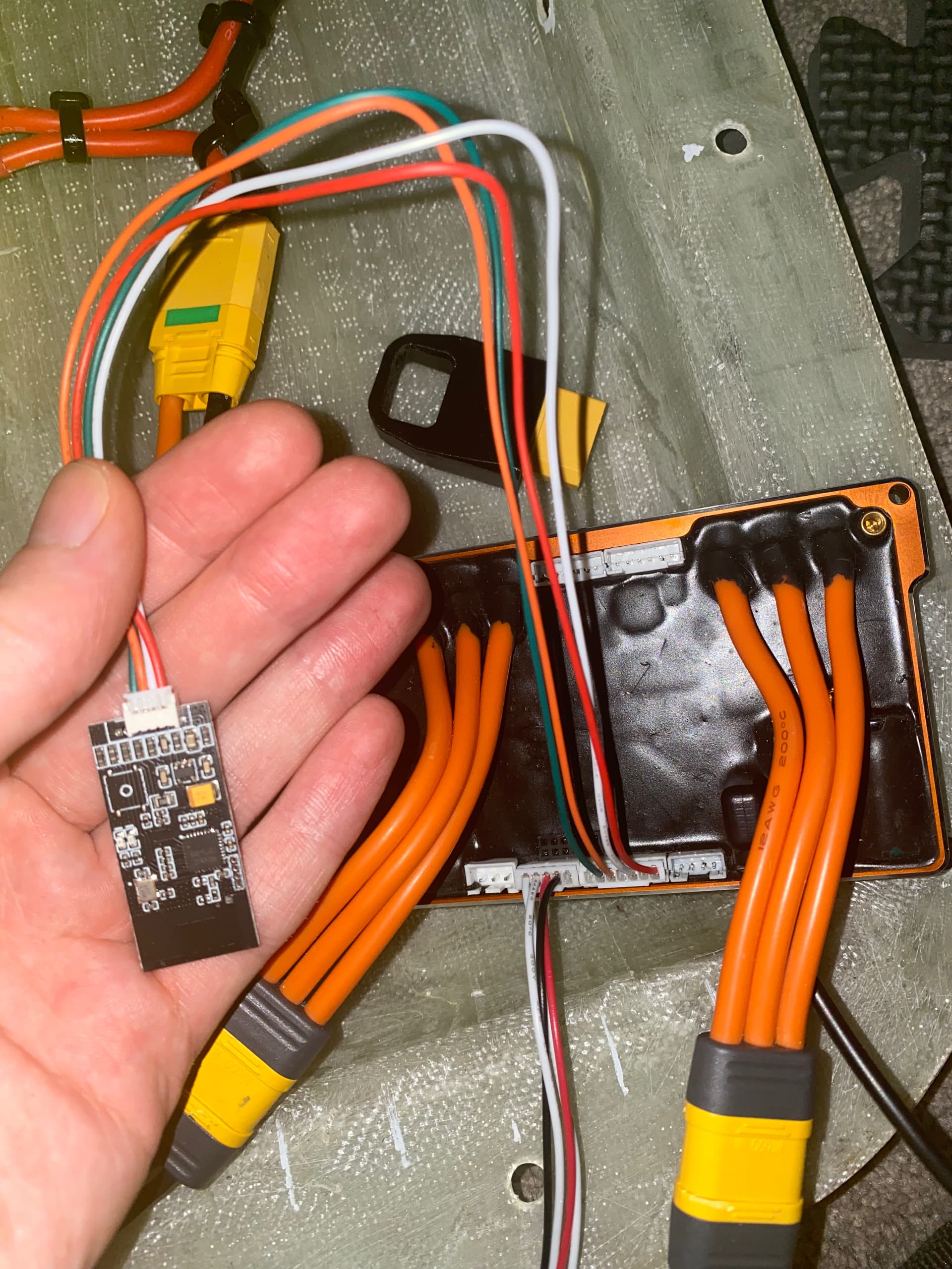

Is the radio receiver connected via UART or PWM?
Confused. You mean via VESC Tool? Then, yes I’m settings I’ve chosen UART, not PMM & UART.
If you’re talking about something else…what exactly do you mean ? :sweat_smile:
Take a photo of the wires going from the radio receiver to the ESC and put it here

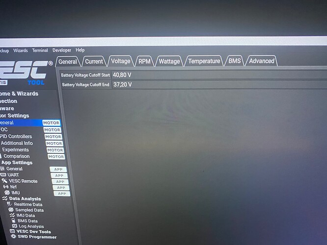

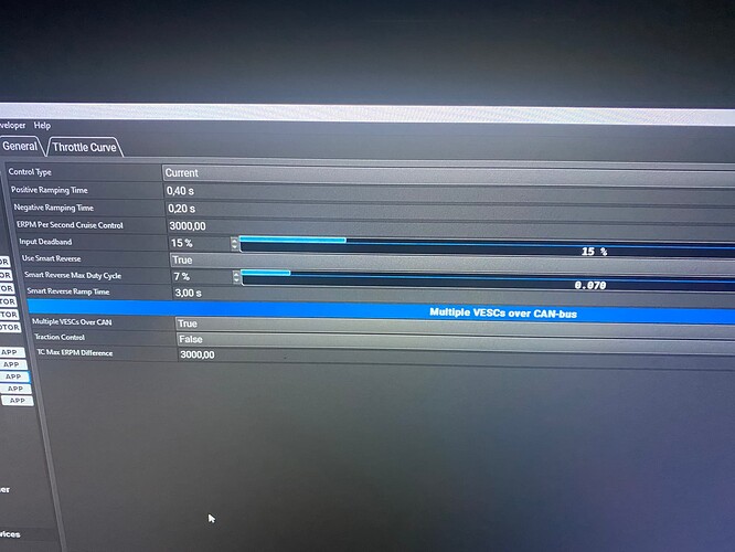

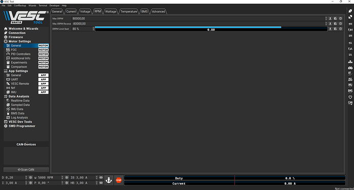

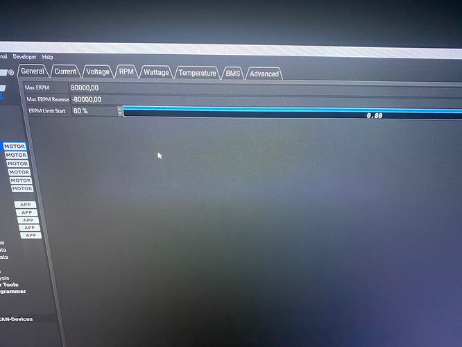

By the way, here are the screenshots of my setup configuration, maybe the problem lies there and I just can’t see it
Need whole screenshots. The entire screen. The things I’m looking for are cut off the sides.
Your computer should have a way to do that without taking an actual photograph of it.
Hah,you’re right,I’m guilty :sweat_smile:
Alright, gimme a minute
