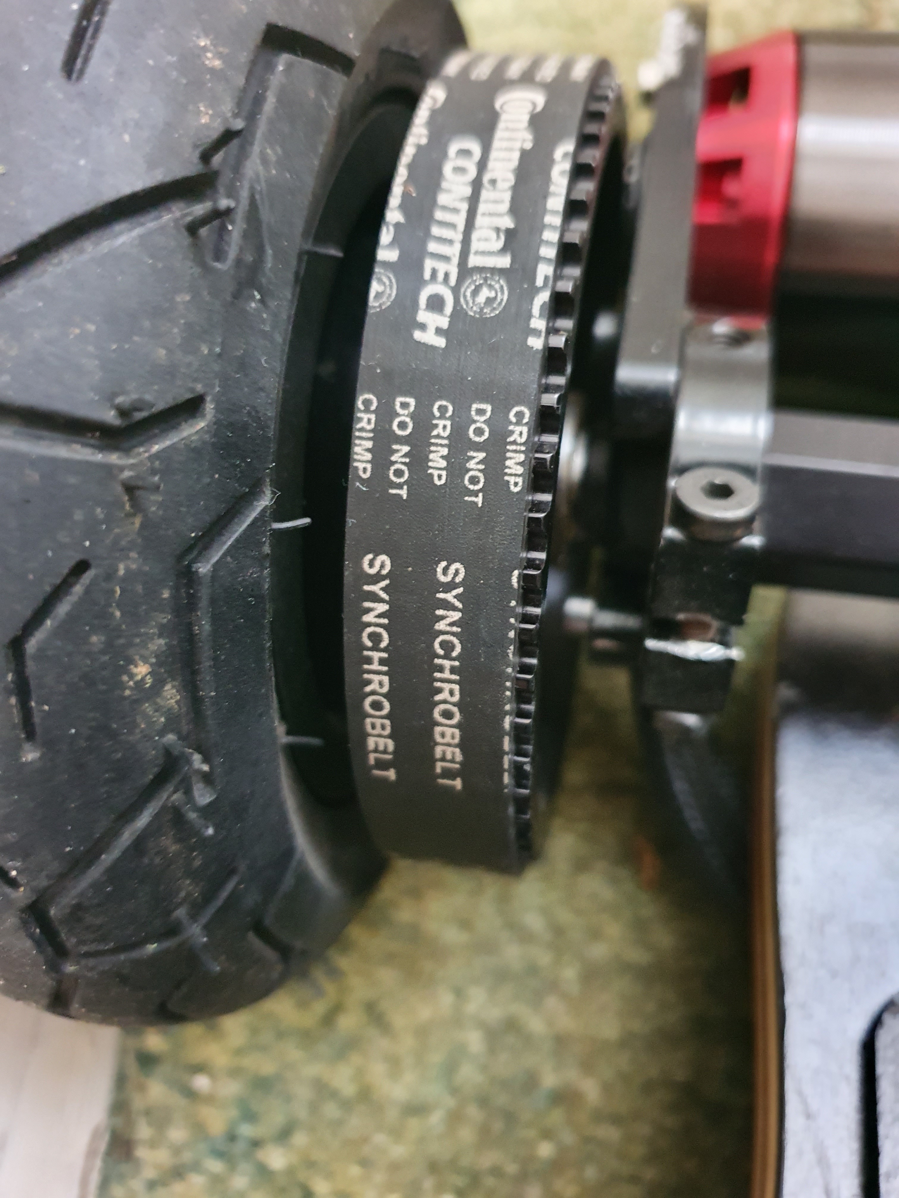

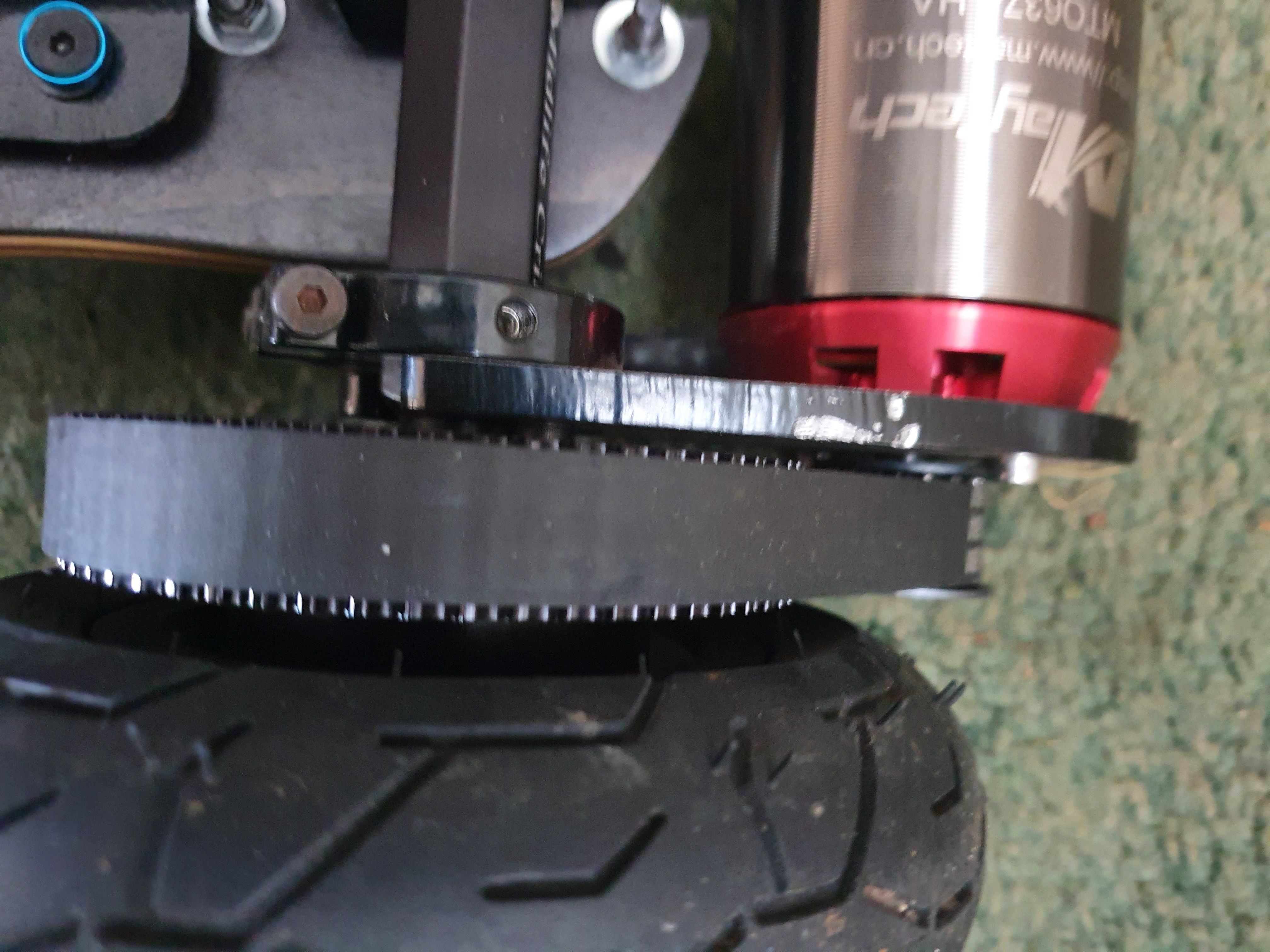

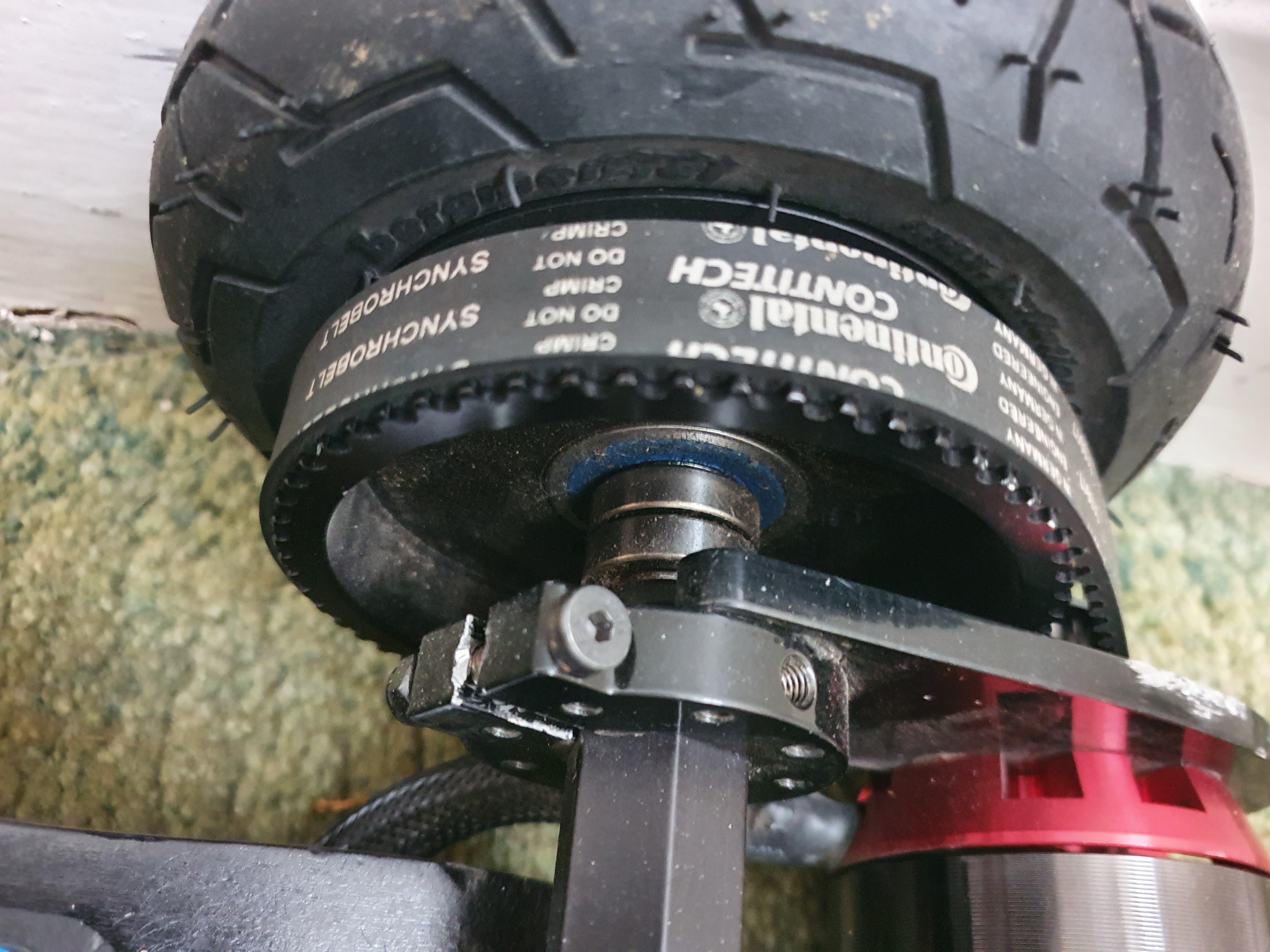

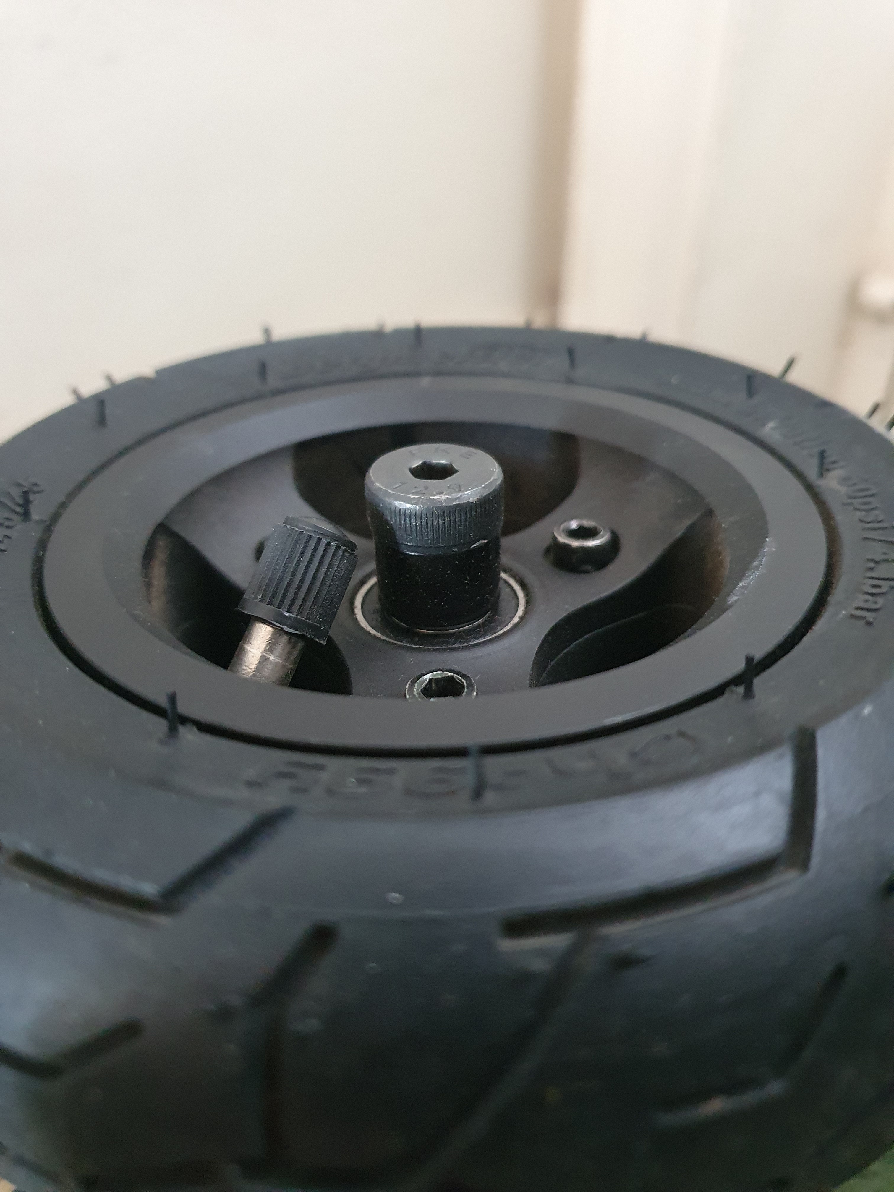

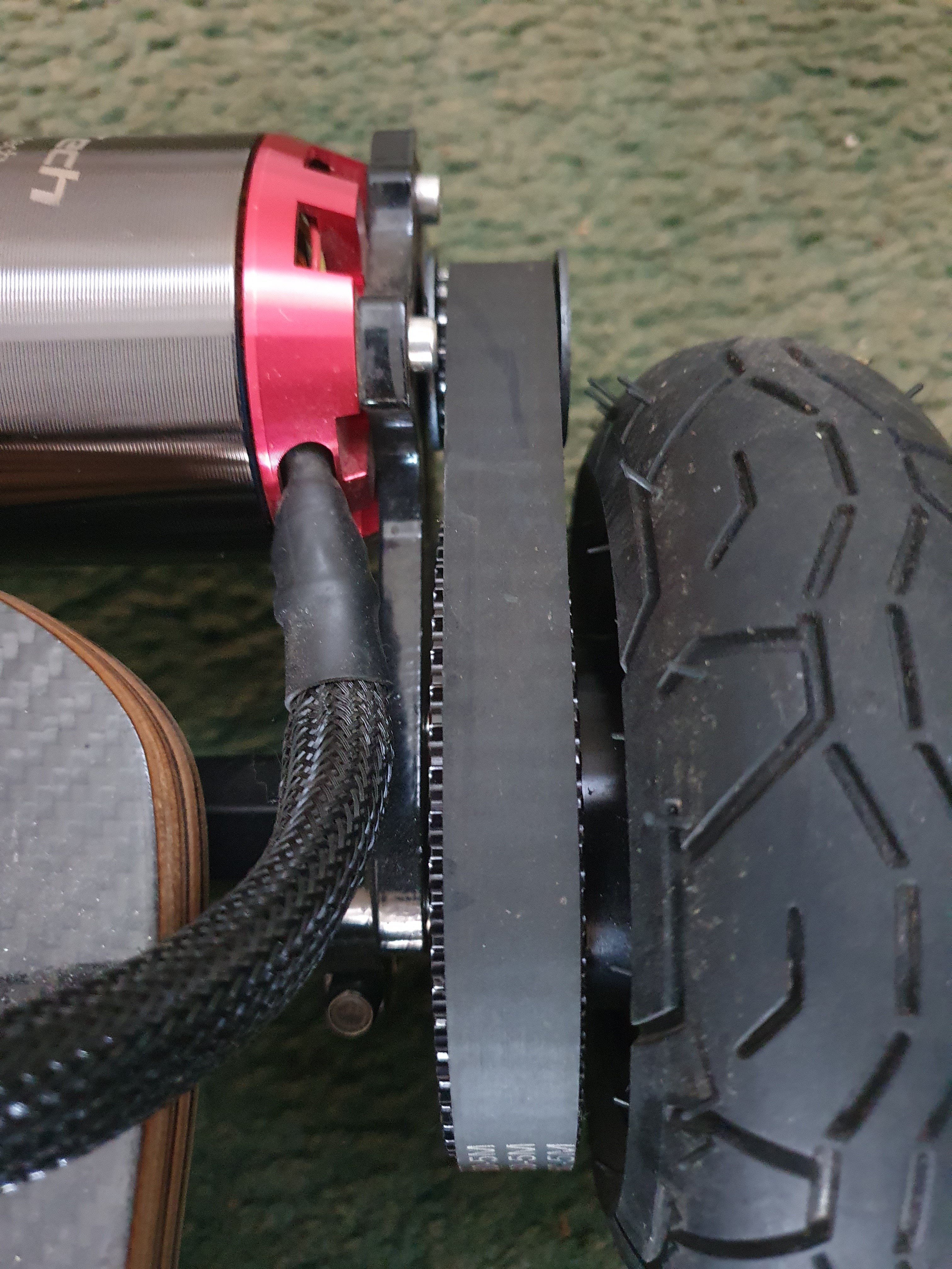

  • Deck: hummie
  • Battery: 12S4P 30Q Charge only
  • Enclosure: Tiller ( just got @BigBen enclosure)
  • Motors: 2x 6374 maytechs ( 6880 soon)
  • Pulley Ratio: 16-60
  • ESC: Dual Focbox’s
  • Mounts: psychotiller 88 quick mounts
  • Trucks: surfrodz 200mm rkp
  • Wheels: Haggy 145mm pneumatic
  • Remote: mini
  • Top Speed: haven’t tested with new wheels
  • Range: idk? Im always home before 50% battery
Don’t have much for pictures. Parts keep changing too lol.
Pulling it apart arm for a few things.
From before pneumatic went on. Abecs 107mm
Is this the same deck? Cause it looks totally different builds.
Lol yep. I just keep changing wheels/motors/ and axle lengths.

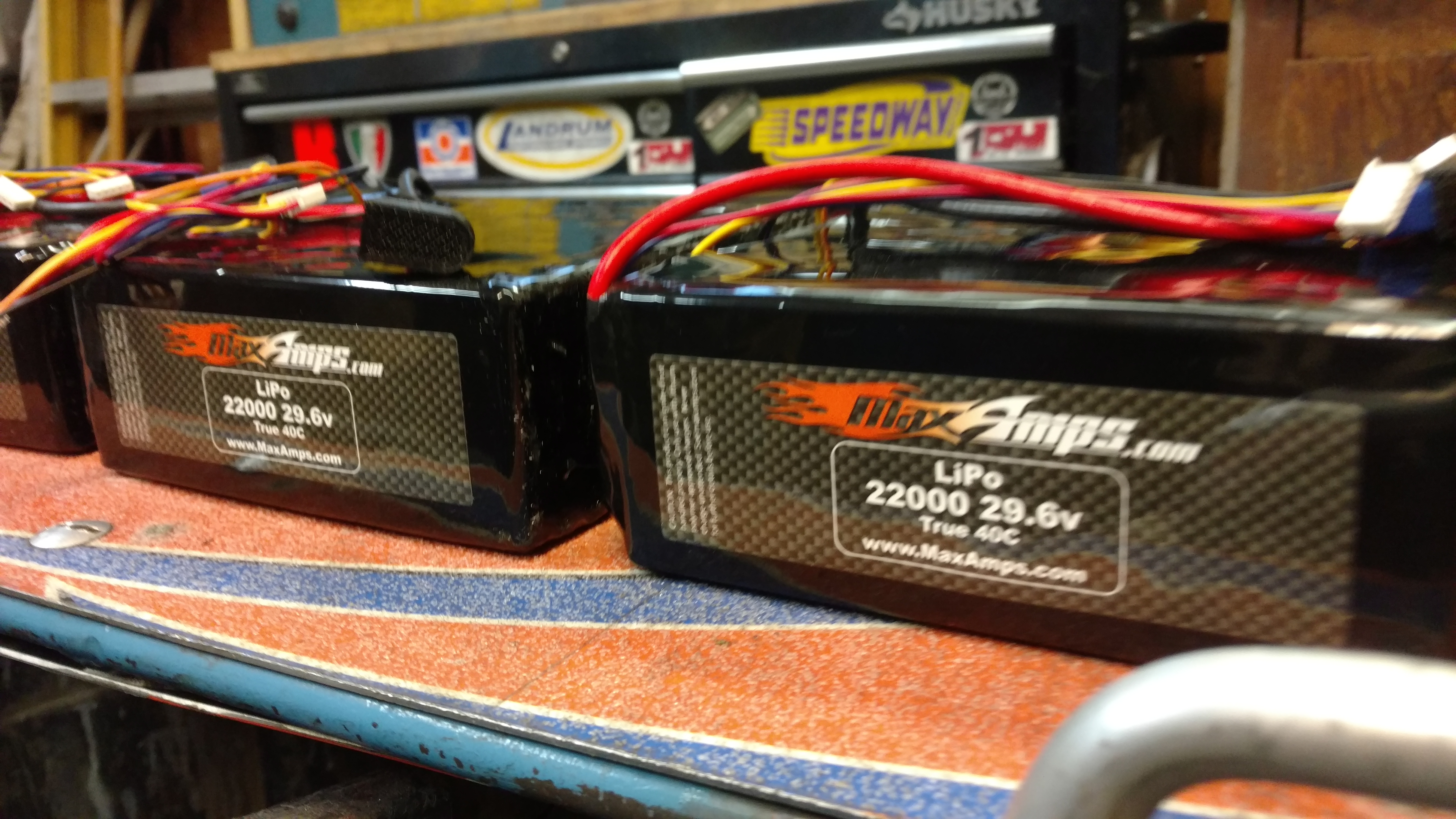

You have 40Ah of battery on that?
And Room for 1 more brick in the tank
Wow, I also forgot how much space your boards have…

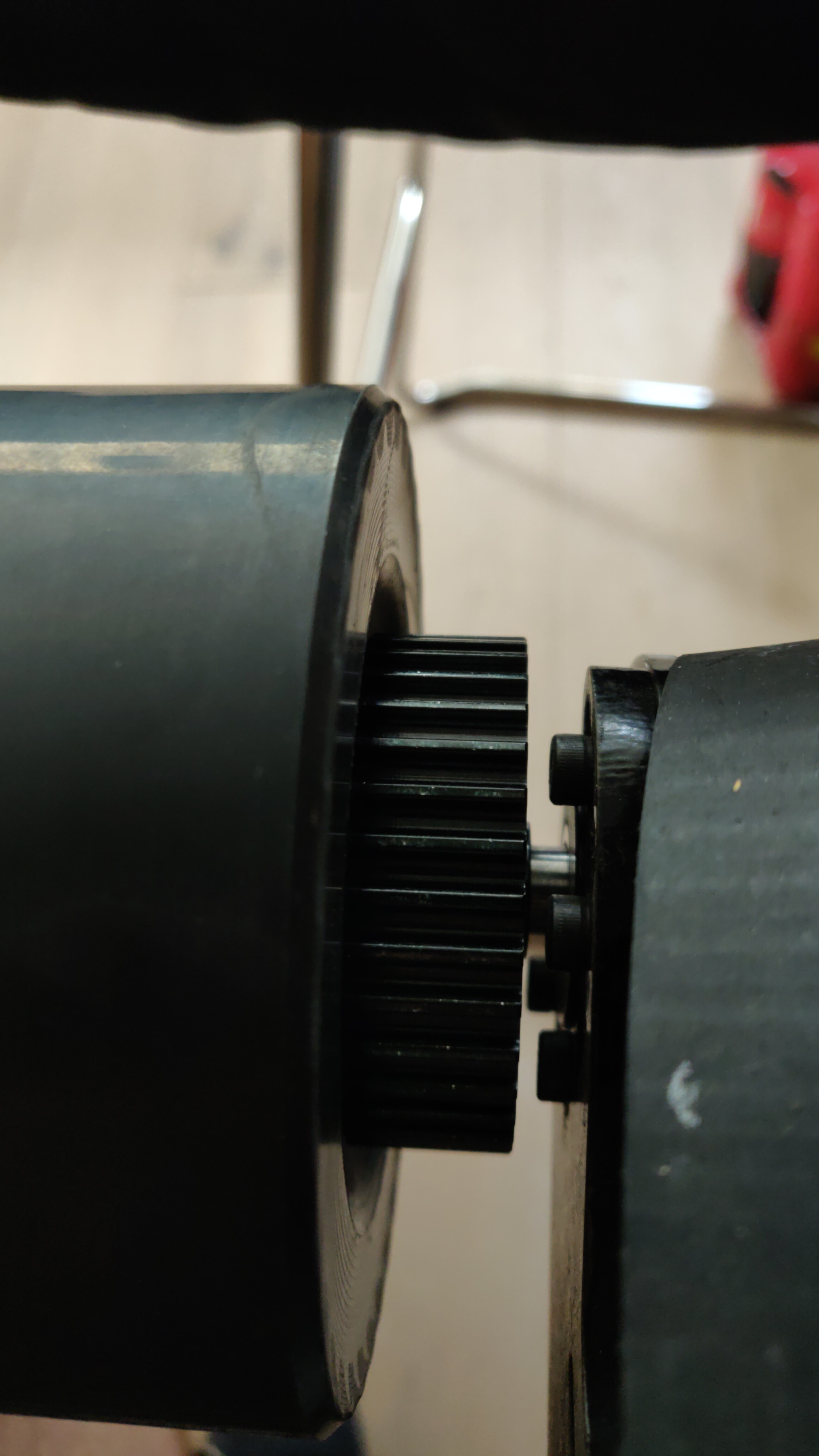

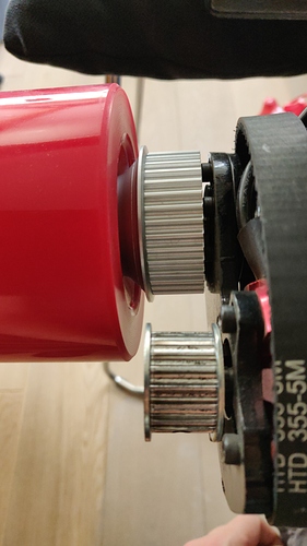

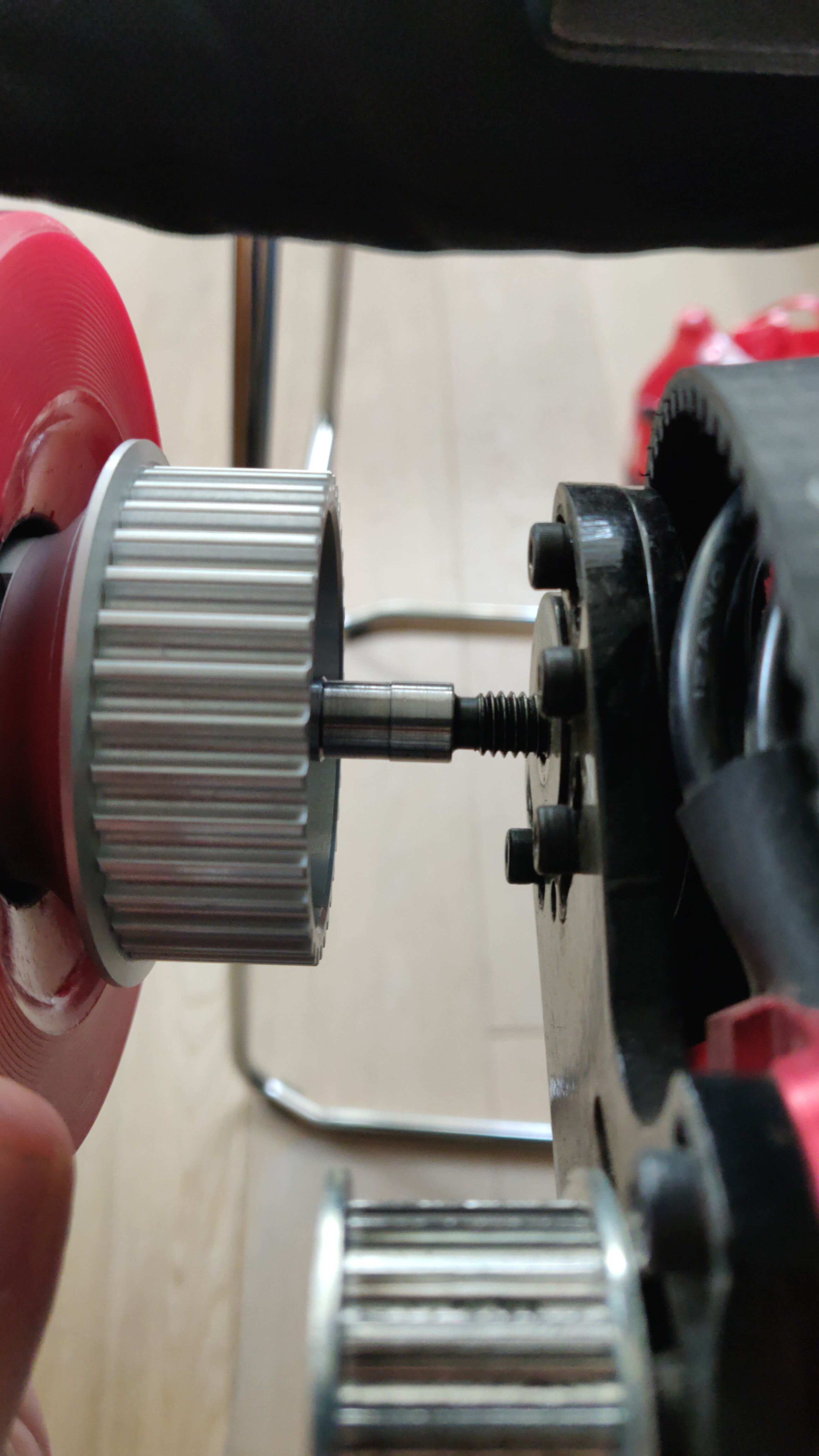

@Brenternet i see you managed to fit 107s on psycho mounts and SR trucks. Do you have pictures or tips to fit these?
(100mm axles but there is no room left to actually screw them in. These are just seated to the thread in the pictures, not 1 full turn
Red wheels are with press fit. Black is with screw in pulleys)
That red push fit pulley is way too sticky out but I cant see an issue with the other one. I really didnt have trouble at all mounting and my axles are 90mm. I even had to spacer out the outside of the bolt because I bottomed out on thread.
Give us some more pics of the whole drivetrain?
Issue is with 107 abecs, bergs fit fine (is what i have now).
I can post pics in 30min
