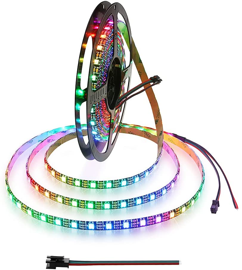

Btw which flavour of LED are you using? I ran with the SK6812 for a project before over the more standard WS2812 because of the 5V and white channel instead of just RGB, I quite like them
Just got these in
I’m going to get them going on the bench before I install.
Oh great I must have gotten my model numbers mixed up, I thought the 2812 was 12V but that’s the 2811
