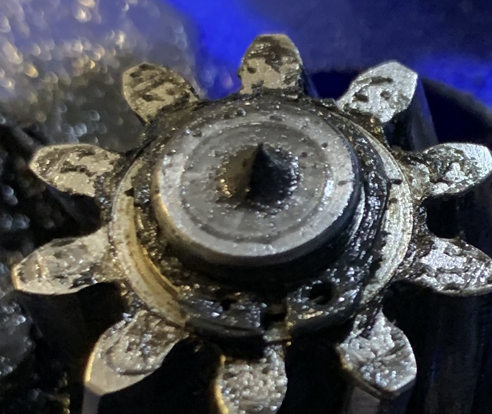

So I’ve got something making weird noises inside the motor. How do I remove this gear and get in to check things out? I need to see inside the motors
There should be a grub screw holding the pulley to the motor axle, try to remove the grub screw first, and then pull it out. Looking how dirty it is, it might be hard to get it out.
I that a Kaly drive?
I don’t know if Ernesto uses retaining compound but you definitely need to remove the retaining ring and then the grub screw(s) if any.
This is the noise from inside the motor
Where would the retaining ring be? This is my first time taking these apart.
The circlip shown here

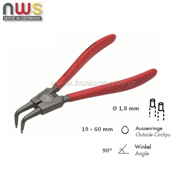

And what tool should I use pliers?
Does it pull out or do I have to unfasten it?
Something like that

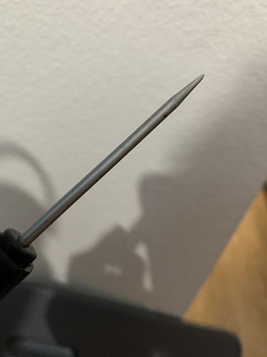

You can use a small flat bladed screwdriver and twist and stop at the widest point. You just need to open it a tiny bit so you can move it out of the groove. Take photos and pay attention of where the spacers and ball races go. Sounds like you might have magnets moving?
Thank you Taz!
Thank you sir! Stay tuned. It does sound like a loose magnet. Good ears!
Looks about time for a little clean in there!

Would this work?
Rick! U can go to a autozone or pep boys and they will let u use there tool to remove the circlip. Don’t mess it up the circlip! That’s definitely a loose motor magnet.

Be careful when removing the circlip if you plan on using it again. Bend it slightly too far and it’ll be permanently out of place
