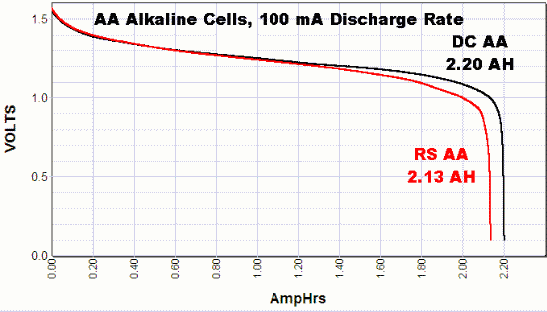

Nope.
(Random google image)
Not quite. Imagine a battery that you’ve used with terrible voltage sag, where anything less then 50% charge in unusable.
Capacitors are even worse.
Powering anything off their output directly is very, very hard because of how varied the voltage output is- whatever you’re powering need to work across the entire range to use the stored energy

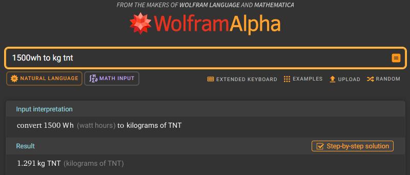

Being shorted in the video is max charge. Energy storage of 0.8kJ, or about 0.22Wh
At least 1000x time less less energy then you need to store for a practical EV.
Wolfram alpha makes my point;
The more I think about it, the less capacitor based PEV’s makes sense😂

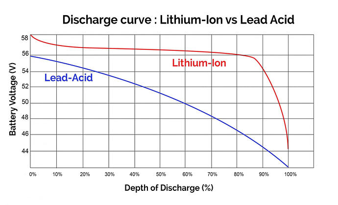

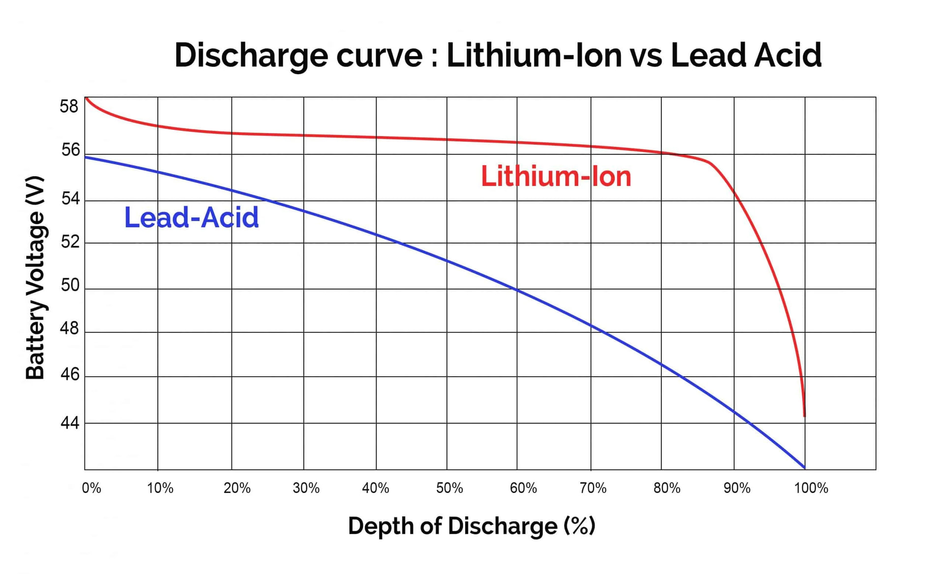

Yes, you are correct, though I did find a comparison of Lead Acid v LiIon that demonstrates what I was getting at.
Granted of course that Lead Acids are shit batteries.

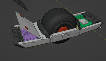

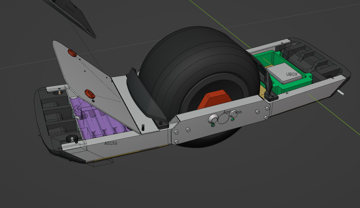

Is it a bad idea?
Original XR had 324 Wh. 20s1p 5Ah is 360wh. And I want to make a second swappable pack.
So it’s like twice the range of original XR. And I want to get the weight <=12kg.
And this is how I’m thinking to implement swapping:
These 22mm hood clips are absolutely dope btw:
