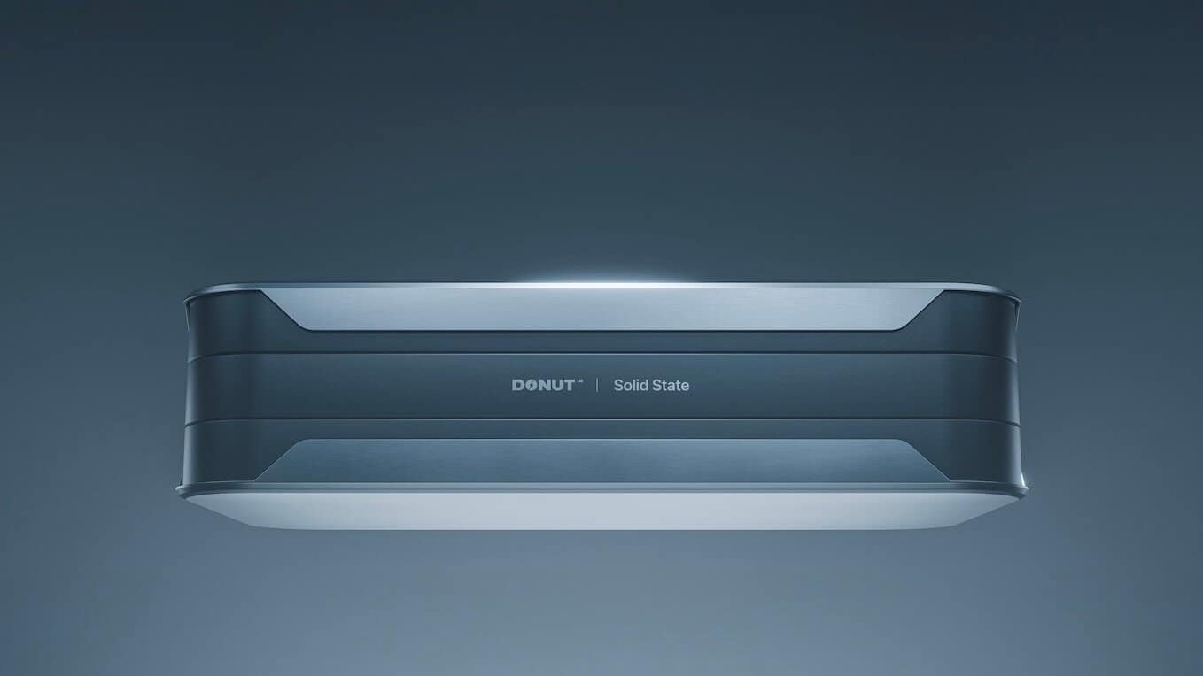

Thnx for the answer Battery Mooch! Even the semi solid state batteries are very impressive, can’t wait for the real thing! Do you know if the donut lab battery is true solid state? It is the talk of the town and they have some wild claims like 100000 cycle life?

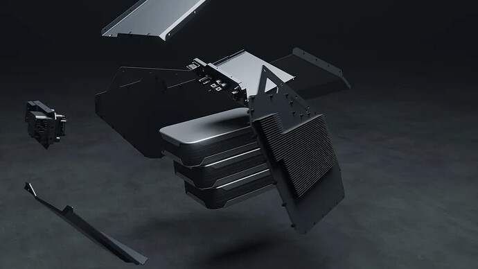

Damn two of these and you have a solid top box pack for a mtnb
Let’s see if they deliver, they said q1 2026
Looks like they will have 3 packs in the motorcycle
It is indeed true solid state…but it’s not a battery, it’s a capacitor. :slightly_smiling_face:
Okay, yea, the popular usage of ā€œbatteryā€ for anything that can store energy means it is considered by many to be a battery. But it’s a cap. And what better way for Donut Lab to hide what those packs actually are? :joy:
I had two more detailed posts about this for my Patreon supporters but check out Ziroth’s video on YouTube…I agree with his analysis that it’s a cap made via Nordic Nano’s (their partner) solid-state printing process.
LOL…just check my email and DM’s…getting swamped with questions about this thing. I’ve made those two Patreon posts public. Here’s the one with my thoughts about what it really is with some links: https://www.patreon.com/posts/it-might-not-be-147688450
From the press, they say ā€œis made entirely from abundant, affordable, and geopolitically safe materialsā€
If my understanding of battery chemistry basics is to be trusted, this basically confirms it? Can’t have a decent battery without rare earths/alkaline metals

The cycle life claim is what screamed cap to me. It would have been corporate suicide to make that spec up so I figured cap. I had no idea though that someone had gone far enough to make solid-state caps with that energy density at a high enough yield to be profitable.
That’s what I’m thinking, if it’s got sufficient capacity then whether it’s a battery or a cap is a distinction without a difference?
I think cap’s discharge voltage being a constant line going down doesn’t work well with a vehicle
Maybe they’ve advanced a lot but their energy density wasn’t close either
Battery stores energy in chemical reactions
Capacitor stores energy with electric charge.
Also notable is capacitors have a linear voltage discharge curve. They dont output a (roughly) consistent voltage like batteries do

Ok, but if I’m really getting 400Wh/kg who cares?
Don’t all batteries that don’t have lithium have a linear discharge curve? I’m thinking Alkalines, Lead Acid, NiMH, etc. That’s just a slightly different energy management algorithm. Plus if they really are caps then you can’t over discharge them so all that BMS noise goes away.
So far as I understand the only thing between supercaps and world domination is capacity?
Great points! Am I remembering correctly that some voltage-regulating electronics were mentioned in the Donut Lab video? Even if not, you’re right, they’ll probably be needed.
