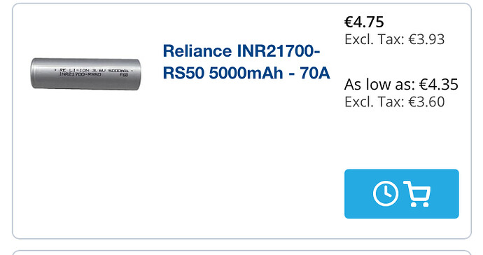

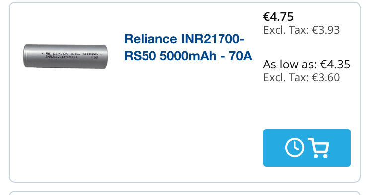

New cells available for pre-order ETA late next month. Are they probably re-wrapped 50PL? @Battery_Mooch want some? I want to send you some other cells too anyway.
Umm…heck yea! Thank you!
DM’ing you.
Pretty sure they’re not rewraps as Reliance is a pretty big manufacturer and everyone is getting one the high power 5Ah cell bandwagon lately. We’ll find out though!
Definitely not re-warpped.
Reliance is a new upcoming High Power Cell Manufacturer.
As far as I can say they perform exceptionally well.
I guess we will hear more from them in the upcoming years.

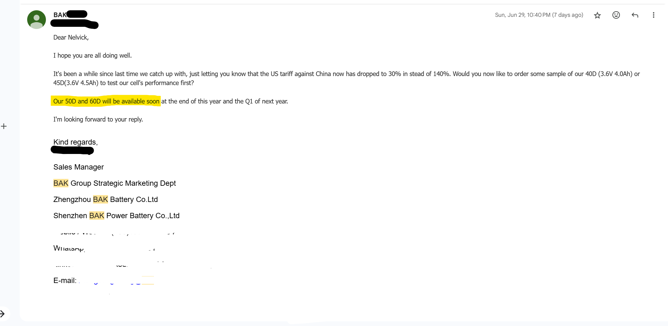

BAK is coming soon with few cells.
