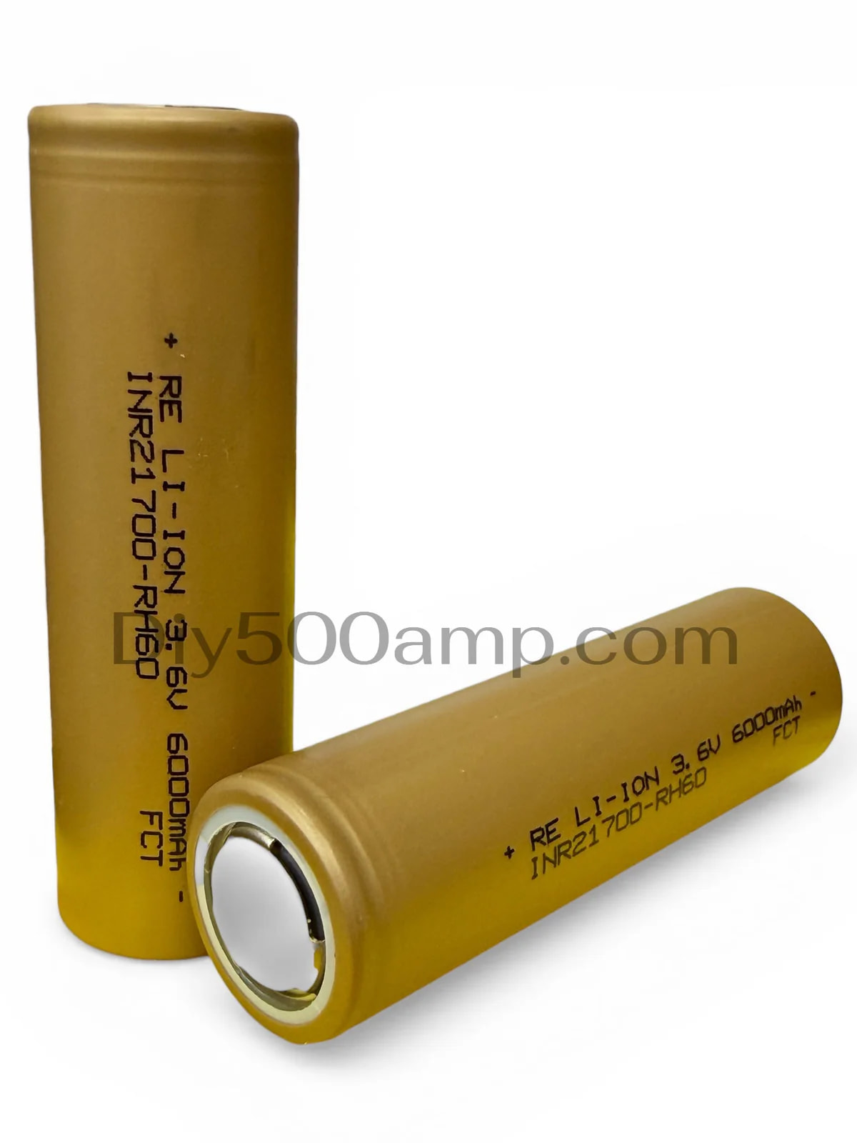

"Tabless cell" the new new In lithium ion Tech
Nelvick has a limited number of an interesting beefy sized 21700 tabless cell, the Reliance RH60.
20 amp max rate to 60C, and 6000mah.
I like the size of the positive tab, and wish all cells had this larger surface area.
The RS60 is said to go into mass production after August this year,

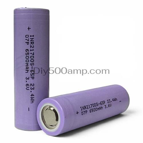

We have been teased with higher capacity higher discharge hybrid cells, and Some of those samples have made in into the hands of the testers we trust.
Seemingly out of nowhere, a new Cell manufacturer has popped up, LinkData.
They have 4 cells, the 50SP, the 55P, the 60P and the 65P.
Other cells of interest are the Tenpower60XG, the Reliance RS60 and RH60, and the BAK 65E
Non CCC preproduction versions of these cells have been tested.
Here is a line graph chart with these cells, along with teh Samsung 50S, the Hybrid cell of yesteryear which is offered in a lot of new prebuilts.
Of the 11 cells in this chart, at 30 amps constant current, down to 3.0 volts
The winner is the LinkData 65P delivering 5067mah.
In last place is the Samsung50s delivering 3009mah and didn’t make it down to 3.0v.

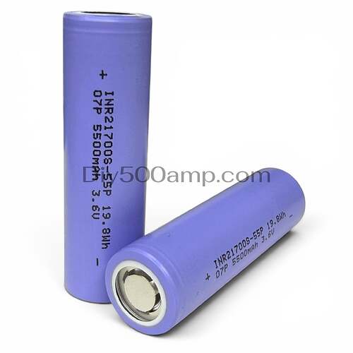

The LinkData 55P is also a very impressive performer.
Compared to the highly respected Reliance RS50, It sags less, stays cooler, and delivers 102mah more, down to 3.0v.
These 6.5ah cells are verrrryyyy interesting!
where do you order LinkData 65P cells?
