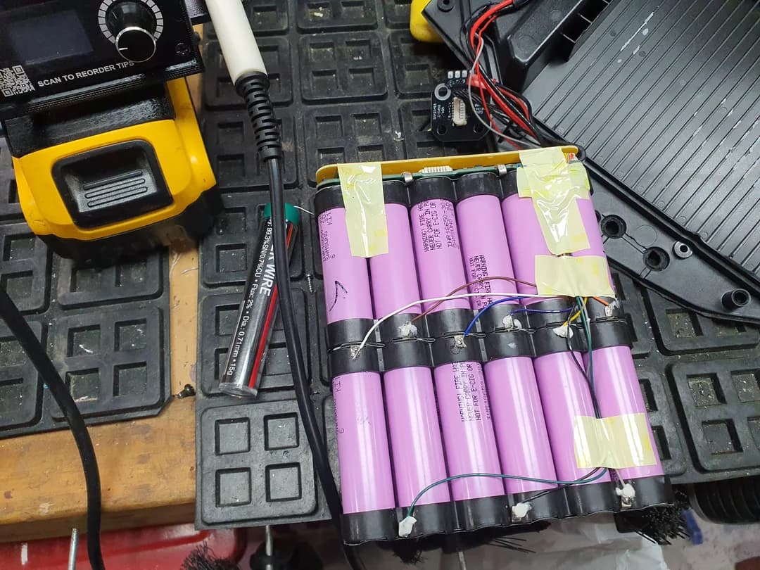

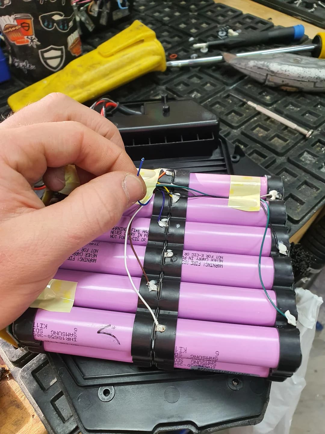

for posterity, from redit thread:
I actually took the pack apart myself and took some measurements, I’m confident I can cram 21700s in there with a bit of modification
