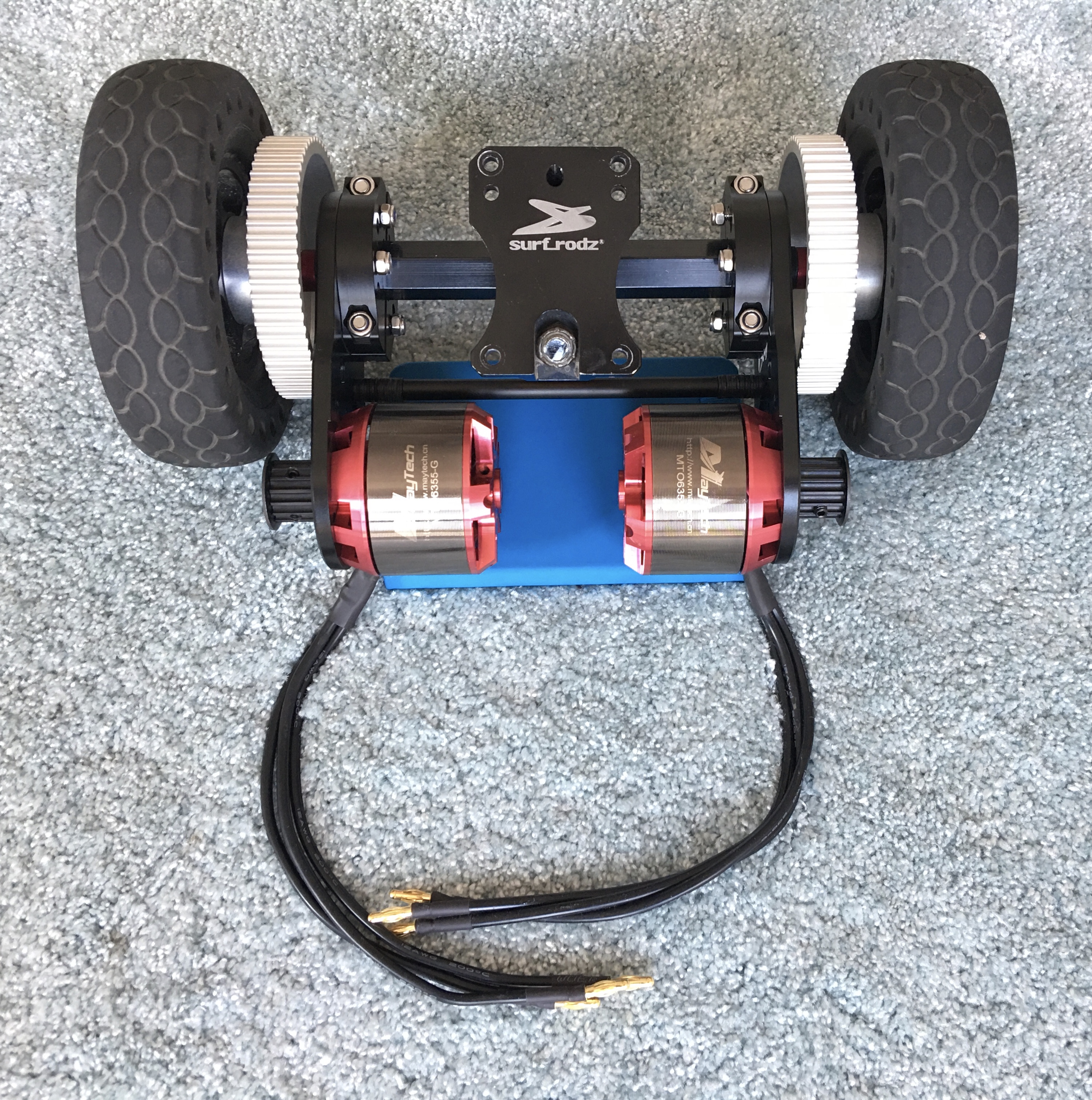

I’m putting together a belt drive on SR TKP and I ran into a small problem. Turns out that I have no choice but to position the motor mounts such that they block access to the grub screw on the hanger which helps to hold the axels / shoulder bolts in place. Having to move the motor mounts anytime I need to unmount a wheel seems extremely annoying. Plus, it’s not even possible with the crossbar installed. I would have to remove it.
Is it safe to just loctite the shoulder bolts and leave out the grub screw?
Yah as long as there’s loctite. Some don’t use the grubs because if you forget they’re in there and try to remove the axle it can mess it up.
I’ve ridden without loctite OR grubscrews and haven’t had any issues. I would still suggest loctite atleast :joy:
Dido as @ReliantChris
Don’t use grubscrews. Just a tiny dab of locktite. Keep the shoulder bolts clean to prevent binding.
Dido as @ReliantChris but still agree loctite is a good idea. Most people don’t use the grub screws though in the esk8 scene. Just try not to take out your shoulder bolts often or ever cause it will butter up your threads horribly and you will have to replace them as well as the coil insert in the hangar which is a bitch and a half!

I’ve actually considered removing the grub screws in my Sr rkp set, it seems the rust from the grub screw getting on the shoulder bolt causes issues, was on mine, sanded the rust off the shoulder bolts once removed and now go in and out like butter, I cleaned the axle hole as best I could too. I would also plug the grub screw hole to prevent water getting in.
Yes you can. I’ve been riding without grubs in mine for a year now. I just loctite the shoulder bolts for peace of mind.
And also plug the hole like @Scepterr said. Don’t want water getting in there and creating rust.
I actually have a chicken and egg problem with that. The wheel is blocking access to the bolt holding the crossbar.
It is, I have done this exact thing on every set of Surf Rodz I own. The grub screws will mar the axles which will in turn shred the helicoil thread inserts.
I just hot glued over my grub screw hole. That way water and debris never gets inside.

People suggesting threadlocker – blue (non permanent) or red (permanent, removable with heat) ?
Blue for sure.
