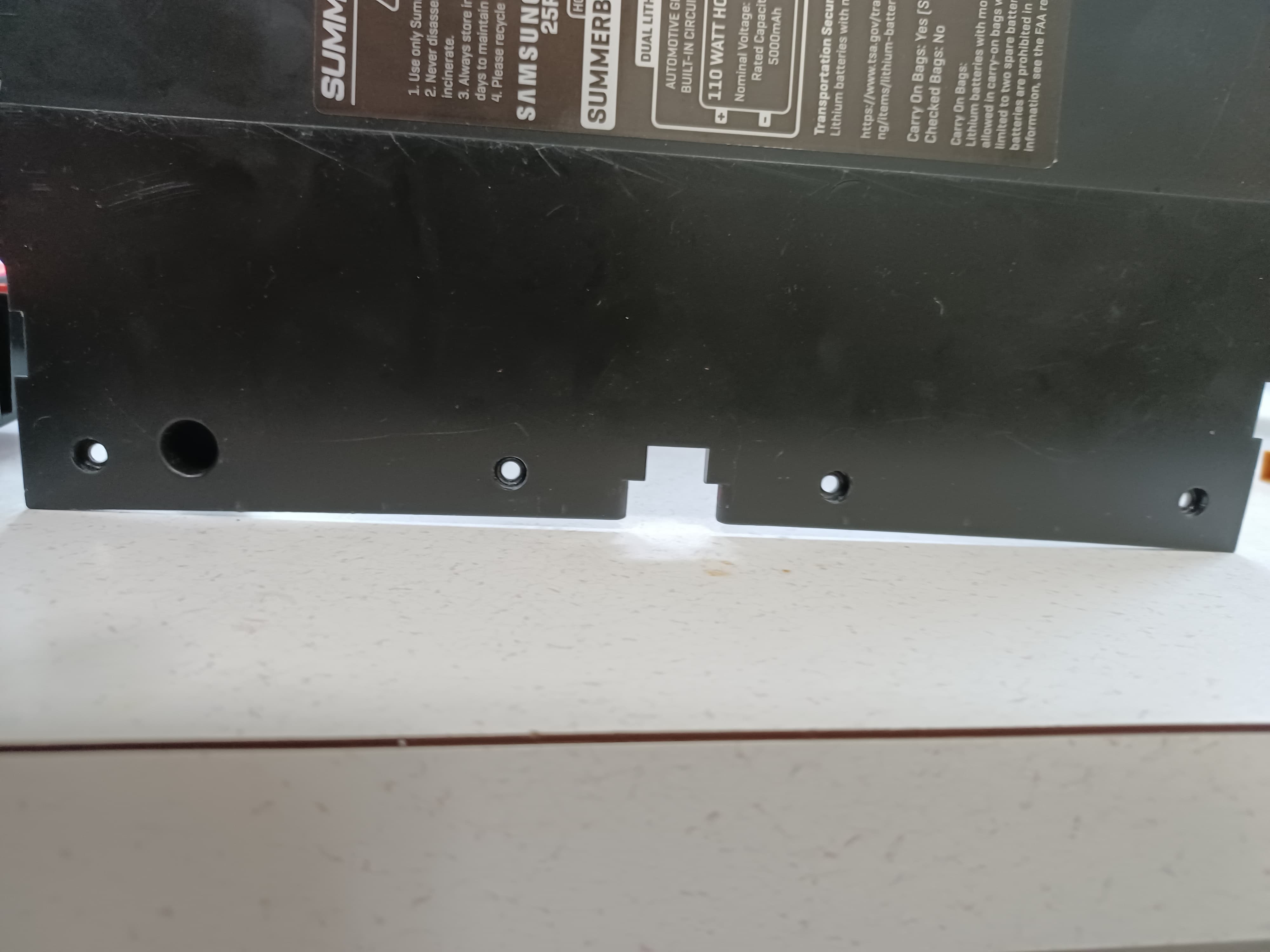

not sure how a whole batch of their battery packs went out with one side drained near 0V but something to do with this slow drain I assume.
Hmm wonder why it is not fitting
its been 5 days??
plenty of room
the holes where the clips attach to look odd here.
auto supports looked annoying so maybe this will be good. Wonder if a PLA clip would fail or what.
