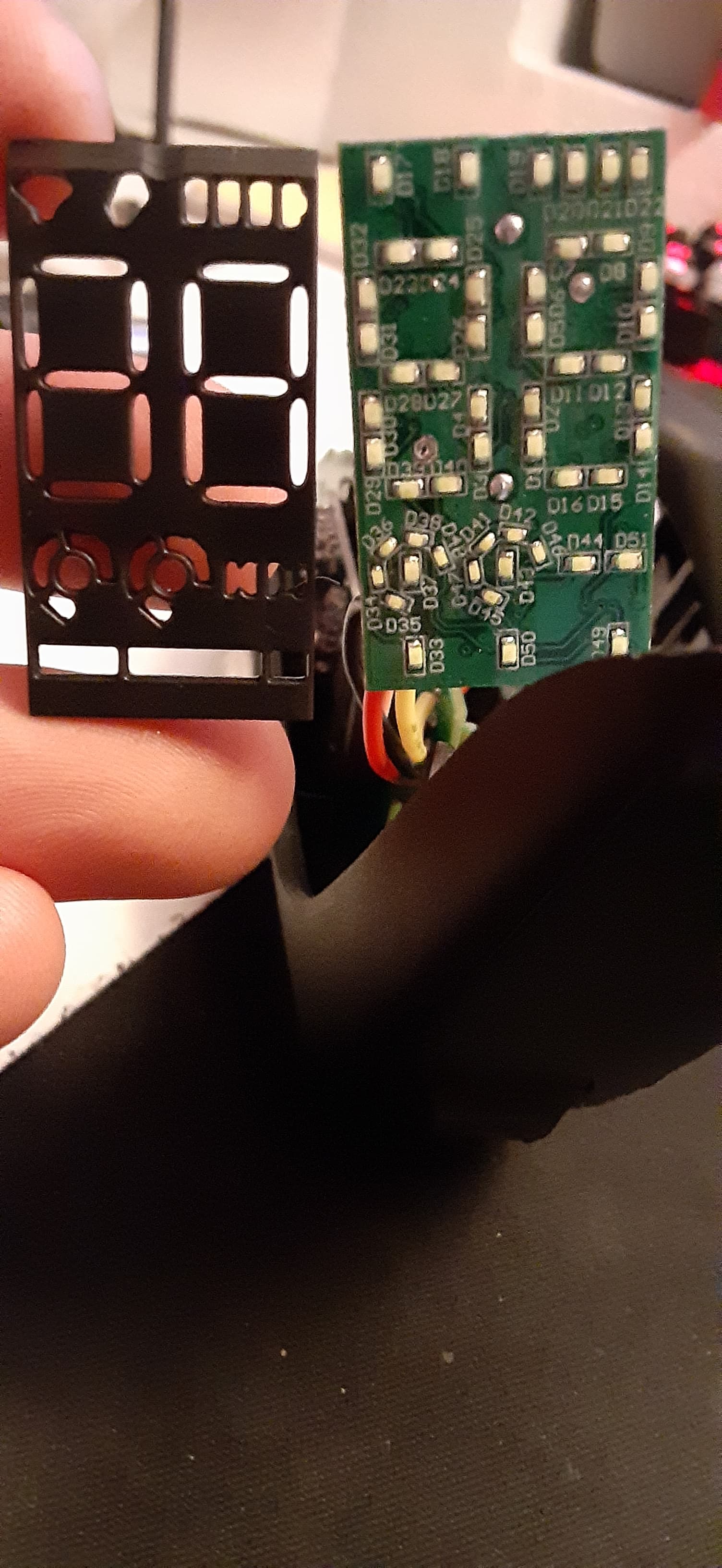

Got a broken remote they did not try to fix
Dead cell charged it up ready to test.
Oh yeah I should have tried to get better pics of the PBC to look at the radio tech exactly.
Now it definitely looks like you are just reverse-engineering everything that company has ever done :laughing:
Reverse engineering a board with no reverse.
I also needed to look at the chips to locate the cell charge manager and see if that is the cause of the cell drain. The more advanced delving would be checking cross compatibles with Trampa nrf hw/fw.

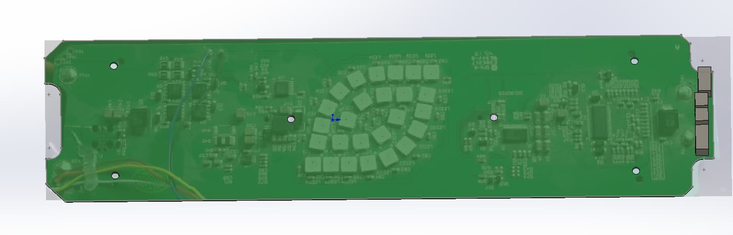

First thing I note is yeah, these tiny connectors were damn near the worst thing about it. Making repairs impossible is not cool.
visually done-ish
now making the parts actually fit together and as close as possible to irl.
This is good enough to have printed and test fit with irl parts.
sbx batt asm v1 model for testing.STEP (1.5 MB)
