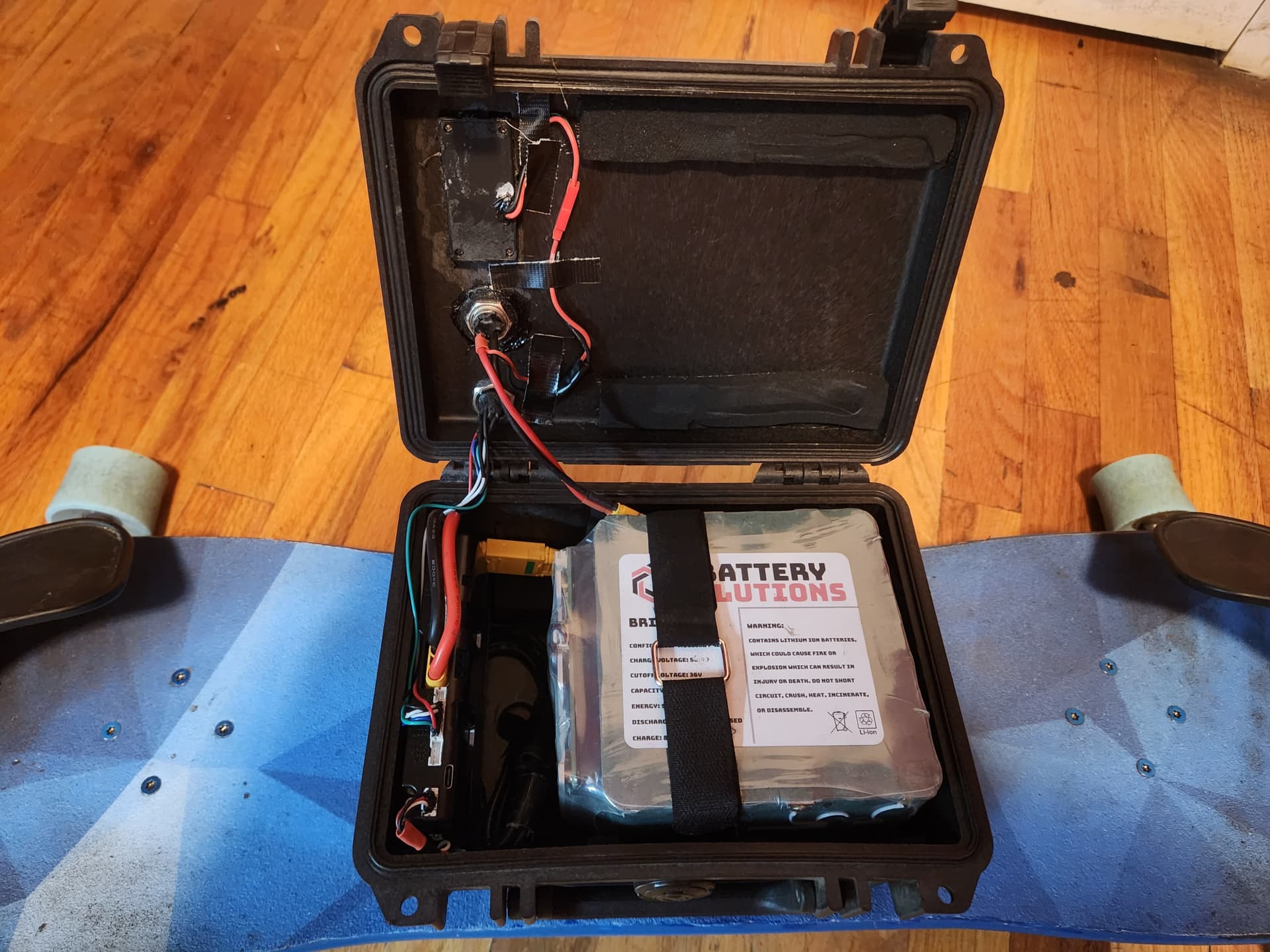

Small Update replace the xenith with a spare stormcore. Designed a recessed charging port mount to prevent damage to the charging port if/when the board flips over. Finally got the voltage monitor to work without dying from vibrations after 3 rides. Cleaned up the wiring. Tested out splattergoat a custom griptape printing service. Results were decent. But I shouldn’t have made it such a light blue, it picks up dirt to fast.
