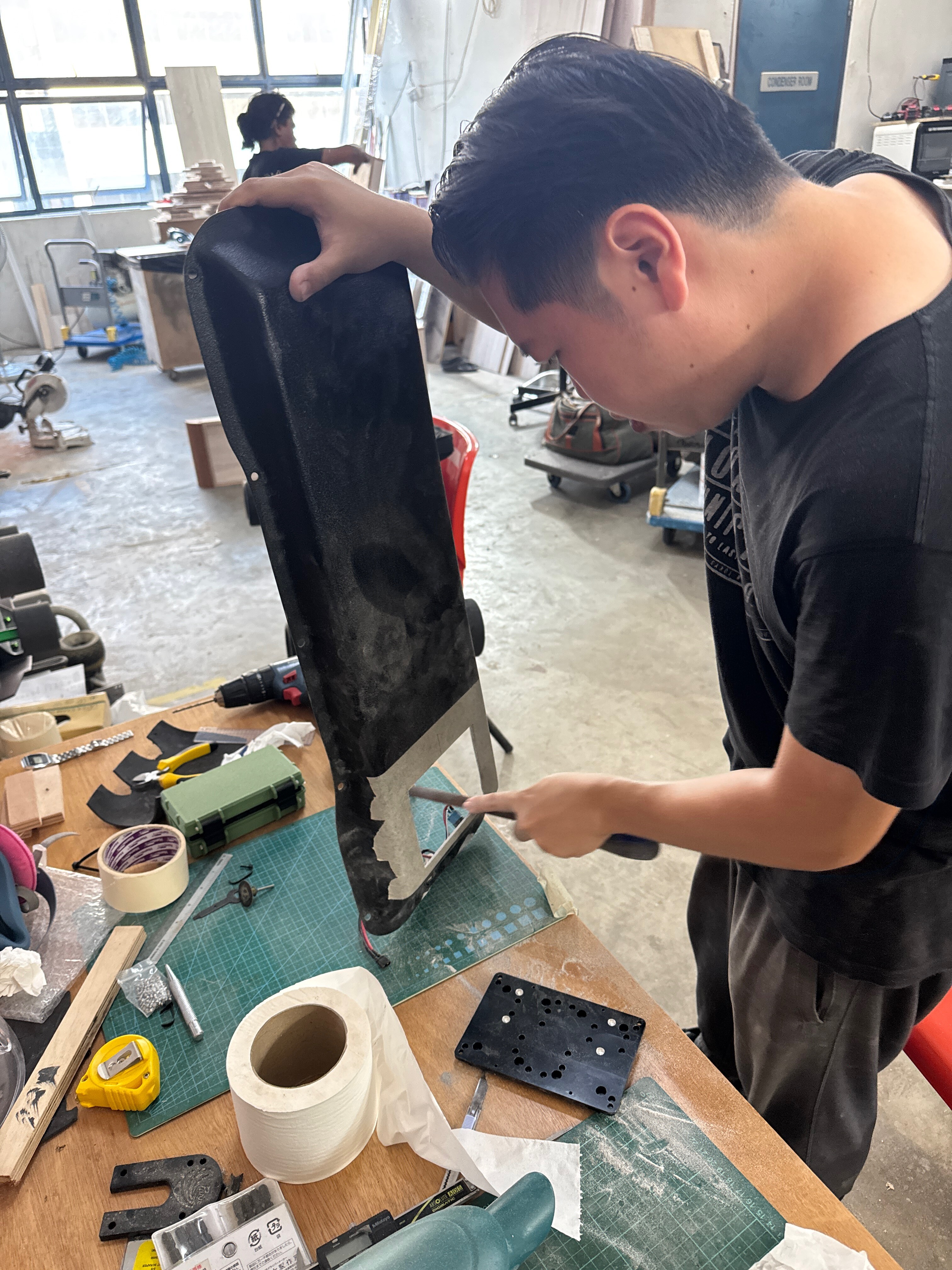

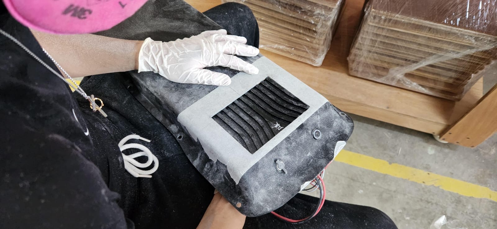

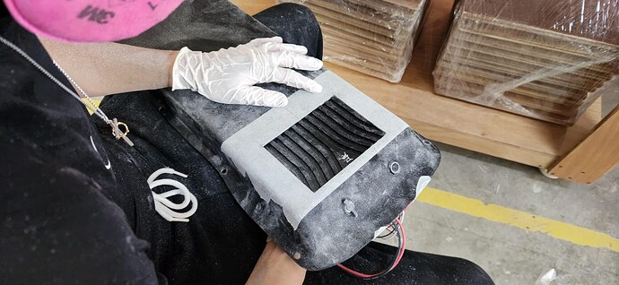

Was getting kind of high temps for both my esc and motors, so i decided to get a heat sink.
I also edited the stl files for my gearbox bashguards for better airflow to the vents on the reacher motors. Temps are now super low which is nice.
Some pics of me installing the sick ass unisink which i bought off of linny.
My arms are gonna be itchy tonight from all the fibreglass work🥲

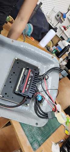

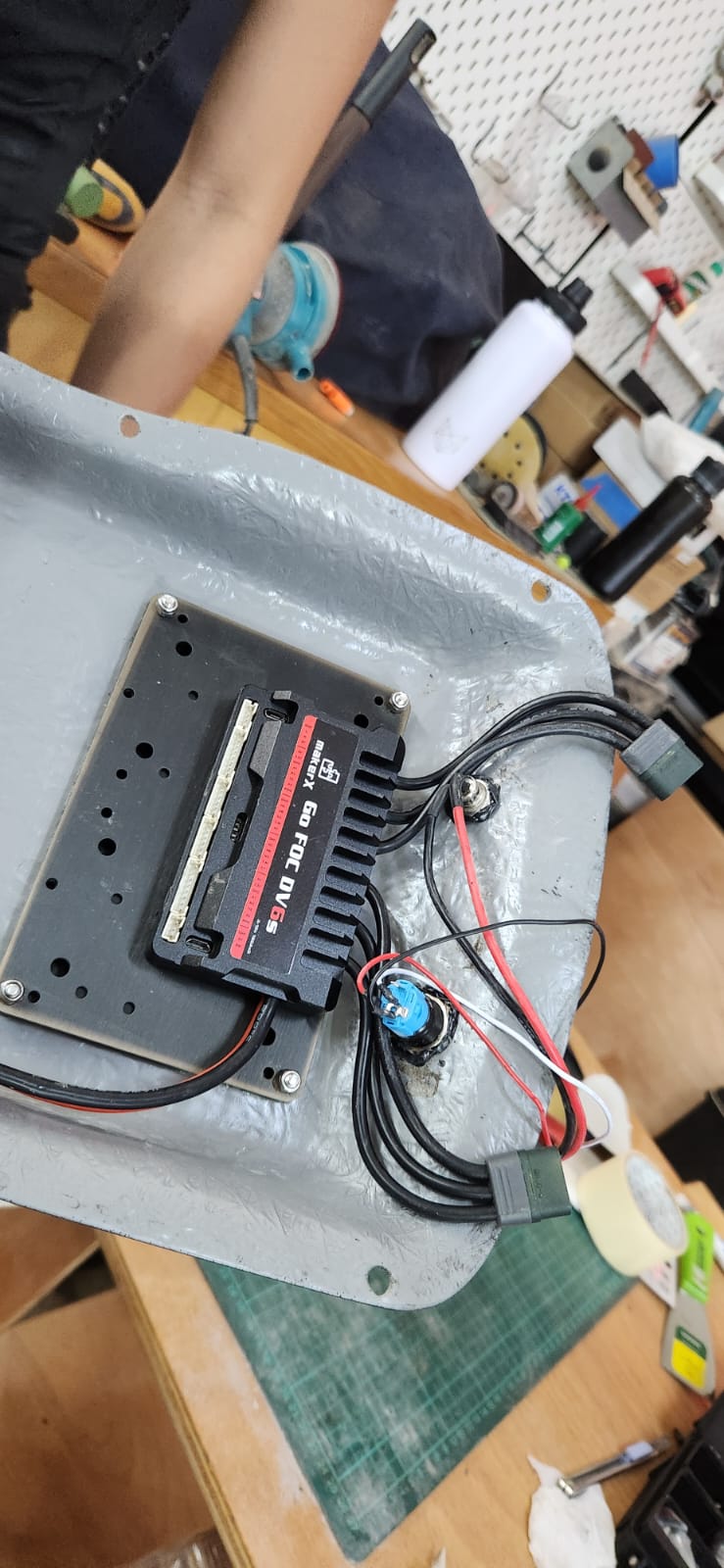

How high were your temps and how did you mount the DV6s to the InfinitySink?

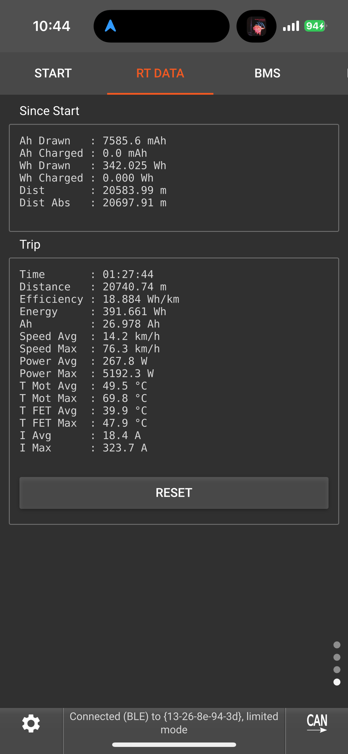

Temps were around 65c ish max, Avg 57c mosfet side when accelerating and braking really hard on flat roads, and motors were around 70c max and 58c avg.
Post heatsink and gear drive bashguard motor airflow modifications , both temps are about 10 degrees c less on average in similar conditions.
As for mounting, holes were drilled out on the mounting plate for the esc to be mounted horizontally, we drilled the main heat sink to accomodate the screw heads so the two pieces could mate. A Thermal pad was added on the mounting plate to heatsink side, and thermal paste for the ESC to plate side.

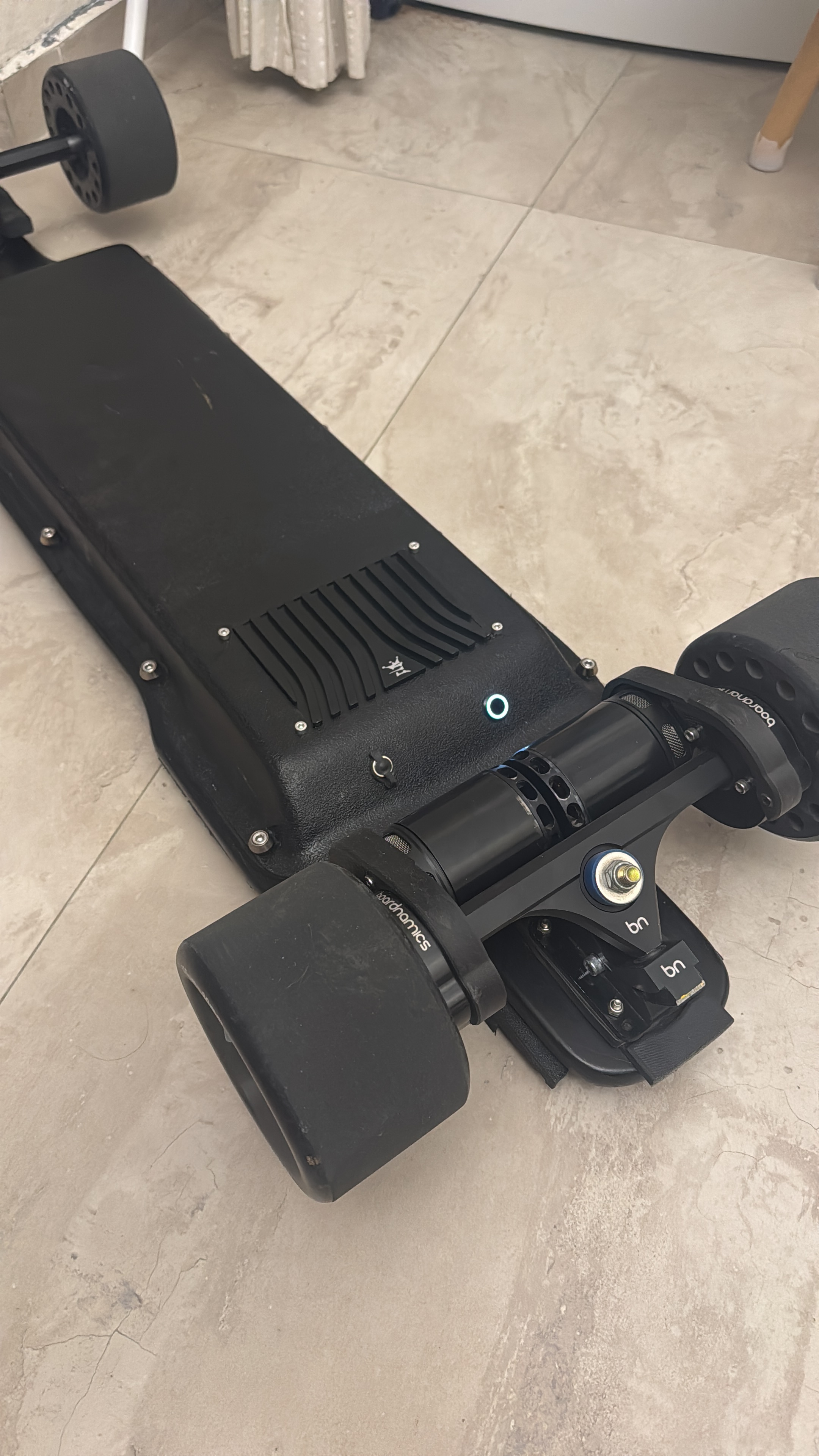

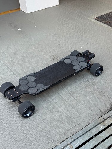

Hill runs and some updates! Im running bldc at the moment, so my top speed is kind of insane. Slapped some hex vicious griptape and swapped the rear board-side bushing for a chubby bushing. Handles absolutely phenomenally. Considering my weight (56kg), its basically a rocket. The bldc punch just kicks so good, and it sounds fantastic!
Hey, I have a Killshot 38 deck, and I gotta get different trucks. Currently looking at the BKB 236 trucks. Just looking at your build and trying to plan for mine. Is your deck the 38 or 40-inch deck? Wanna prevent wheelbite on SR125s
