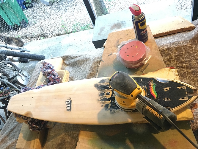

I wanted a kicktail so went for this Bamboo Craigslist Riviera deck with some Caliber V1’s at a very decent price. I was aiming to keep the wheelbase as short as possible because i wanted it to be maneuverable and feel light, was planning to drill new front truck holes and chop some nose off.
Sanded the graphics off (I don’t like reggae, i love it)

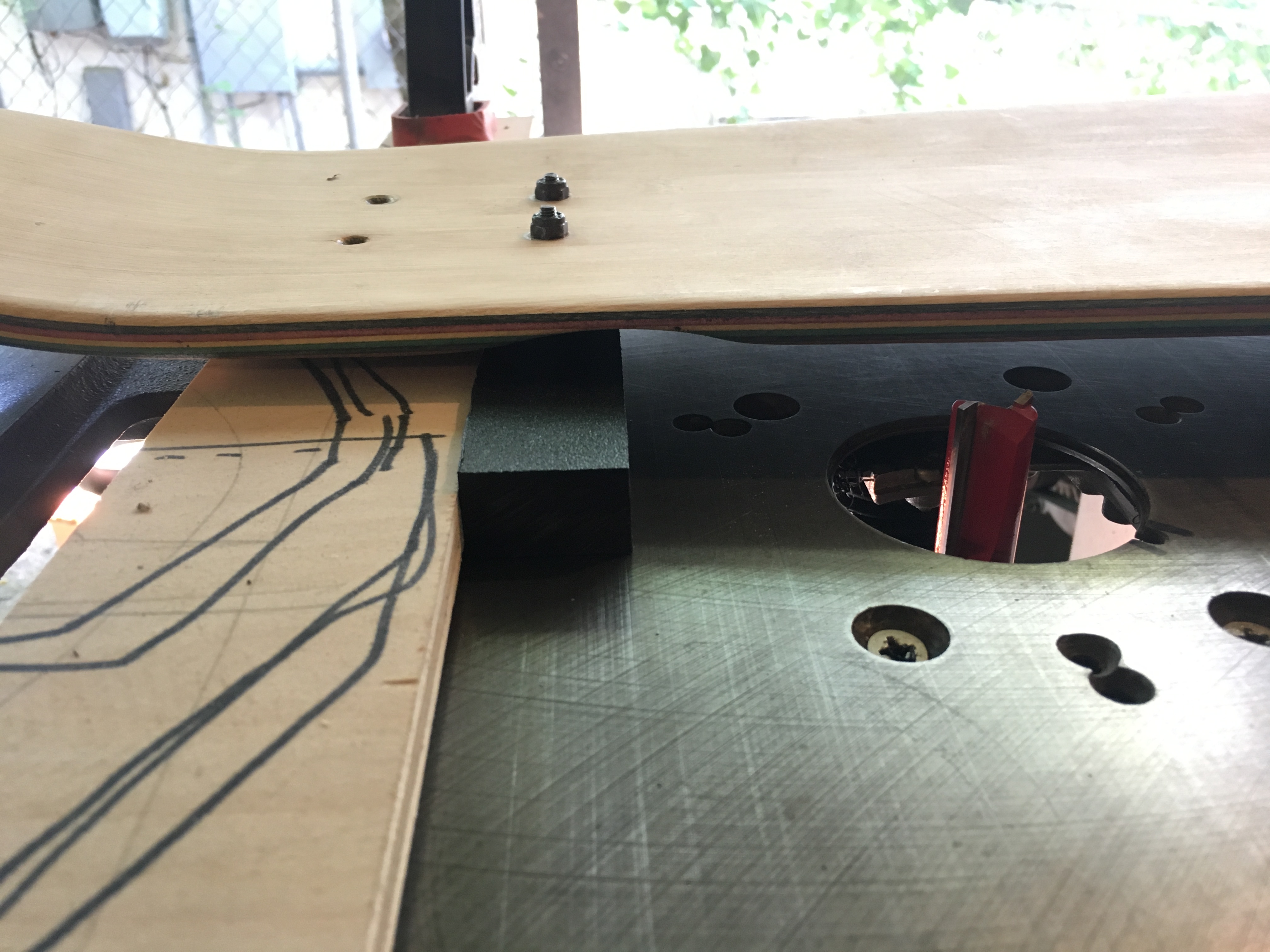

There was some concave, routed out a couple of plies where the Unity and Battery will go
2am, can’t sleep, “how do i attach the battery and Unity?” i wasn’t into the idea of them sitting in the enclosure and it taking all the weight so attaching velcro straps became the idea, next day i routed out slots to feed the velcro straps through.

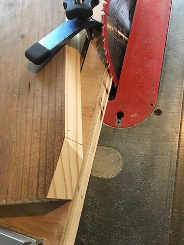

I spent a lot of time admiring LHB’s wiring solutions, wondering if i could route out any more ply to cleanly run the motor wires through this 7 ply deck, decided it’s probably a no go. I has some HDPE that i’d got free from Craigslist a while back “that’ll be handy one day” did i say my wife is amazing?
Cut and routed that into something vaguely resembling a tunnel riser

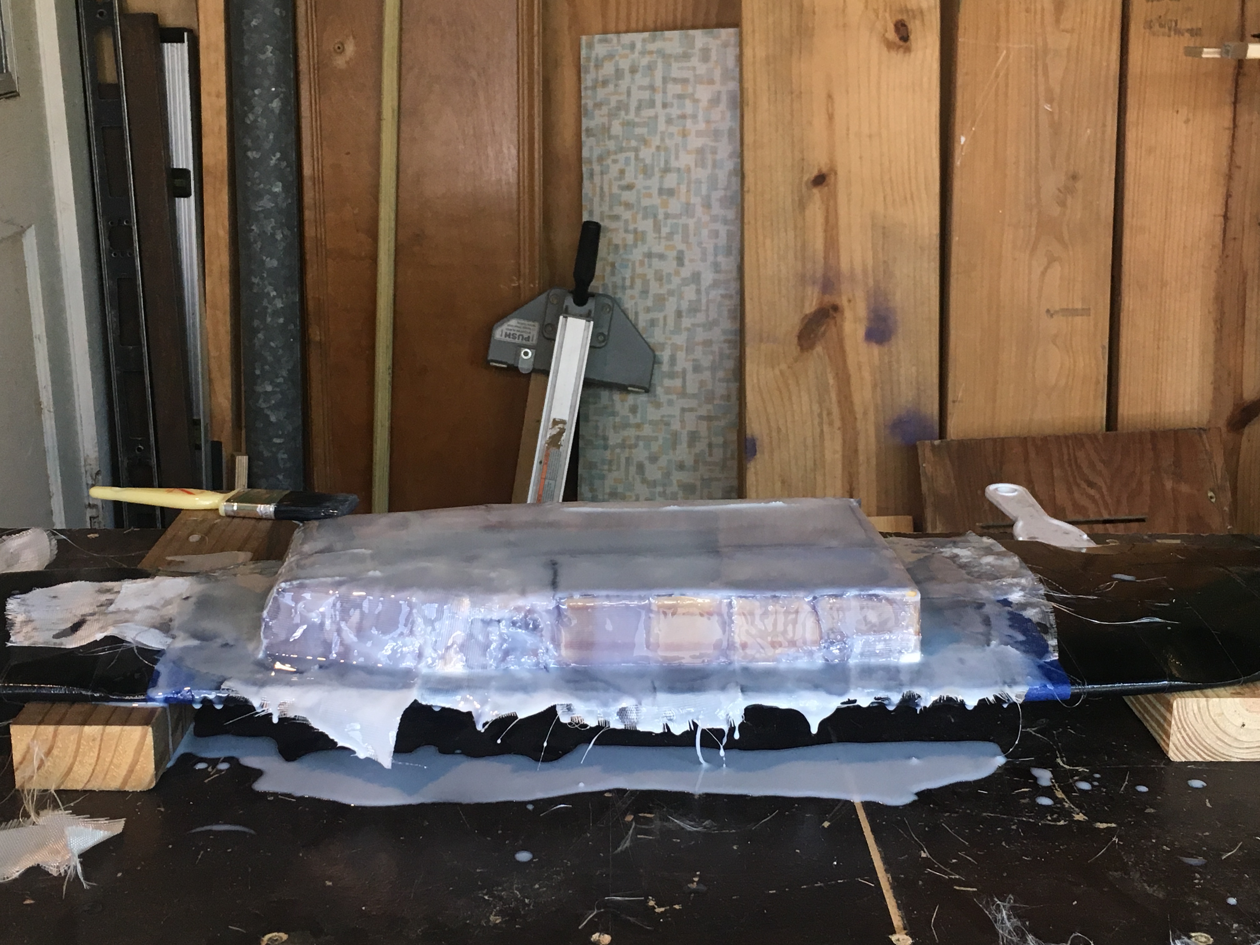

first layer went well, my Zen calm approach slowly disintegrated as the corners and beautiful curves i’d shaped started lifting away, i looked like i’d been tarred and feathered but with resin and fiberglass, it was messy!
If anyone ever wants a cake decorated hit me up

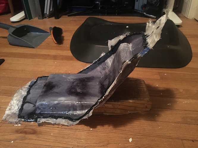

walked away, came back the next day to look at the ugly lil monster i’d made, could have been worse, maybe? It was a bit thin so ran round the edges with hot glue to make a barrier then just poured a tonne of resin on top and also swirled round some dyes to really hone in my cake making skills…
Do not believe everything the internet tells you! (except this)
Butchers Block Conditioner does not stop resin sticking to wood, however many coats you put on,
i almost dislocated my shoulder trying to get this off, in the end i stood on it and pulled with all i had.
it luckily had some flex so folded it back in, there was hope?
there were still some very thin parts so ran a few strips on the inside, this was a lot easier than working on the outside, if i ever do attempt this again i may make a negative mould so you can work on the inside, a lot easier to push the corners in.

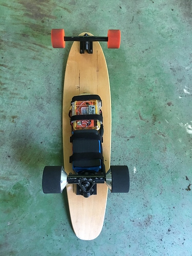

Test flight 1, Deck 1
First time i have ever ridden an electric skateboard, holy F, not what i’d anticipated, the acceleration!
big smiles, my idea of shortening the wheelbase was put on hold, should i make this thing longer?!

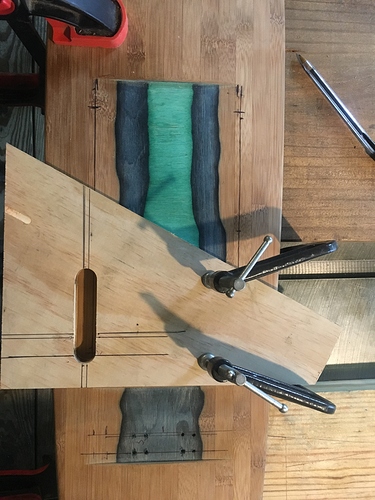

Make a quick jig for the velcro slots (i may be doing this more than once again…)

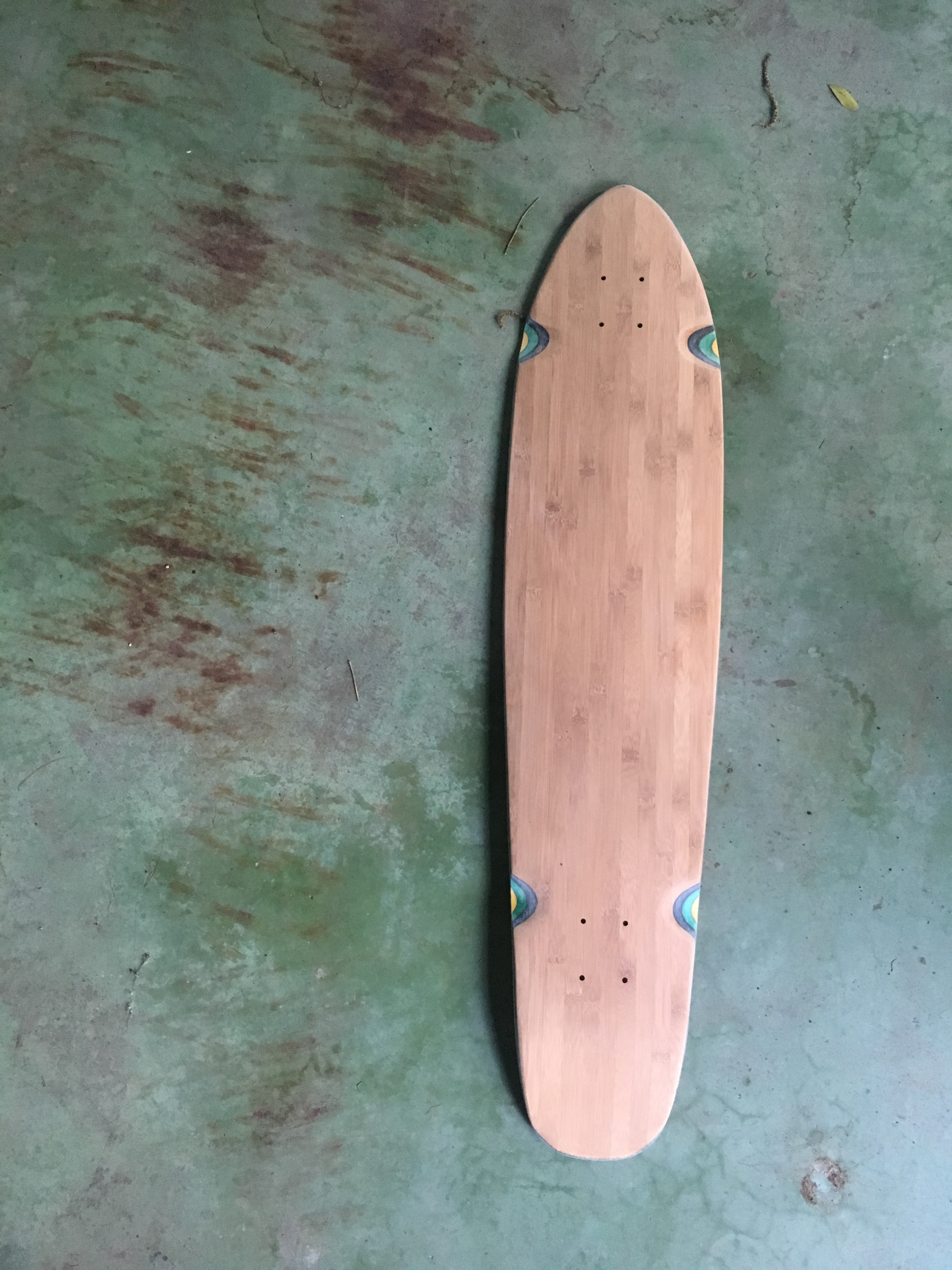

Deck 3…
Ebay - Kicktail longboard - 39.5” x 9.5” - $23 delivered
Make an even better jig (i’m definitely going to be doing more of this)
this jig bolts to the truck holes so it’ll always be the straight along the board, cut slots so i can use it for different wheelbases.

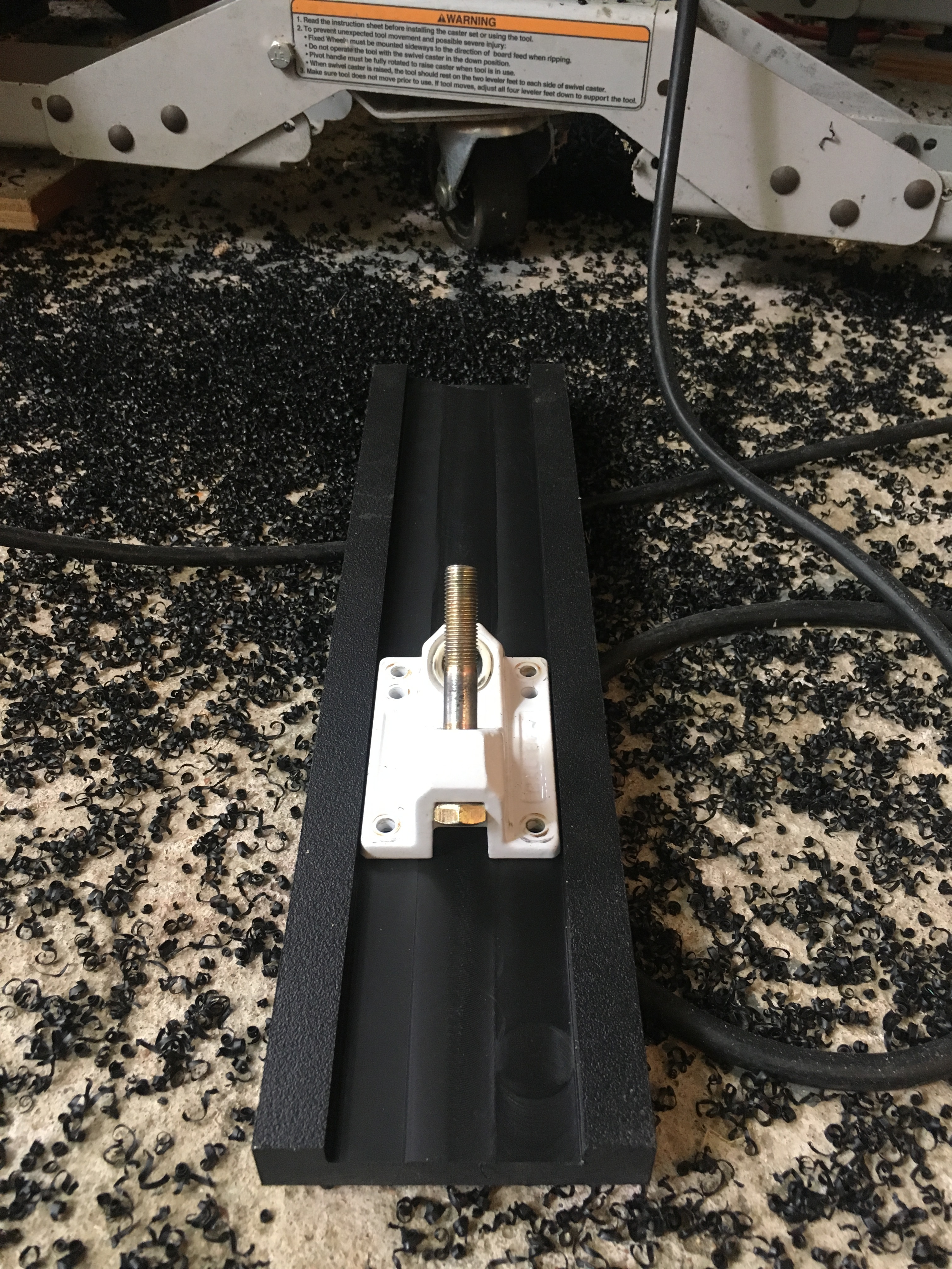

Modified the Boardnamics motor mounts;
I really like these, they fit very securely and square to the hanger.
i’m using a 265mm belts with 16T 36T pulleys, this brings the motor very close to the mount clamp.
i didn’t like the raw end of the bolt being right next to the phase wires
Flipped the bolt around (Could have sawn of the excess but would still be a bit too tight on the wires)

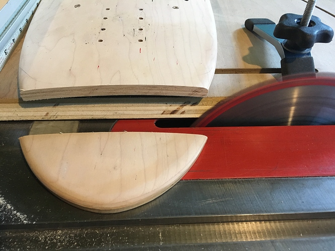

copy Earthwing Mini Glider tail
back street nose job
a little off the sides sir?
eyeball sand a bit of shape
