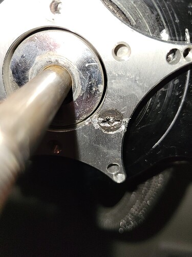

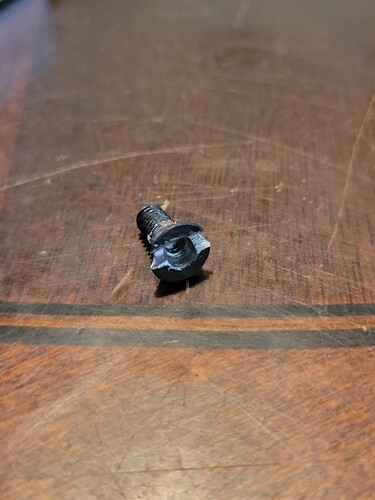

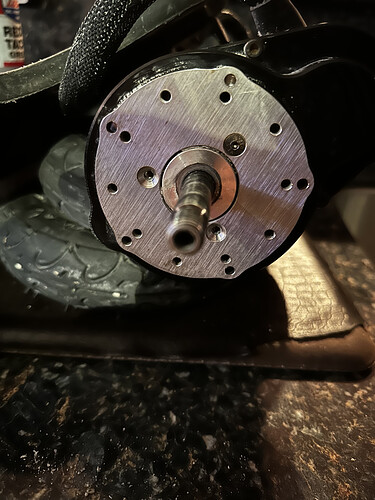

I could use some advice on dealing with a stripped screw. I cannot get this 2.5mm hex screw out. I used Loctite 245 on it as suggested. I got 2 out, but stripped the third one :frowning:
What are good ways for me to deal with this?
