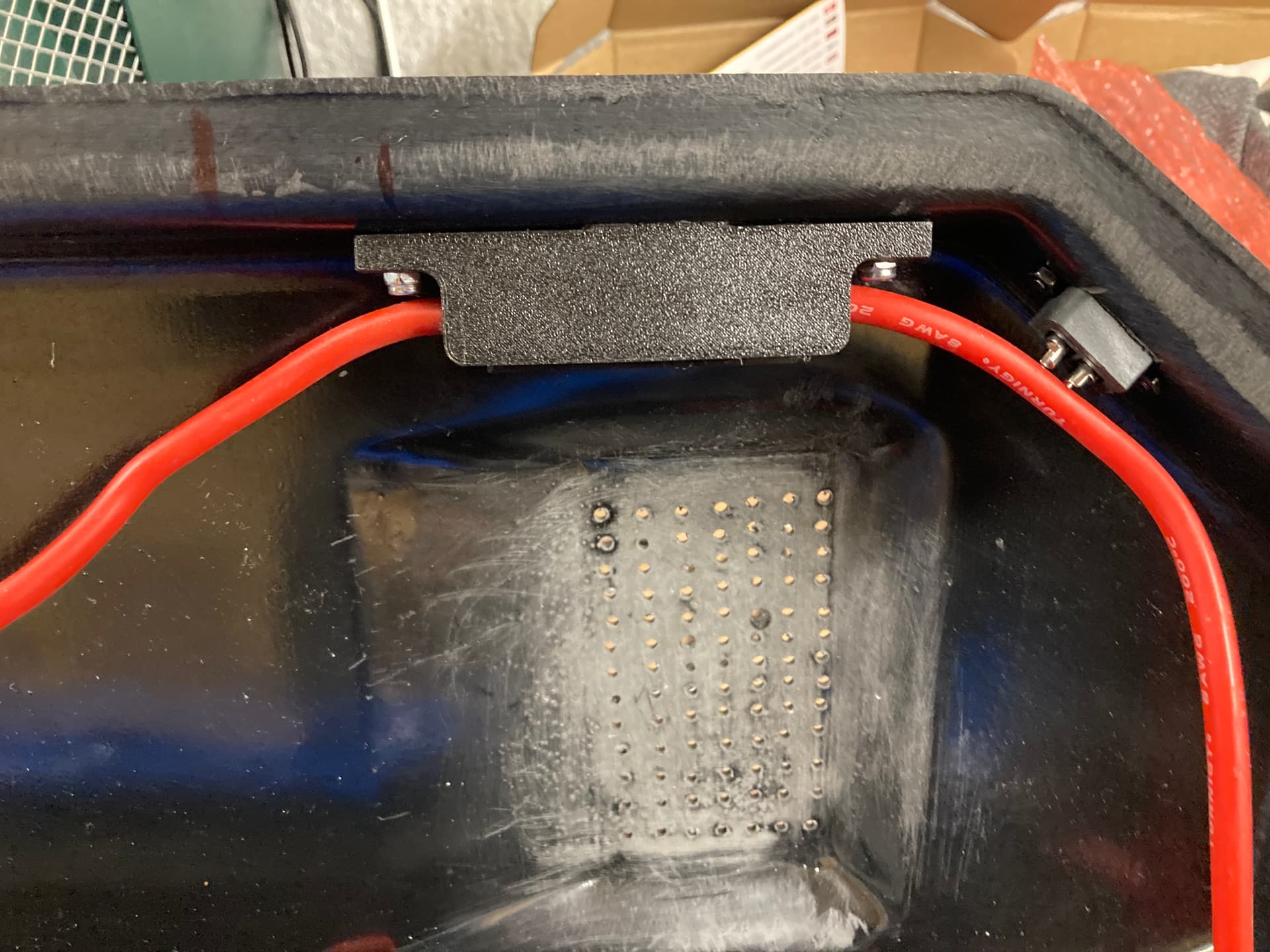

I got a little further with the battery and decided for the layout. Today I got the enclosure made, with an extension to house the esc’s. I needed the enclosure to continue with the battery and the rest. Now it looks like I can step by step finish this build.
I am using a mix of 8 and 12 awg for series connection and will use 8 awg for leads to the mambas. Each mamba will get its own lead.
Enclosure is 3mm high and the extension another 16mm to house the fan of the mambas.

Got the enclosure cut out and drilled for air intake (yes too lazy to spend the 2 min extra to get a nice even hole grid - stupid). The layout is finally decided and its gonna be a tight fit.
Now finishing the battery. Enclosure holes cutout for motor wires, charge port and loop keys. And all the other “minor” things that always end up taken for ever.

Finished up the battery today and mounted the antisparks. Chargeport mounted but still needs longer screws be able to also mount the chargeport cover. Screws it came with wasn’t long enough to also go through the enclosure.
Next I will mount the enclosure and then holes for motor wires.
Was this a custom enclosure, it looks like it’s a single stack? The ones that come with the board are double stack atm.
Edit: I scrolled up, and see it is
Yeah… I wanted these decks to have a single stack enclosure option. Double stack is nice when we want range near the 100km. But I also want to have the option of a lighter and slimmer setup.
These are abs atm. Maybe at some point they will come as fiberglass.
Ooh ok so you thinking of selling it?
Yes. They will pair up with the decks Northcamp and Jotnar. There are both a version that holds 8 cells across (21700) for 4p batteries and this one that holds 10 cells across for 5p packs.
