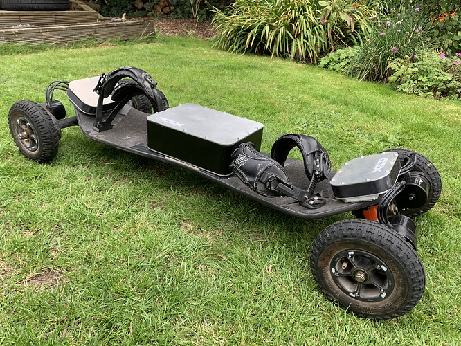

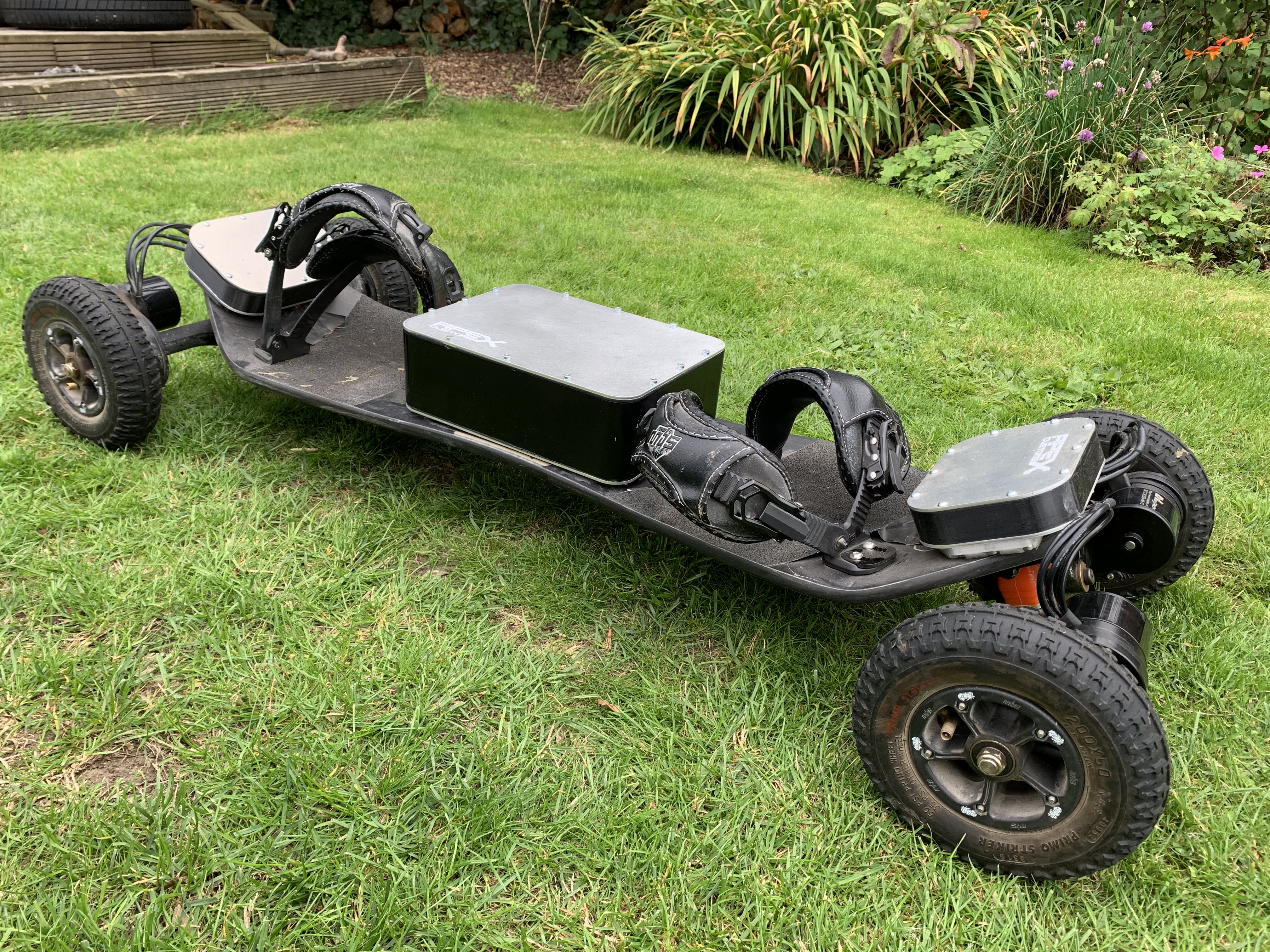

4wd Haero Bro with 3ds 320 hangers this has a 12s6p moli p42a

Are you using the eboosted enclosure @ahrav ?
Also, how fast do you go? Is that setup really stable?
I am using the DS eBoosted enclosure yep. I ride sorta fast :call_me_hand: but yea the angles on these are setup to ride into the 50s. Also having the right bushing setup plays a huge role. Angles + bushing combo and ride height for me are what do it.
As for stability never had speed wobbles with either of these setups :eyes:.

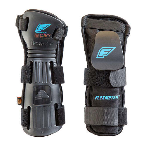

These are legit the best wrist guards I’ve ever worn.
Not only can I wear my BTR leather gloves underneath them comfortably but I can still bend my wrist and hold my remote.
Highly recommend if your hands are important to you. I’ve injured my wrist too many times to wear anything less.
