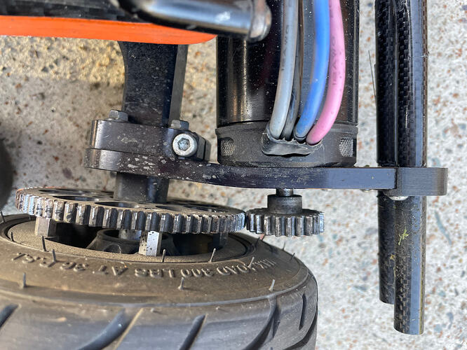

Genuine question here… Why not?
From my perspective this seems like a textbook case of a product failing under normal use due to a manufacturing decision. So I’m genuinely curious why you see it differently?
You propose a great question. I did use under normal conditions. I suppose I feel the way I do because I’m used to breaking things in unusual/ unorthodox ways. I’d be casting more blame or claiming malfunction if spurs were failing and he was dismissive of the issue. I appreciate what Moe is doing in the sport so not trying to cast shadow over SRB. I’ve never seen them fail previously so not widespread issue? Moe has offered to press new core into spur for the cost of shipping which I appreciate. I however will move to Tito’s 67t laser cut and hardened 1-piece spurs.

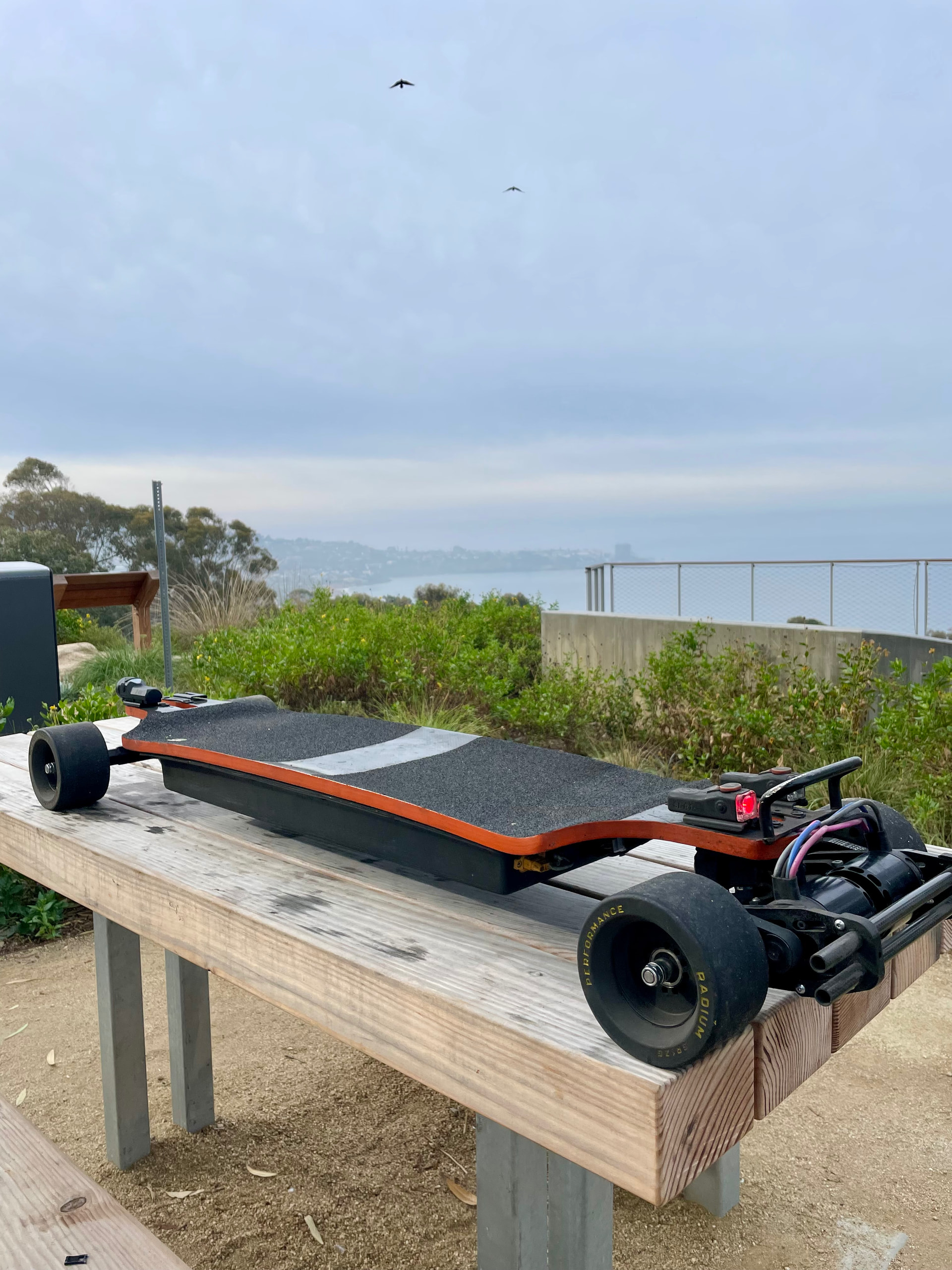

I’ve ordered some of Tito’s laser cut and hardened spurs, while I wait I stoped by Ray’s La Jolla Ebike and Skate for some motor pulleys and keyways to try the SR125. So nice having local resource for esk8 parts.
Got em installed no problem, blast from the past installing belts again. Out of all my spare belts only had 2 that fit. Got em on in time for our local SD intro to speed. What a joy these wheels were to rip around the track on. This street beast makes for a pretty fun race board although all of us that tried it were slipping belts on braking into turns (new belts stretched a bit). Tires had good grip, and a very predictable slide profile. Something I’ve missed greatly having the linnpower slicks on my V5, is the second they break loose it’s very hard to keep under your feet. This was very opposite, controlled drifting.
Also put down 30 miles on the SR125 in the shitty coastal streets of San Diego. So many cracks holes and uneven conditions. These tires handled great! Very comfortable, no foot fatigue. I had plenty of grip to inspire confidence. A major problem is purely the wheel size on roads in poor shape. On the 7” novas I feel like a tank on the road able to plow through most obstacles harm free. These radium wheels being 125mm require much more focus and you just can’t push a fast pace in much of these roads. If I lived in area with better conditions or rode bike paths more consistently I’d consider them for daily use. I will go back to 175 novas as I wanna test some high speed.

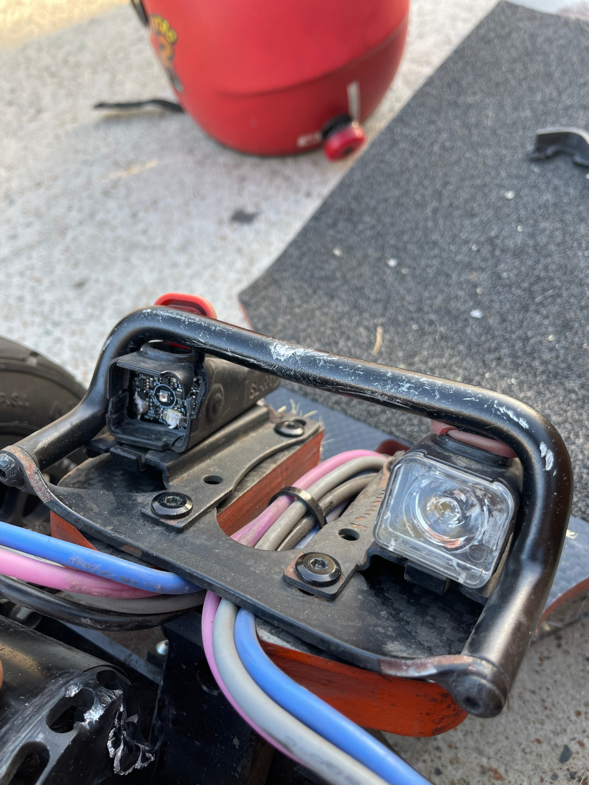

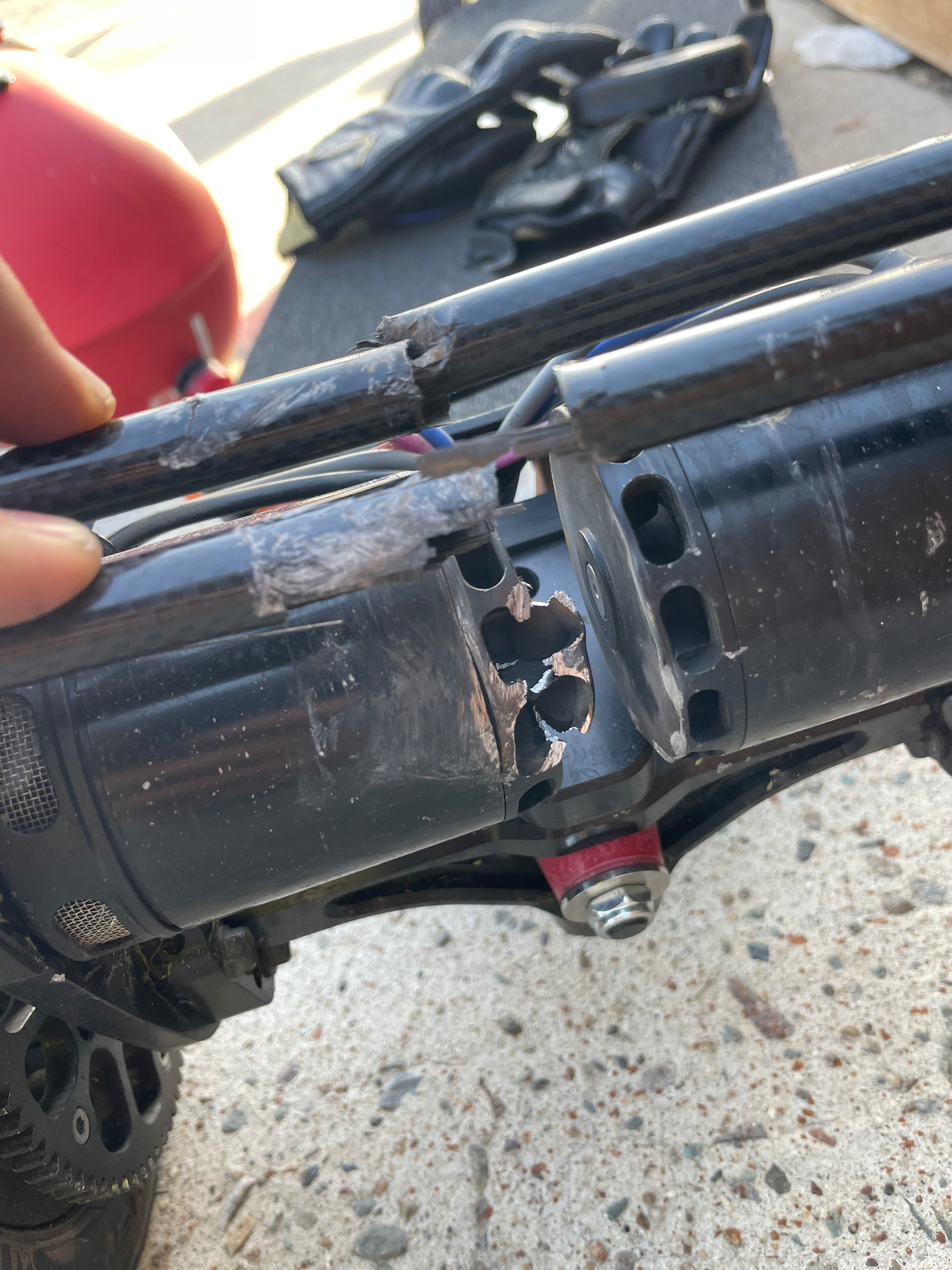

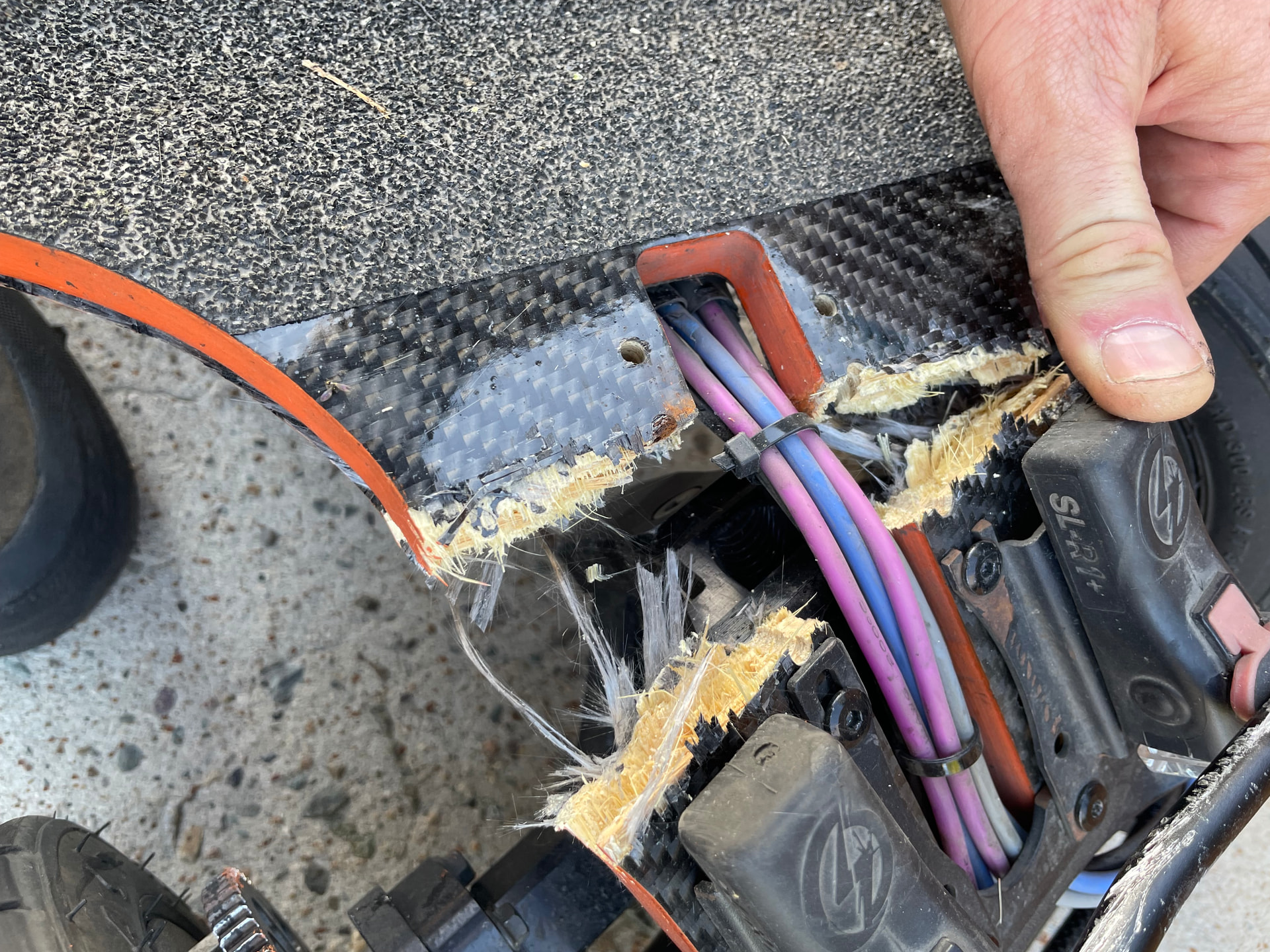

Bi-directional current got me today. Was attempting to do puck down donuts in a plaza area. Came off the board early in the maneuver. Watching board head into a wall I hit brakes and watched it accelerate faster so hit full brakes sending board into a staircase handrail pillar full speed (telemetry data shows 50mph at time of impact). All happened so quickly. Looking at it all now, the board had done a 180 when I came off, so when I was trying to slow the board down with brakes it was sending it into the wall harder. It was a busy plaza, I’m extremely happy I didn’t run into anybody, or any bikes.
Damages:
Odachi deck is toast :sob:
Bent duality motor mount and smashed carbon fiber bash guards
Smashed motor can, other tbd
Handle and Shredlight is busted

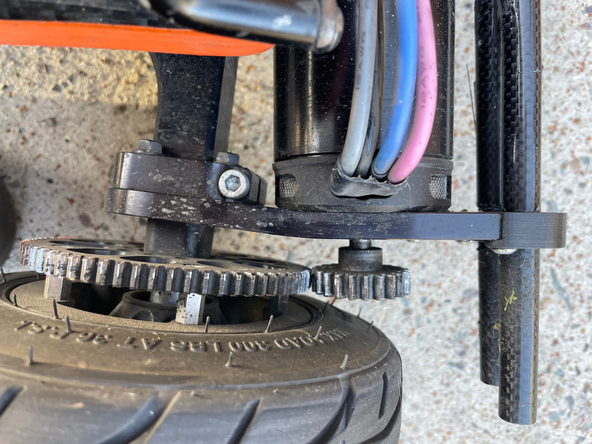

Hopefully these brand new 67t spurs from Tito are still true and straight.
Effing horrible dude.
I am glad no one got hit.
I had a board run away from me recently and I was so worried about it taking someone out.
You certainly did way more damage.
I hope you get it back together soon.
Thanks bro. Nothing time and money can’t fix fortunately. I need to adopt a habit of no throttle input when I come off the board from here on out! Unless I’m 100% positive of board orientation that is. My guess is this probably happened over the course of maybe 3 seconds max. Not much time for rational thought.
