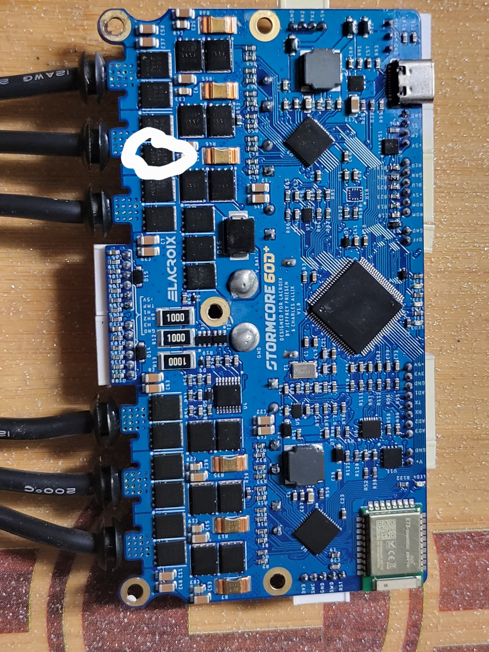

Hey guys so my stormcore60d+ has blown a mos pleasefet on the one phase wire and ive taken it into an eltronics repair guy to get it fixed. The guy is having trouble finding a replacment. Its this chip thats gone. Can anyone point me in a direction where to buy this or a link to it

Happened riding an up hill paved trail here in hamilton. Blew about half way up a 15 min ride up hill. Now only half the controller lights up and shows up in vesc tool. Tested for resistance between phase wires all combo of them were around the same reading except that wire. apron closer inspection I can see a slight bulge or dent so small in the top of that mosfet. The rest the mosfets all look flawless and uniform.
Also im not sure rhe part number that kind of what im asling for
Take a flashlight and light up the mosfets from the side, and bust out a magnifying glass.
Play with the angles.
The part number should pop.
If it’s too small and you don’t have a jeweler’s loupe, you can take a photograph of it, and then zoom in on your phone to read small text.
So the Mosfets have written on them
R626
SAAA
.W99K
Does anyone have a link to the chips I can replace them with?
