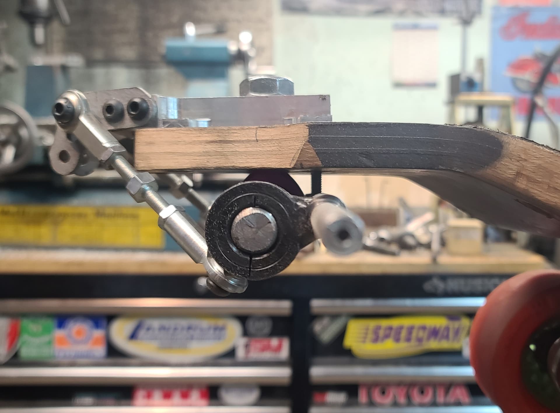

I would point out that this video is potentially very confusing to people trying to understand the “RTC” principle, because as you have vise gripped weight on there, the OG 3 links would perform the same. Perhaps if you put two weights onto the offset axles themselves and demonstrated vs non-offset standard 3-links, the RTC principle would be more apparent and more difficult for people to misunderstand. It certainly took me a minute to figure out how the offset was making any performance difference in your example at least.

To me it appears to be negative rake, which is not a bad thing. The low rebound characteristics of 3 links could handle negative rake very differently from other trucks, so I’m excited to hear how this progresses.

So this adapter is for the caster angle ? Weird to see it play out without movement. And I’m sure other @RipTideSports bushings with more rebound will also help.
Not really caster either. Think about a shopping cart wheel. With caster you need a directional force applied to an offset pivot center.
With RTC the riders stationary weight determines the amount of return to center force.

If all you’re doing is changing the axle position relative to the pivot axis, then its changing the rake.
So looks like negative rake to me.
Negative rake does have that raising center of gravity, and that return to center action.

No it wouldn’t. Return to center effect doesn’t exist without rake. If the rake was neutral, and there were no bushings on the center balljoint, the truck would be stable at any angle and not return to center.
Moe’s video demonstrates this well. The offset axles are modifying rake. The return to center, is a property of negative rake, because the center point is the most stable point when an axle with negative rake is loaded.
This is a simple way to think about the impact of rake on truck stability. If you watch Moe’s video above, you’ll see the truck behaves as you would expect it to when modifying rake. Negative rake creates stability in the center, and positive rake creates instability in the center. Rakeless trucks will be stable at any point. Put weights on the axles of a standard rakeless 3-link, and it will sit where you tilt the truck.

After some testing in solidworks I have made some shocking discoveries…for every 3 link setup (including positive and negative rake) there is a way to replicate it with an RKP that has a 1:1 deck roll to axle yaw mapping, and none of them pitch the axle by an appreciable amount
Rake and RTC boil down to exactly the same premise of whether the fixed point of the axle sits above (stable) or below (unstable) the plane of rotation (coincident to the axis of rotation of the hanger and parallel to the axle)…if you have anything that spins and the axis of rotation is not vertical, the center of gravity will alway act to rotate the object until the center of mass is directly below the axis of rotation and the same thing happens here

Yeah I made the same discovery in CAD the 3 links just pivot like an RKP.
However I do wonder if the cantilever effect from an offset axle causes additional friction on the 3 links from loading up the rose joints which may help to dampen oscillations
Ok class.
Neg rake or Pos rake?
What do we have here.
Fig2
Neg rake or pos rake?
Both setups make RTC
