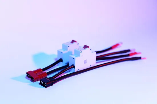

Some clown sells these for… prepare yourself…
$95 a piece
For use on the battery discharge line on an ebike/moto🙀
My brother in Christ, if you are popping fuses that often, this is not the solution.
