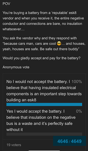

19 out of 19 anonymous DIY esk8ers wouldn’t accept a battery product with a bare negative terminal.
Results harvested from a completely unrelated survey.
