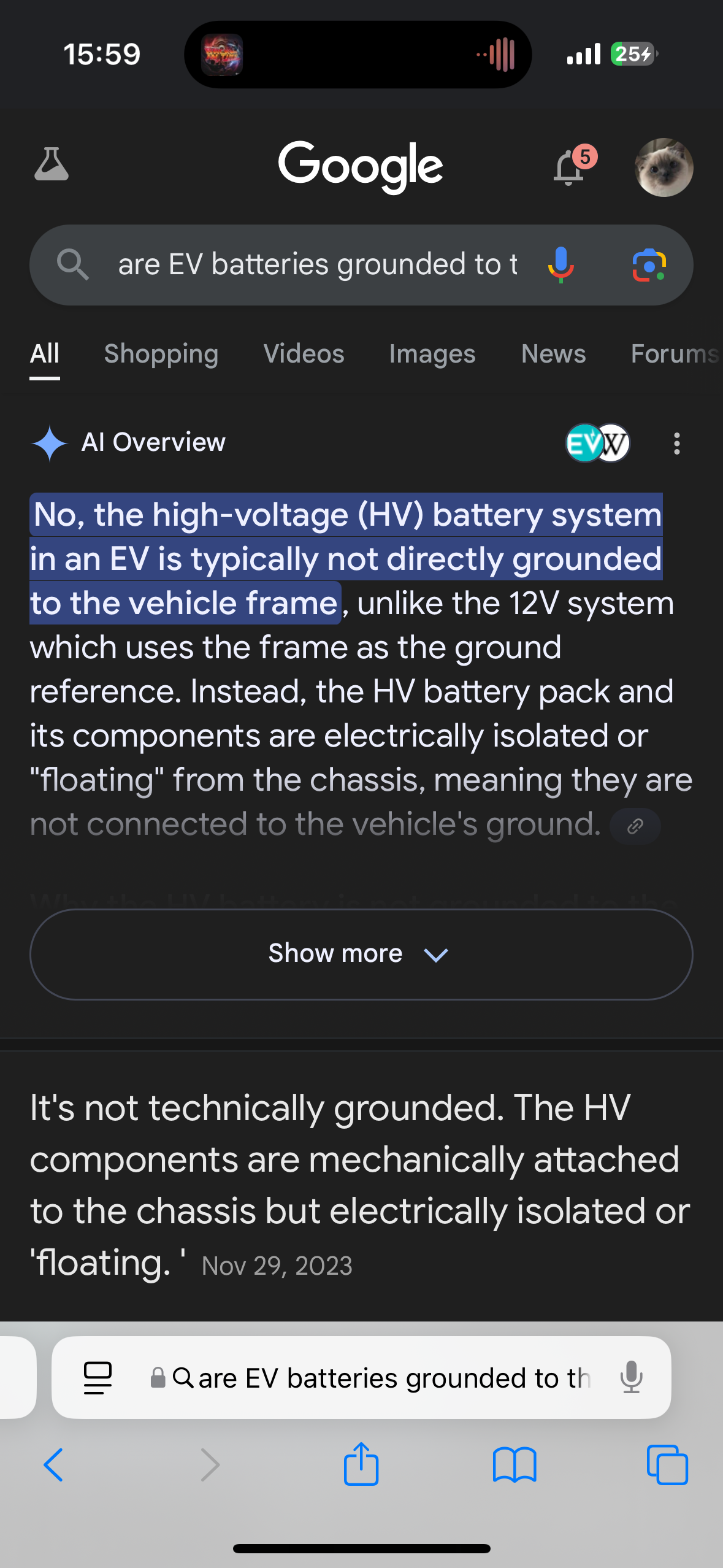

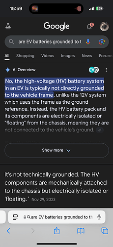

i’ll just plop this here
do with it what you will
You’re talking 350 to 800v… esk8 voltage is still considered elv at least here anyway.
esk8 voltage is still higher than car LV, which is only 12-16V
esk8 LV is only 3.3-5V
