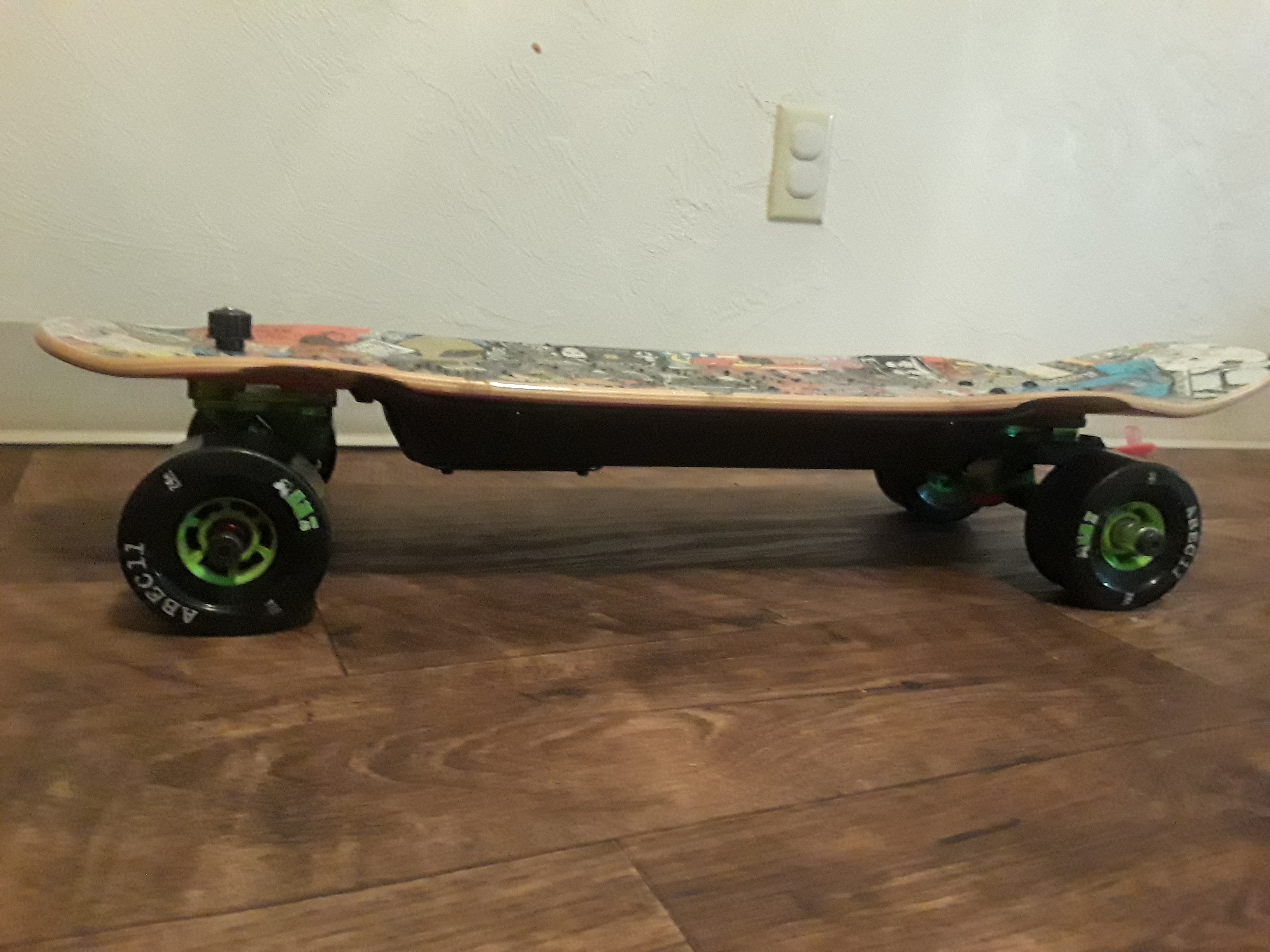

Stickerbomb #f**kpushing fwd 33inch muirskate build

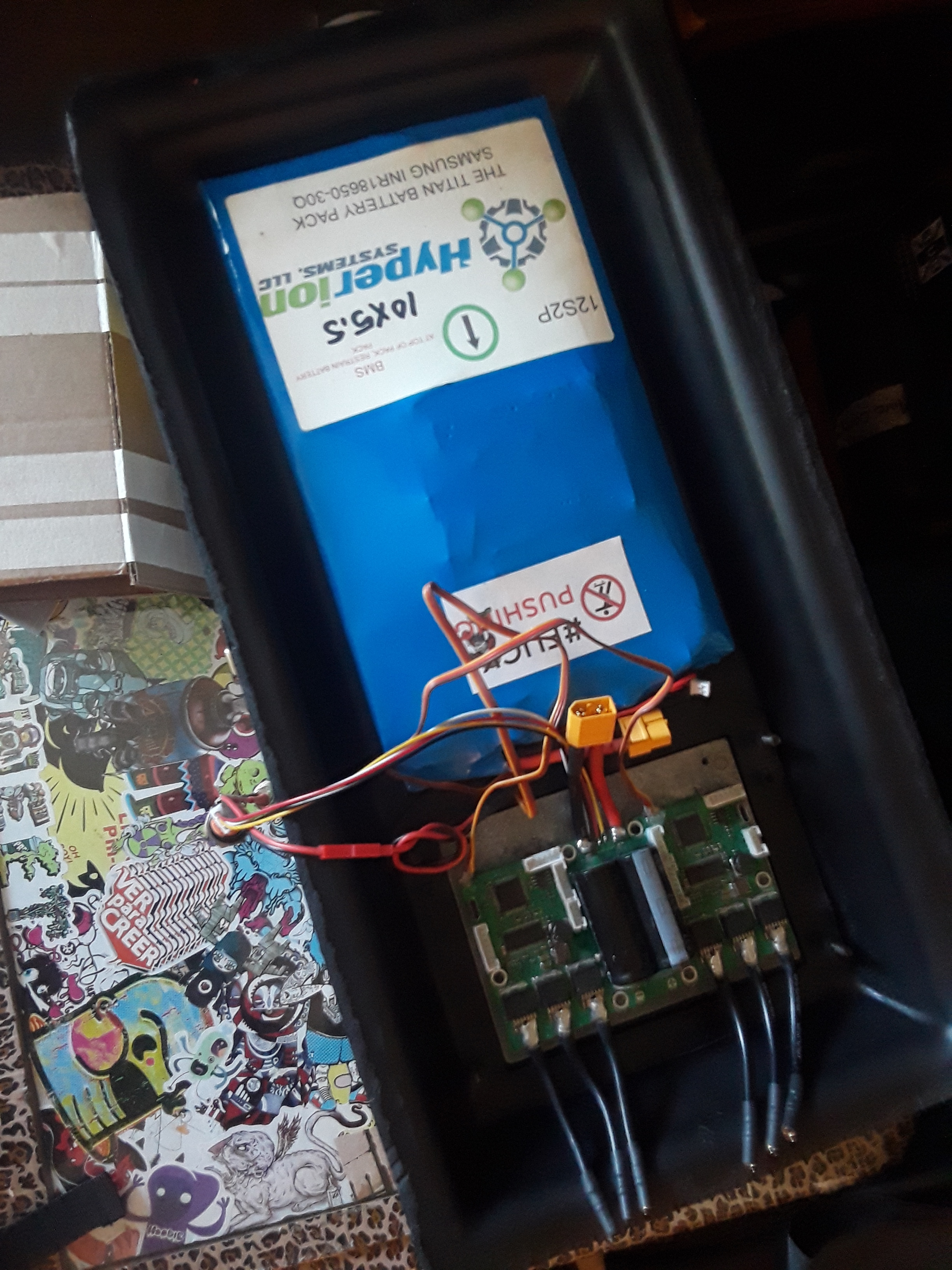

So… i had this random enclosure with a built in heatsink.

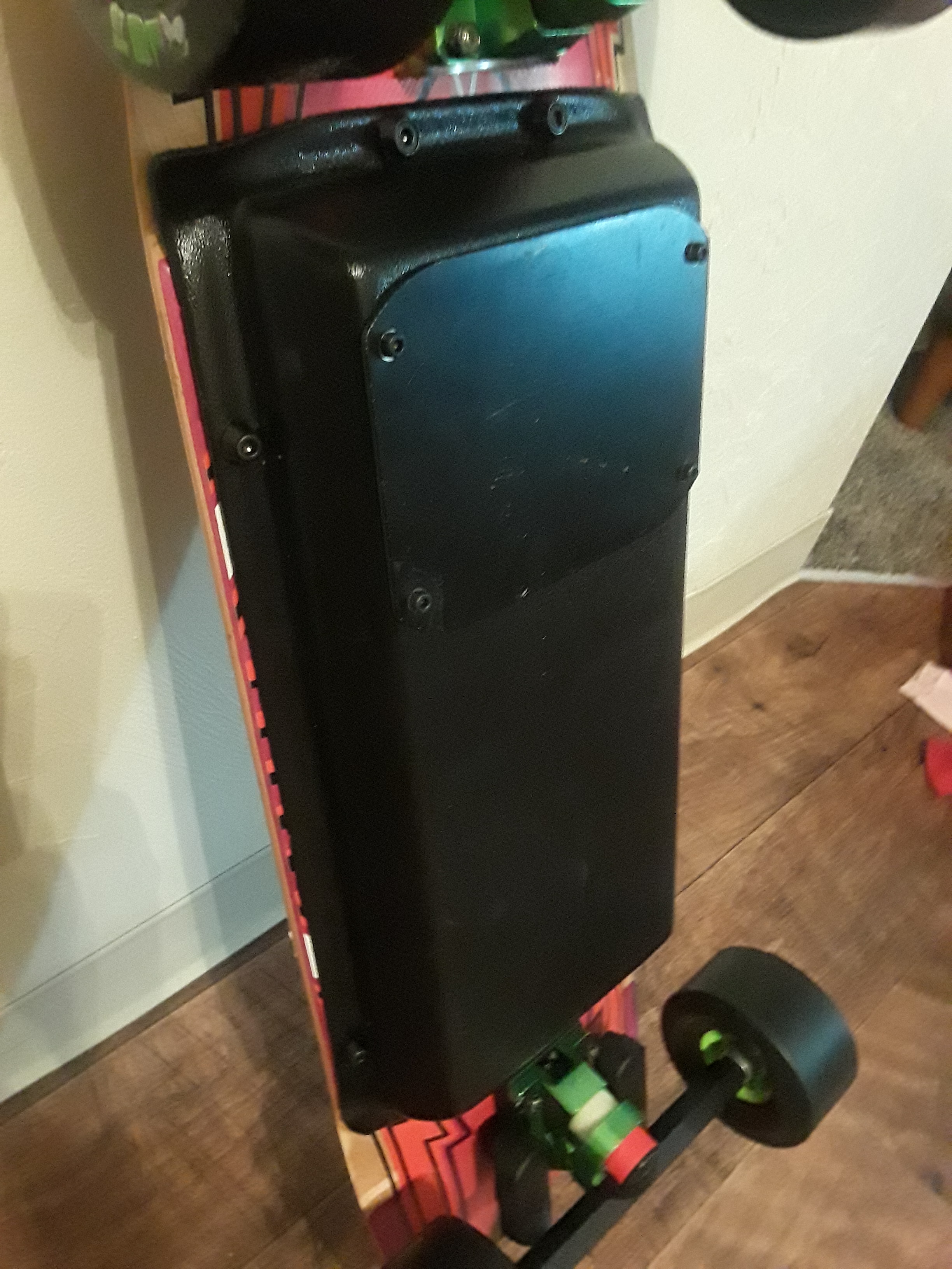

Removed heatsink.
Cut mount area from old enclosure to use as clamp/ mounting brackets for heatsink.
Cut hole in enclosure.

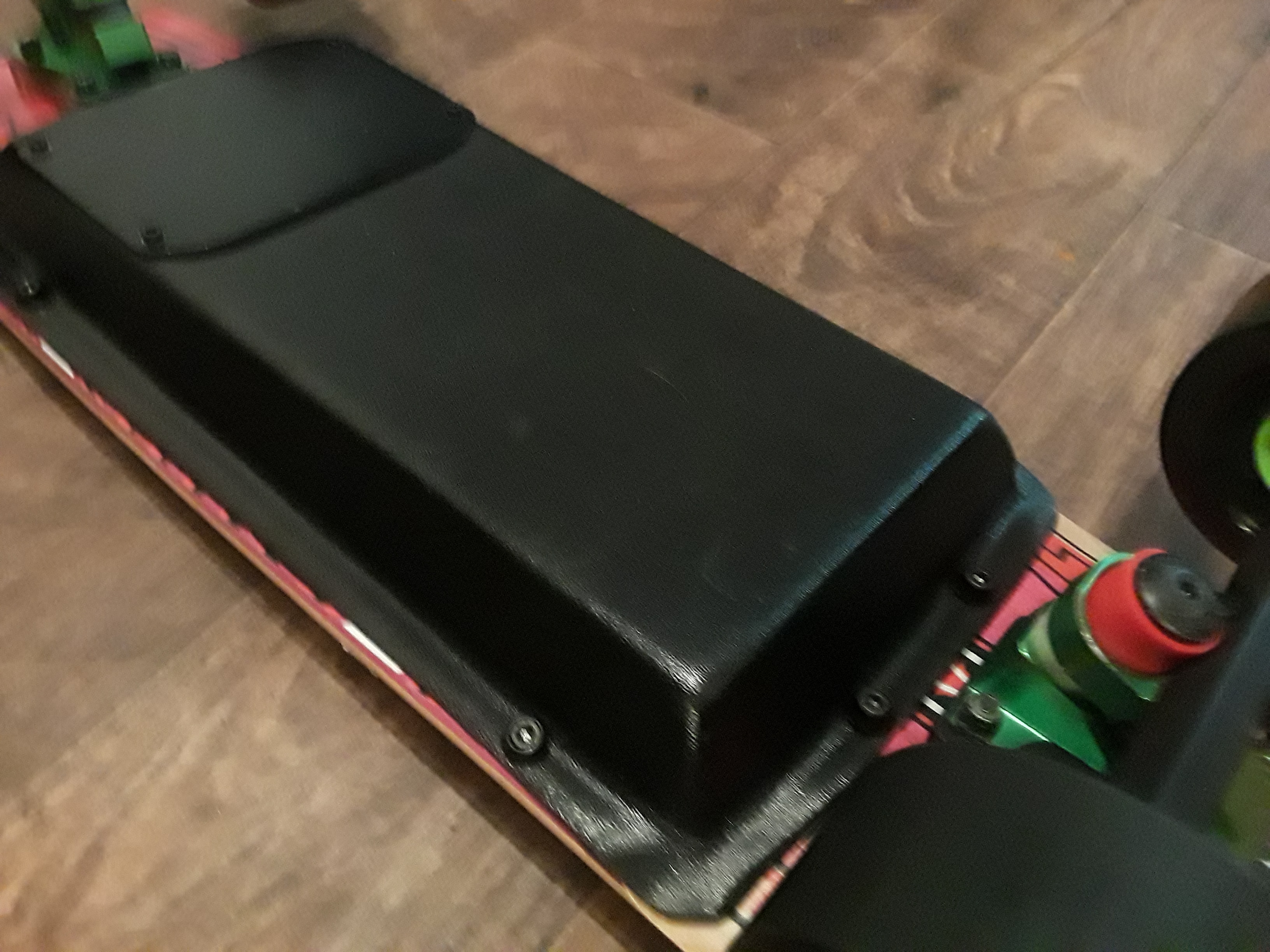

Slapped it together
Ill mount vesc with heat transfer tape and probably toss some rubber over unused heatsink surface.
Still need gasket, should be here Wednesday.
And ill add one if not two more bolts on each side.
Battery will be attached with velcro to deck while vesc will obviously be mounted to heatsink on enclosure.
Need to figure out loopkey placement still.
Might try and do a carbon fiber wrap when im done.
Oh and i gotta seal the heatsink. Probably jbweld. Or silicone? Have both.
