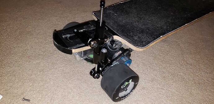

I want to try out a Motorcycle steering Damper on a Esk8 truck to reduce wobbling at higher speeds.

Tried it on the front, death trap. Try it yourself if you want to see what I mean… On the rear it works great. Never had any wobbles regardless, but damper on the rear felt like riding on a maglev board, locked into stability without sacrificing much maneuverability. Being adjustable was nice, but in practice I rarely felt the need to adjust anything since any added benefit just baseline helped an already stable setup, and regardless of the setting a full lean was still possible.
I don’t go fast anymore so I don’t really need the added stability, but when I was using it (and needing it, or at least benefiting from it) I constantly wondered why this wasn’t a thing for every fast setup.
