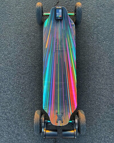

First time making a build thread.
Picked up this Gen 1 FLUX AT recently and set out to make it my own. Previous owner had already changed out his motors to these Flipsky 190KV 63100 Motors, the rest was stock. I cant believe how fun it rides, Im really loving this setup.
Here is how I got it, sitting next to my Hummie build (Ill make a thread on at some point).
Here’s where it lands now.
FLUX AT Deck and enclosure
Custom printed Splattergoat grip tape
3D concave shaped using gorilla tape and cardboard shims
Davega X with flat mount
MBS Matrix II Oil Slick
Yellow Shockblocks front and back
MBS Rockstar II with 8” Tires, soon to be @Ean.esk8 rims.
15/72 Gearing
Flipsky 190KV 63100
Focbox Unity running 5.2FW
12S10P 35E
75A Motors
-70A Brakes
80A Battery total
-40A Regen total
Puck Puck Bruce, Soon to be changed to a @poastoast remote. Looking for someone that can print one in resin or another material a little stronger and smoother.

Making the 3D Concave (First time doing it). Looks a little bumpier than I wanted but learned a lot.

Thanks! Running 15/72 (adding to the main post)
Unfortunately these are the 10mm D shaft motors, so finding others will be tricky it seems. I know flipsky has 16T though.

No problem hitting 34/35 ish. Gets there pretty quick haha.

I run 16t/72t with mine and it’s perfect ( i bought the 63100 190kv keyway version :slight_smile: ). plenty torque starting and at 35mph. I run 8in tires though.
It really feels great, at 15/72 it’ll tap 35 and feels great all the way there. So no real need in my mind to change the gearing.
My hummie is 20/60 on 6” tires and will break 40mph so Ive got that extra speed available if im feeling so inclined.
