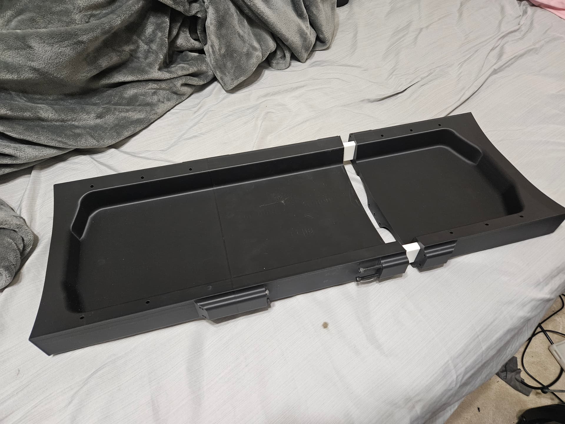

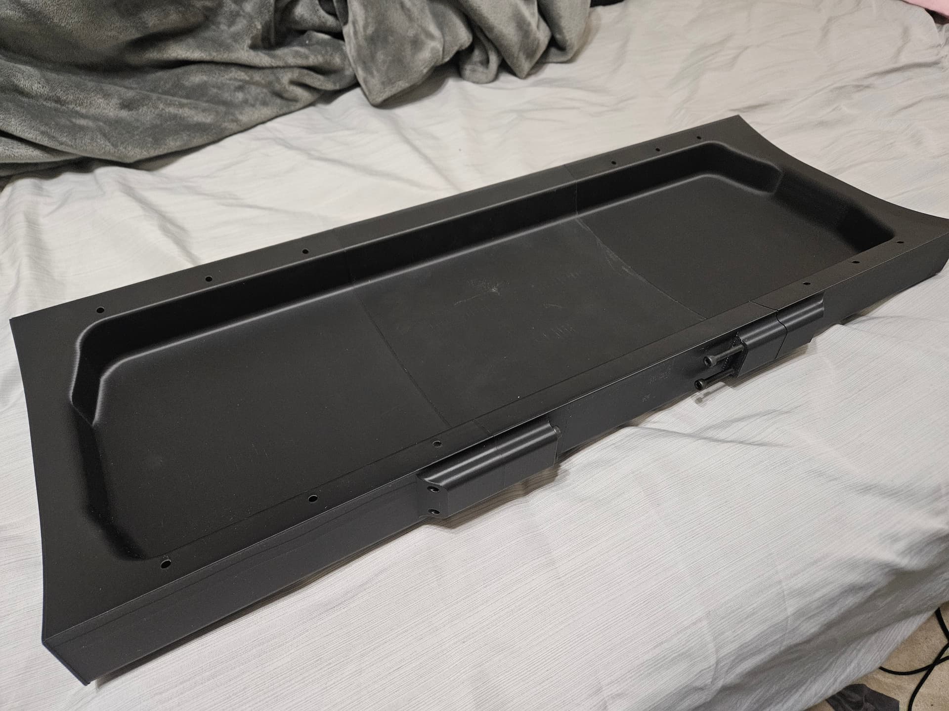

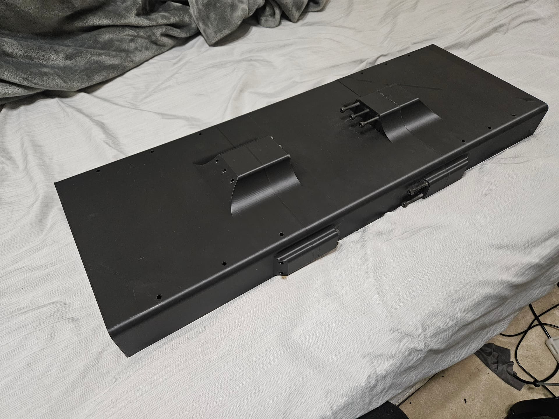

Back to the updates on the board. Bit slow going between work on the BRP hubs and my personal life, but here we go.

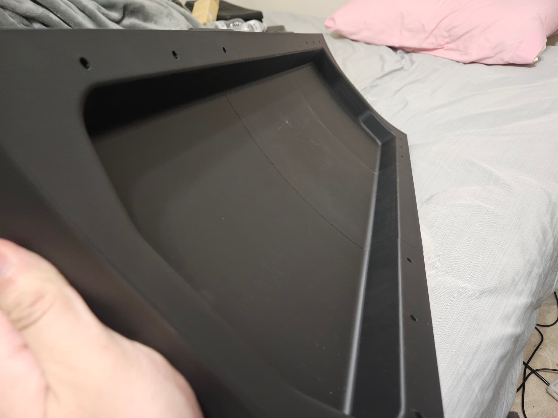

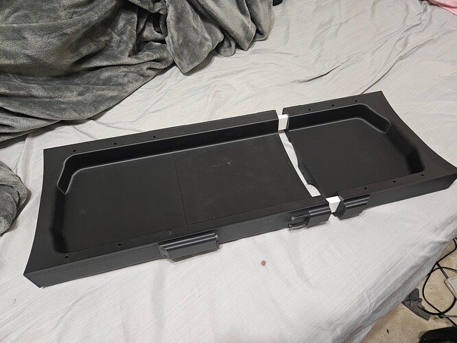

Multiple kilos of filament (I’m pretty sure I’m at LEAST 13 kg in on this project) and loads of carpal tunnel from screwing in the ridiculously long M5 hardware later, i present the V4 enclosure mold. I’m gonna cry if i have to make a V5.
Hopefully, some sanding, high build primer, and more sanding gets the surface smooth to the touch.

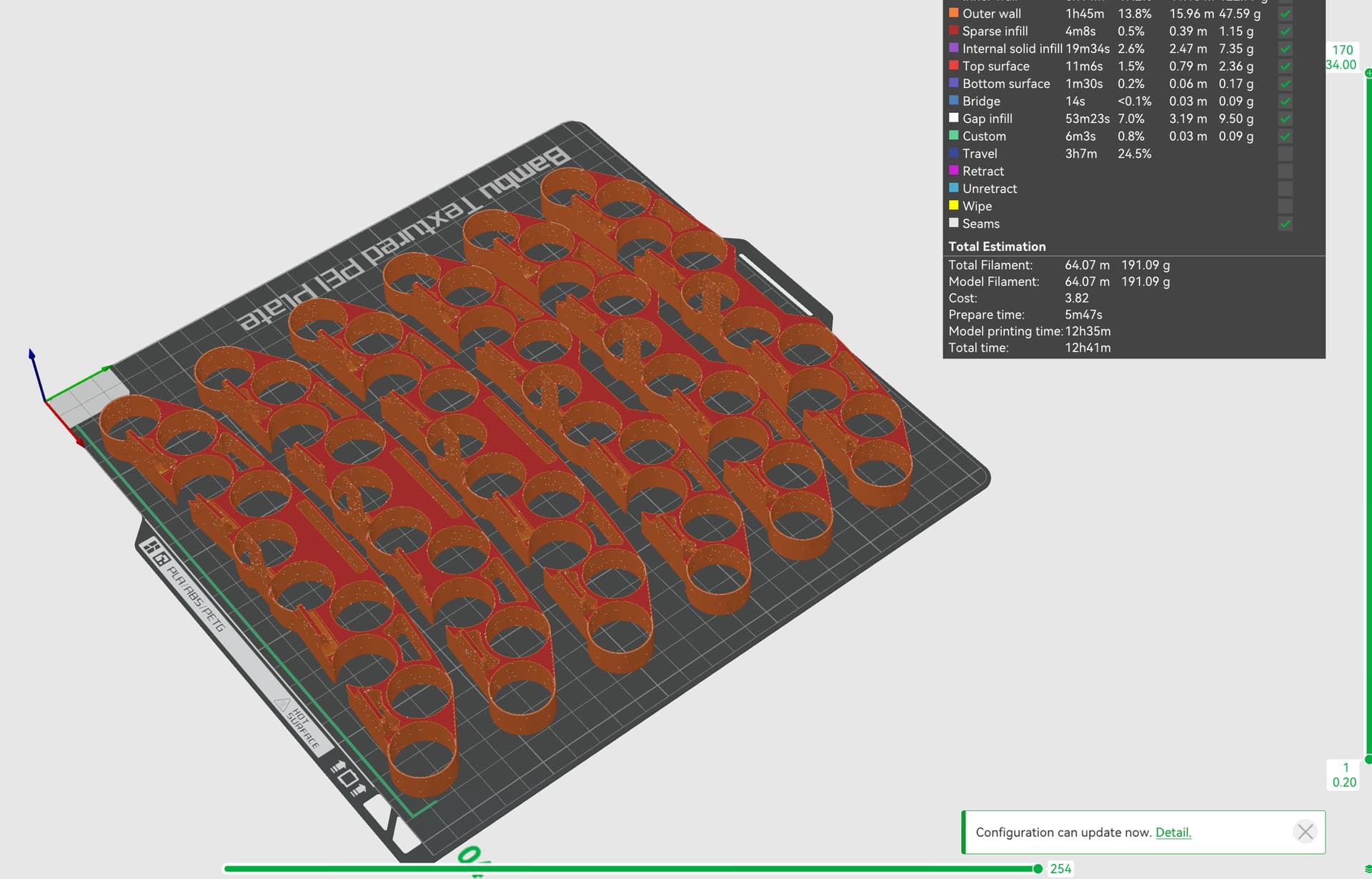

Annnd because esk8con is sneaking up on me, time to get a head start. Test printing the cell holders.
