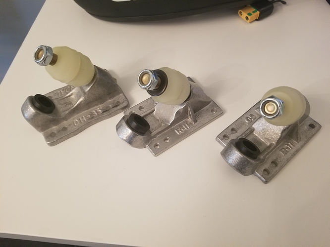

I have a set of 35/42/50 Randel base plates… brand new… I am not using them if your interested
I was looking to get a set of 2 randall rII black 42 baseplates. Lmk if you can hook me up. Link
I’ll be running 35 rear on my Evo, with the dewedge it will be 25 or so, and 50 upfront dewedged to stay 50.
50 front/35 rear has always served me well though.

Sorry for the late reply… I have one each of the 35/42/50 baseplates…
how much do you want for the whole lot?
or how much each… I’d like the 35 and 42 but will take them all if the price is good… I’m in So. Cal.
