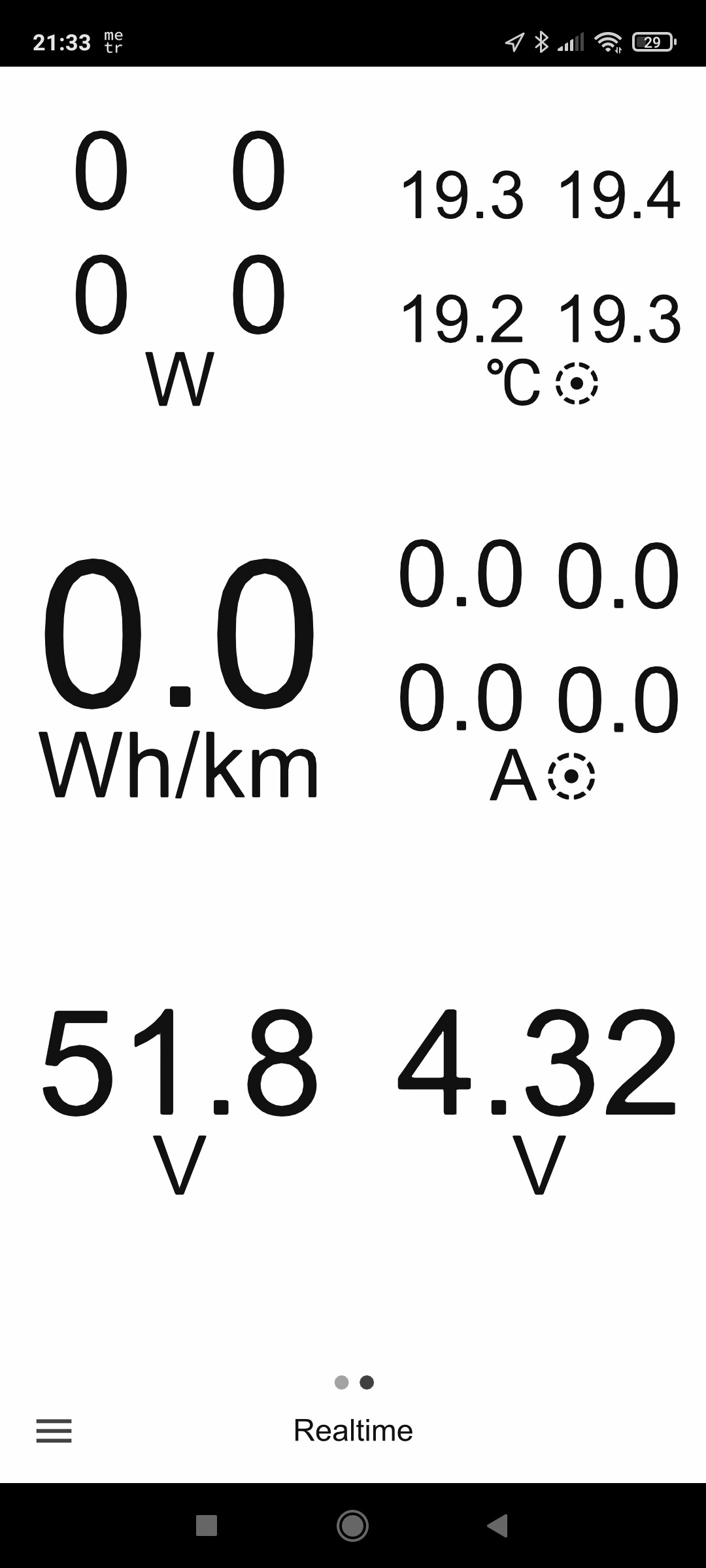

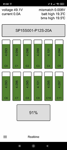

may be the same issue i have
my metr is reading always like 3v above what the bms is reading
dunno if metr gets values straight from the vesc though
3v?? no way, show me proof. That’s crazy, mine has never been that high.
You can’t exaggerate when that’s like 20% of your battery life
pic in the morning
often battery on metr says like 52.5v when its really 49.5v charged and things like that
dunno why it happens
@ShutterShock here is the battery when nearing full charge
metr and bms
this ended up causing me the other day to overdischarge my battery all the way down to 2.6v a cell cause it didnt cutoff until then
