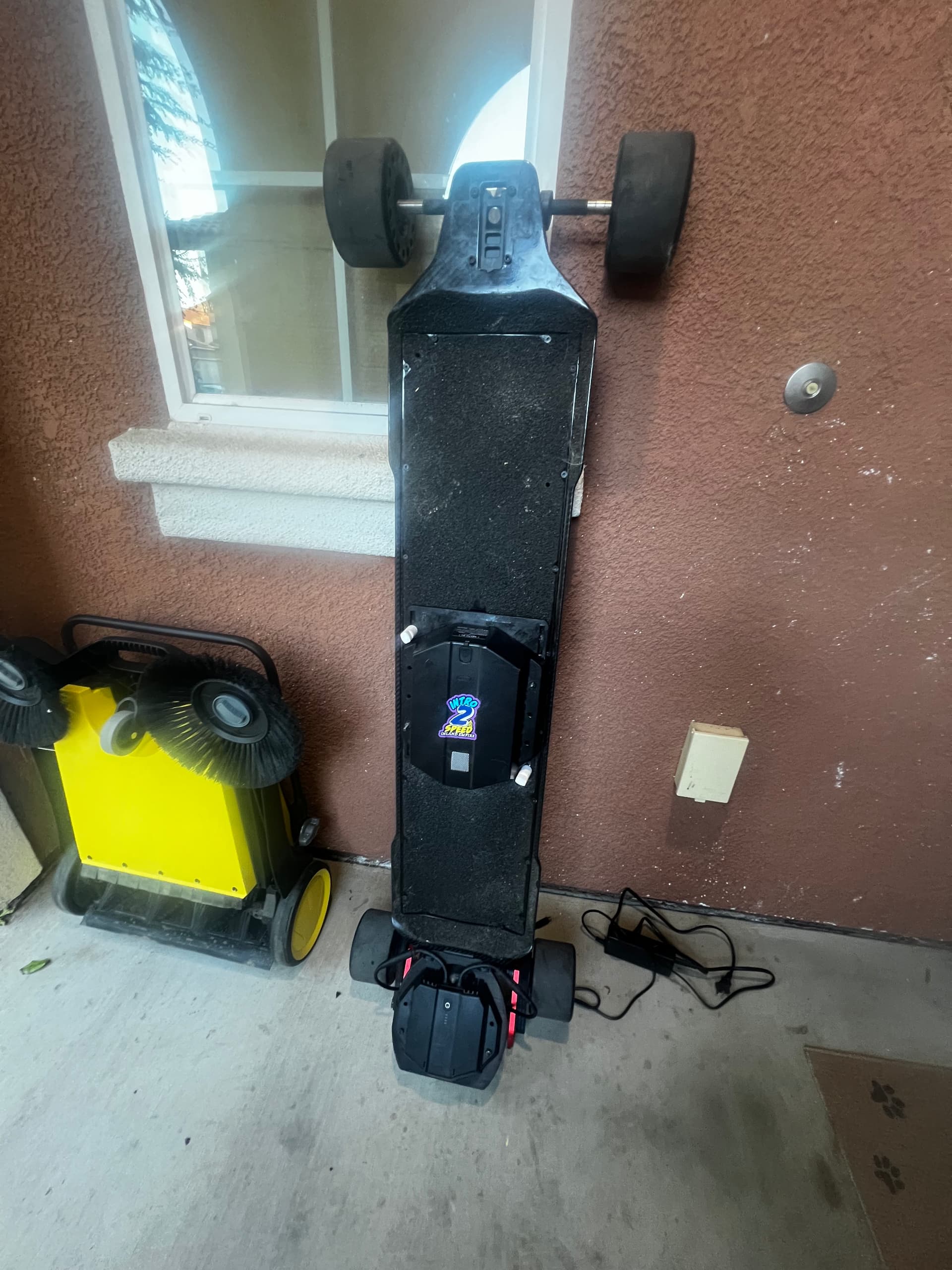

SE1 Dragon Deck
Mad Links
MeepÒdachi bottom left.
tommiboi Odachi 45mm drop.
HD 3 links
