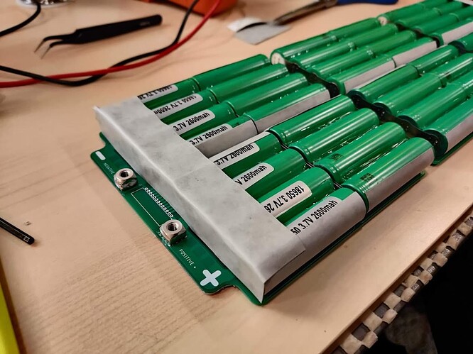

Yeah there’s an ongoing debate within my network about about using screw terminals. One of the main arguments against it is how to mechanically secure the cable to the terminal that stands up to vibration without compromising electrical contact.
I am not a fan of screw terminals because if the wire moves, the strain occurs on just the metal part of the wire and not the insulation which leads to the wires snapping off at that point. I wonder if they make screw terminals with built-in strain relief. This video was informative:

I’m pretty sure that @baein was not talking about this kind of screw terminal. I think he was talking about the kind found on the ZESC:
And also found on my KitPCB battery systems:
These can be rated for huge amps, as they are basically just big blocks of copper or brass. They are also super easy to solder or wave solder to a PCB. They do, unfortunately, require the customer to crimp/solder their own cable lugs to affix to the terminal, but its much easier to make a good quality crimp for large gauge wire than it is to make a good quality solder joint (for most people).
One possible solution for super high current ESCs would be to use these screw terminals to make affixing a cable/connector set to their PCB much easier (rather than having to solder a single 6AWG wire to a flat PCB contact) and make the other end of the cableset a standard connector that’s more user friendly, like a QS8 connector. Then the ESC would come from the factory with the cableset screwed/loctited in place permanently, so the end user never has to worry about screw terminals unless they want to.
