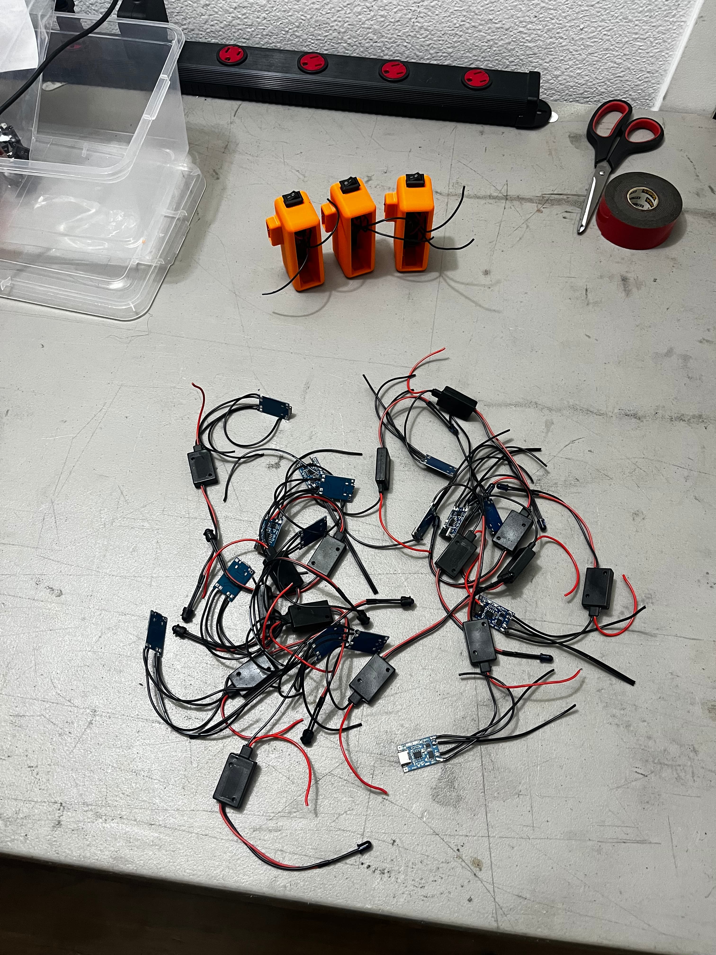

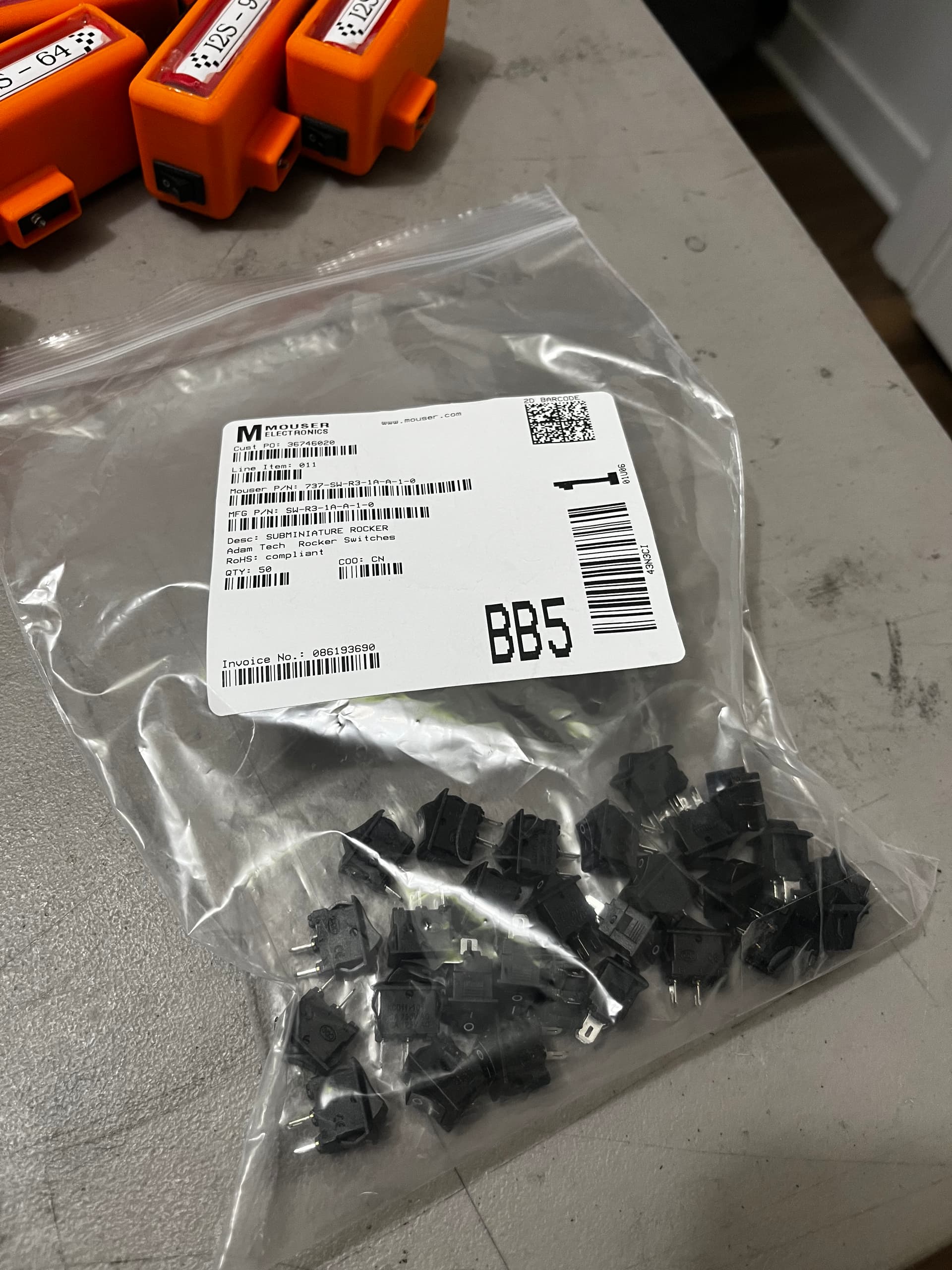

I was tasked with building standalone enclosures for everyone and soldering together a battery, BMS, and a switch. After much iteration, this is what I came up with;
One piece print with just enough space for the transponder, BMS, switch, and an 18650 to hold everything in place. I initially made a single unit to test and make sure the design would work.
Because I couldn’t leave well enough alone, I disliked how the base station didn’t have a power switch and was powered off AAA batteries. So I designed a new backshell to replace that with the same BMS, switch, and 18650 as the transponder case
Print quality isn’t great, but that’s fine. Doesn’t need to be that durable.
(Charge port is under the grey rubber case)

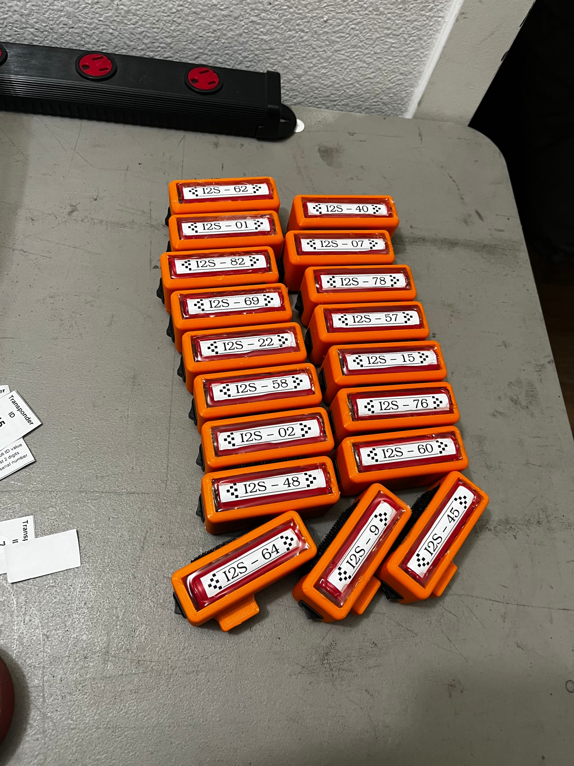

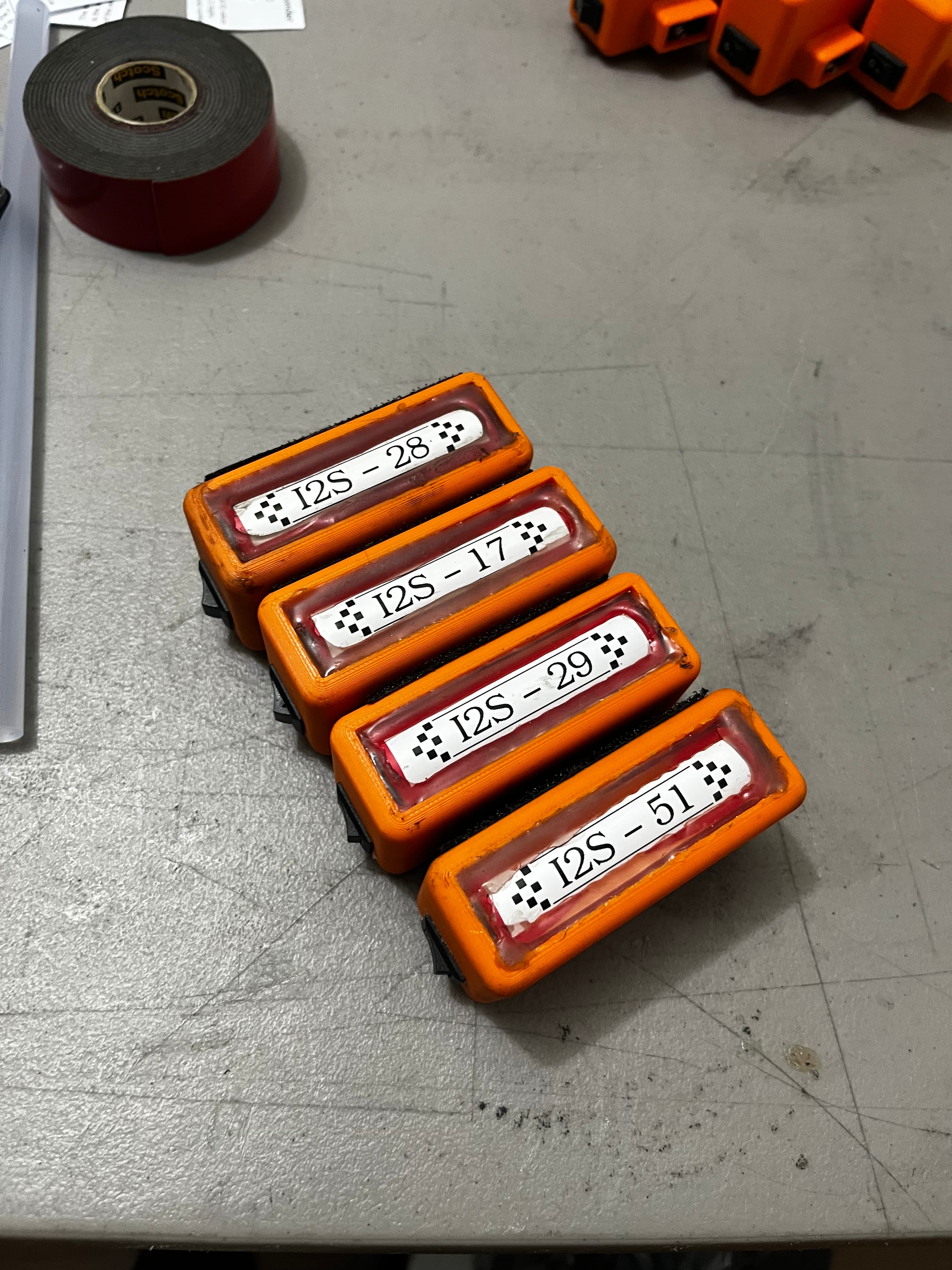

After a track night with no failures, I deemed it good enough to go into mass production on the transponders!
We went with a nice bright orange so they’ll be easily visible. Think it’ll give a nice feeling of community seeing everyone having a transponder on their PEV.

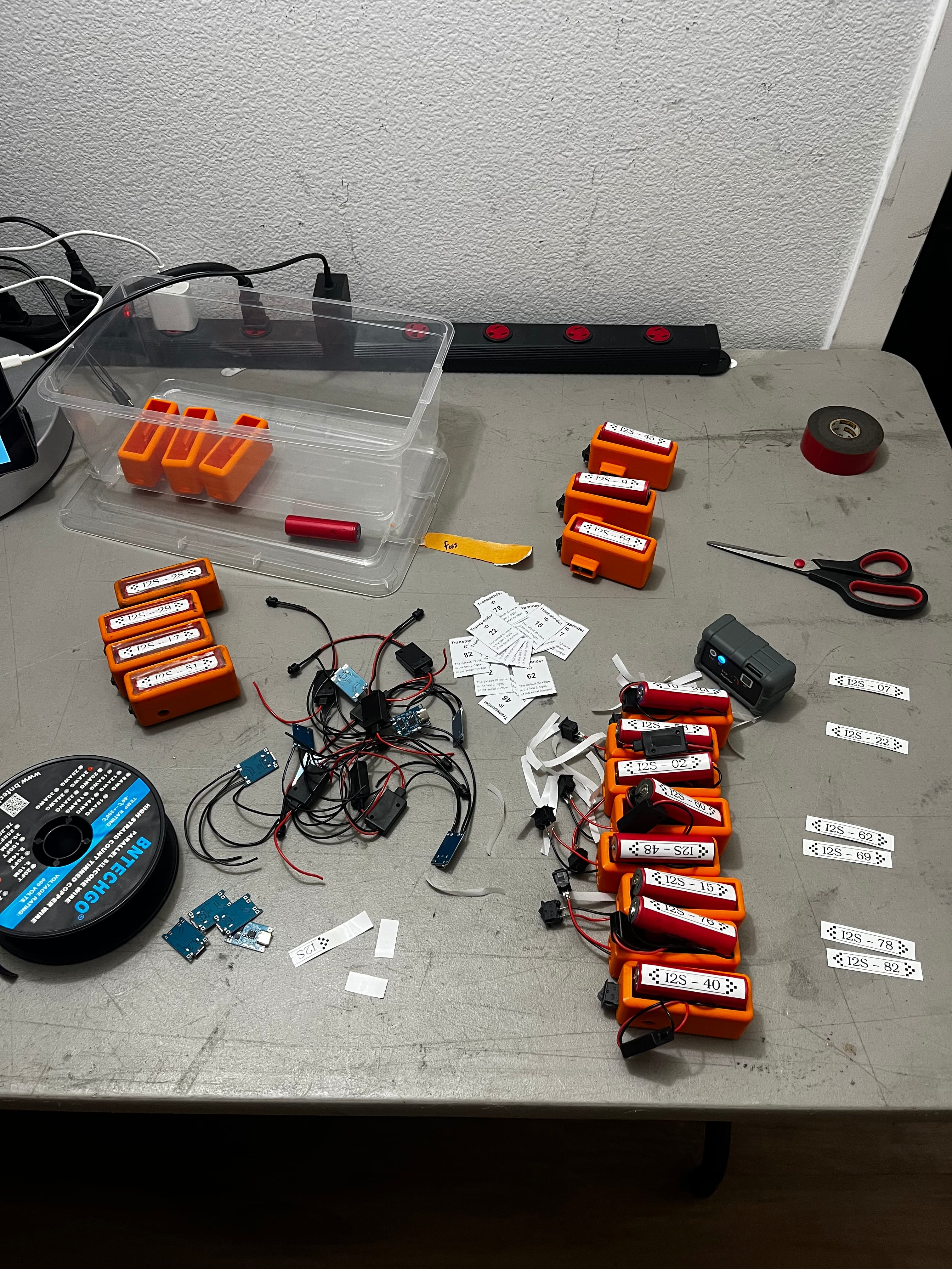

And that’s where the project stands now. The plan is to assemble the rest of them this weekend and start giving em out to people next week. Psyched for the upcoming intro’s with these!

  • 18650 Battery cell (any)
  • 3D Printed part(s), misc Wire and hot glue
Assembly:
  1. Solder together all the wiring, except the switch. Battery goes to the BMS, and the transponder negative is soldered to the negative output of the BMS. Solder a wire to the positive BMS output but leave unconnected.
  2. Hot glue to BMS board in the bottom
  3. Put the LED into the associated hole (Lap monitor ships them with a snap-in mount)
  4. Arrange wires neatly, transponder goes on top of the BMS. Stick the two loose wires out of the switch hole
  5. Solder the switch to the wires, turn on and verify that it works
  6. Push the switch into the switch hole, and the battery into the top. Arrange the wires so none are pinched, the battery should be fully recessed inside the lip of the enclosure.
  7. Put a bead of hot glue around the battery cell to hold everything in place.

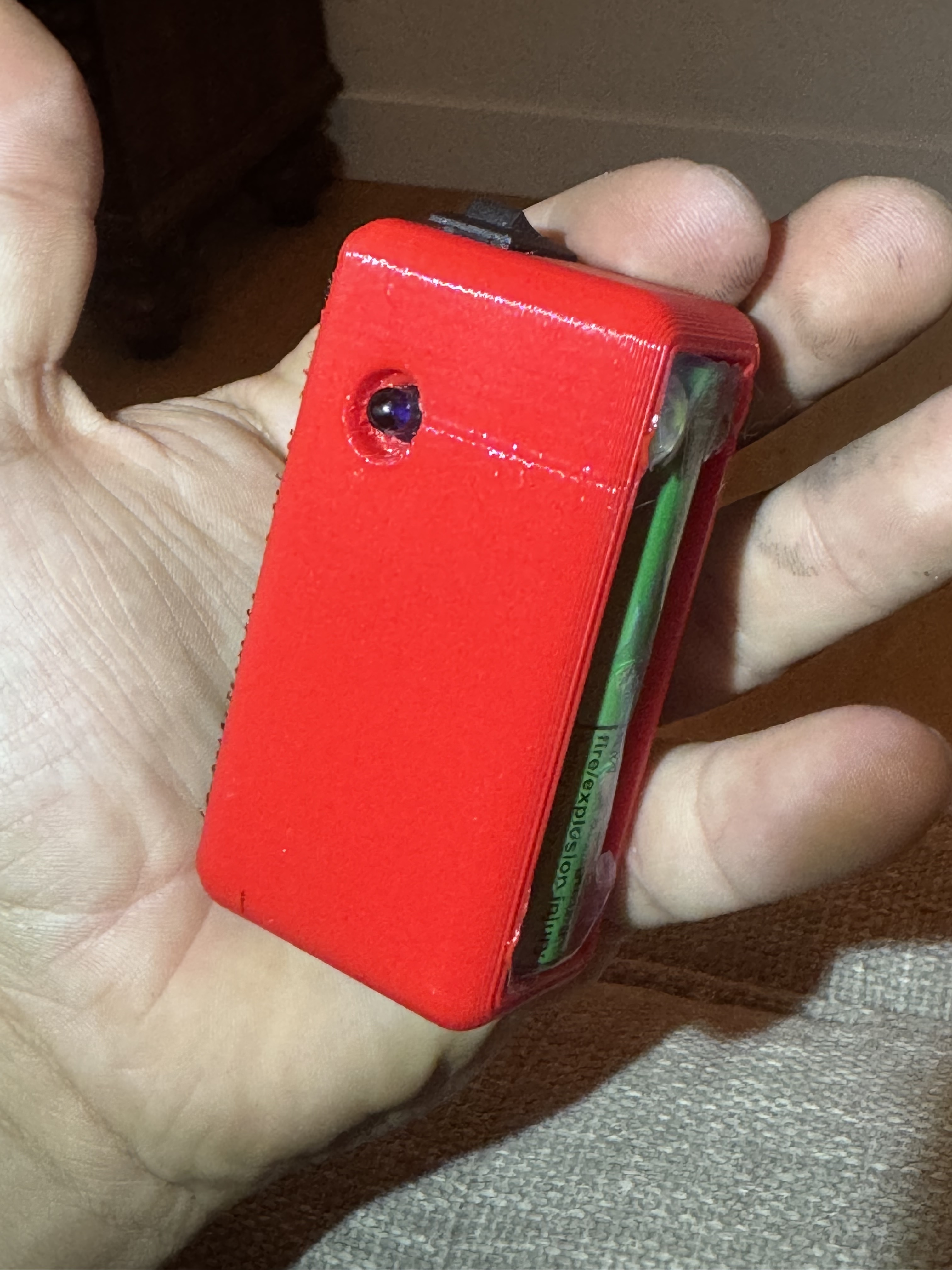

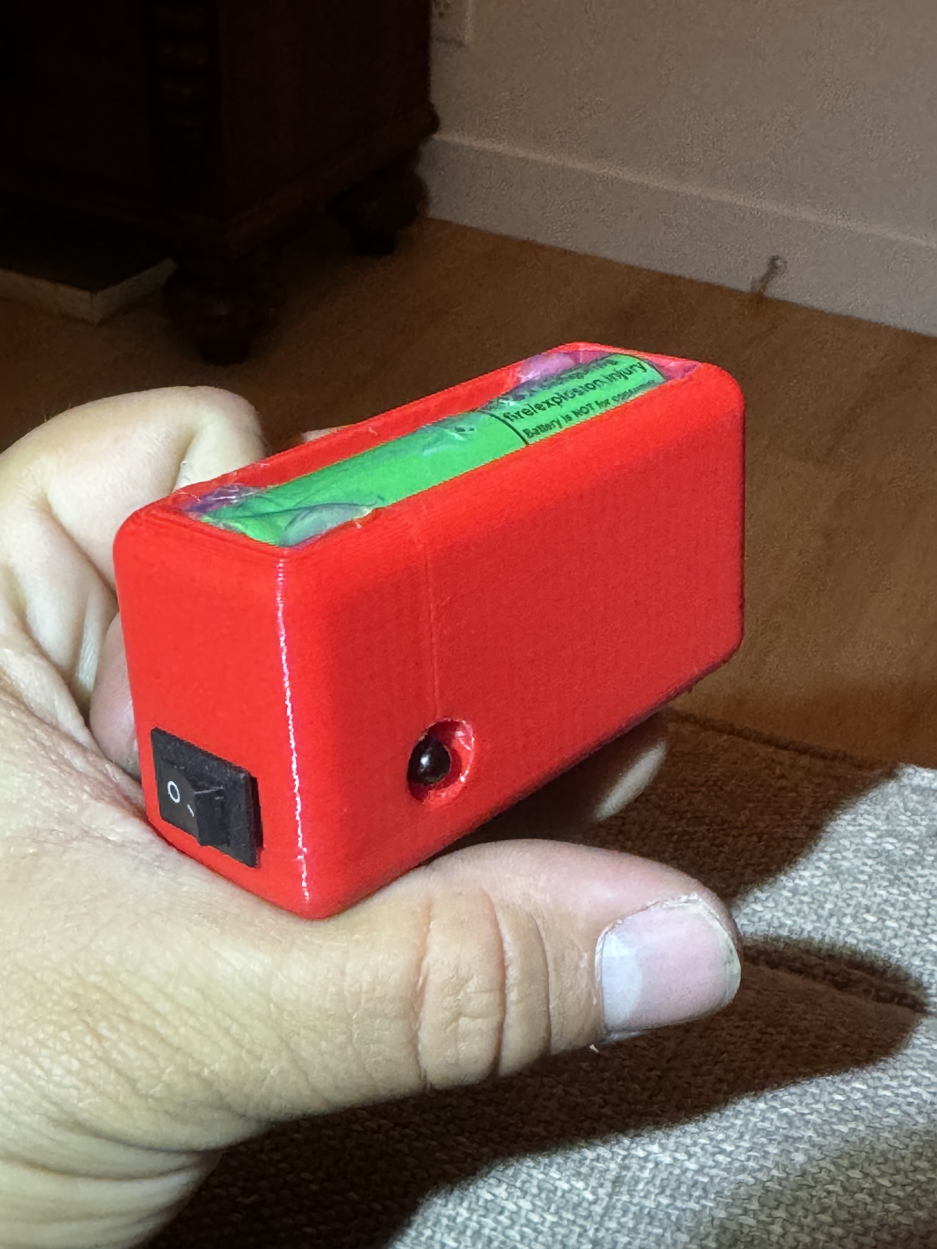

Couple folks in LA bought several of the integrated LED ones a few years ago. I designed a new case to work with this alternative format
File added to post 7
Successfully printed a new case for my transponder & installed electronics :nerd_face:
