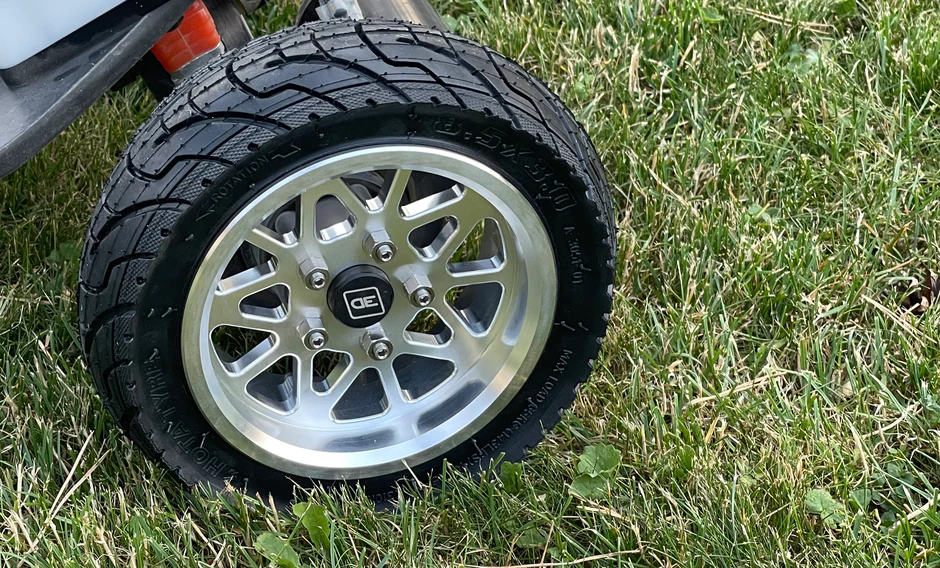

Wheels- Definitely X-Cell for standard hubs for lots of reasons. Or the bigger 3D Servisas hub system looks amazing but there are probably less tire options and you might not be able to use other brand’s geardrives, not that the 3DS one isn’t good.

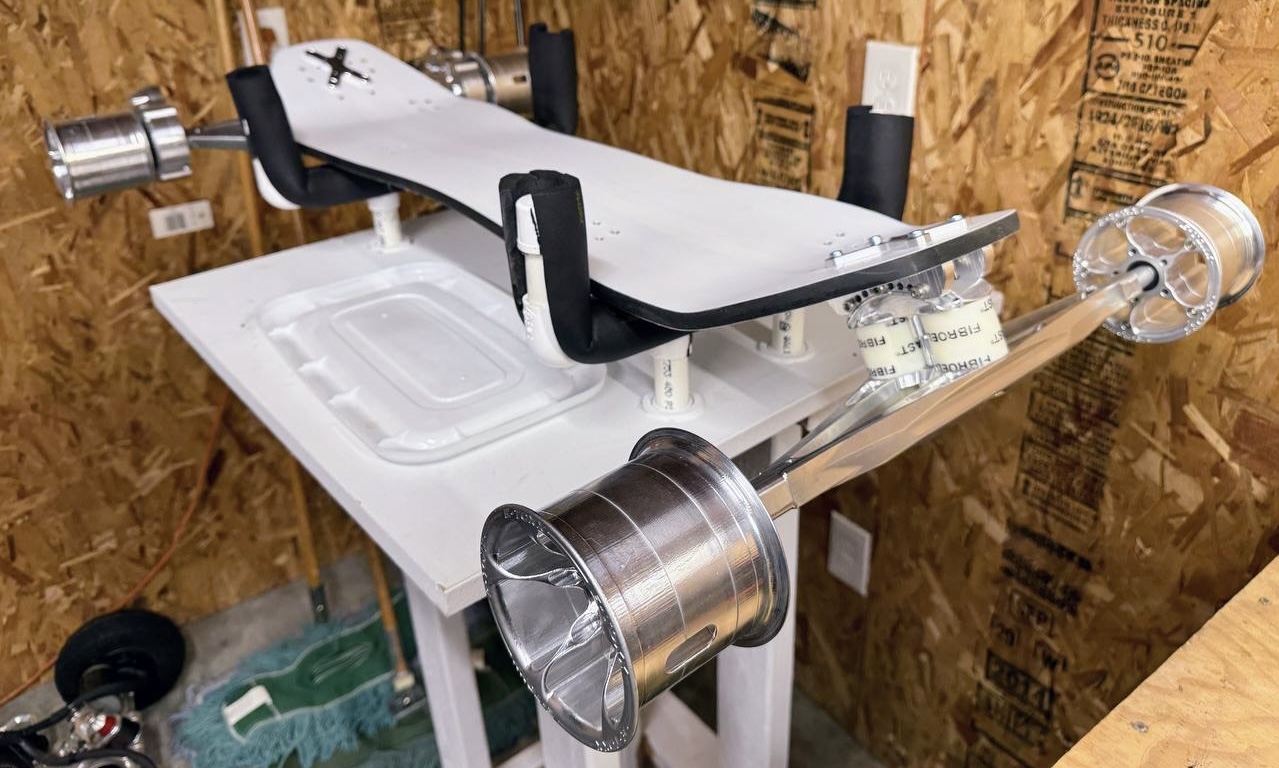

Trucks are tricky, depends lots of preference. Tito dualities and Matrix 3 with riptide singularity bushings are really popular lately. Idea (efreedom.eu), 3d servisas, etoxx in the past (pictured for inspiration) and maybe some other brands I have missed make nice cnc trucks.

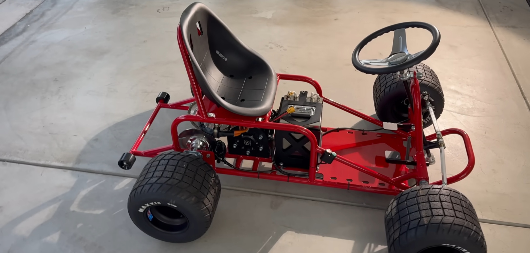

Currently, gaining a lot of inspiration from this, and as far as from what I wanted to do for the DIY I want to literally be able to tackle everything and be able to go the distance to get there. You can literally almost see the board if you flatten the battery out and take the seat off of this :smiley:
Seems like project iron giant a bit then
I know it’s an annoying question but might a bike be a better platform than a skateboard if you want lots of range, speed and offroad capability and it’s not going to be light or compact anyway?
