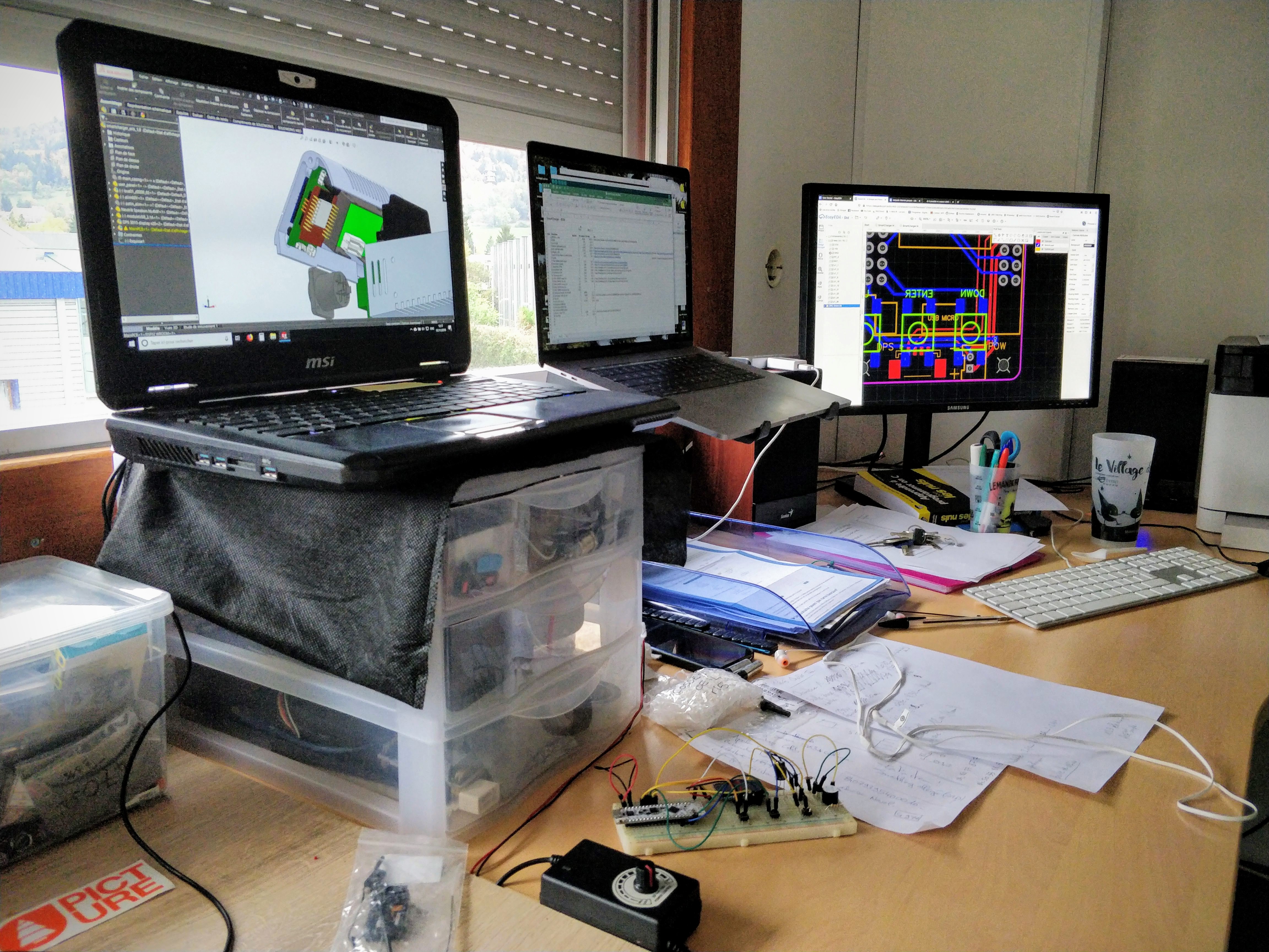

I’ve been working hard those last days :
  • Re-design of the casing
  • Design of a brand new all-in-one PCB
  • More electronic prototyping for replacing components (to lower the price).
Issues / design choices
Presently, I’m using a 480W power supply.
This model is great because the fan is temperature controlled. That means that it blows on only when warm, keeping the charger quiet most of the time.
BUT, it allows only 8A@12S. Disappointing for most of you I guess.
I found a more powerful PSU (up to 10A@12S) with the exact same size but no temperature control (fan always ON).
Finally, some PSU are even more powerful to reach 15A@12S but alot bigger, so I’d need to modify drastically my casing and build one to check potential thermal and air flow issues.
Your thoughts on these points ?
