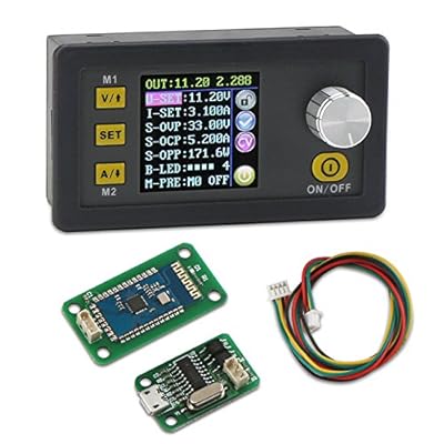

I built one of those too, but for some reason my charge current tapers off as it gets closer to the target voltage. So basically I can never fully charge anything with it. I’m not sure if something’s broken or i’m just doing something wrong. I’ve just been using the output from the dps5015 to power my ISDT Q6 charger for charging lipos but can’t really charge boards with it since after it gets 70-80% full the charge current drops to almost nothing.
yea, it’s constant current, then constant voltage so that tapering you described is intended.
if you set the final voltage a bit higher, like +0.2v, so you can hit your voltage.
ahh that makes sense. so like you said, not really useful for 12s but fine for anything lower.

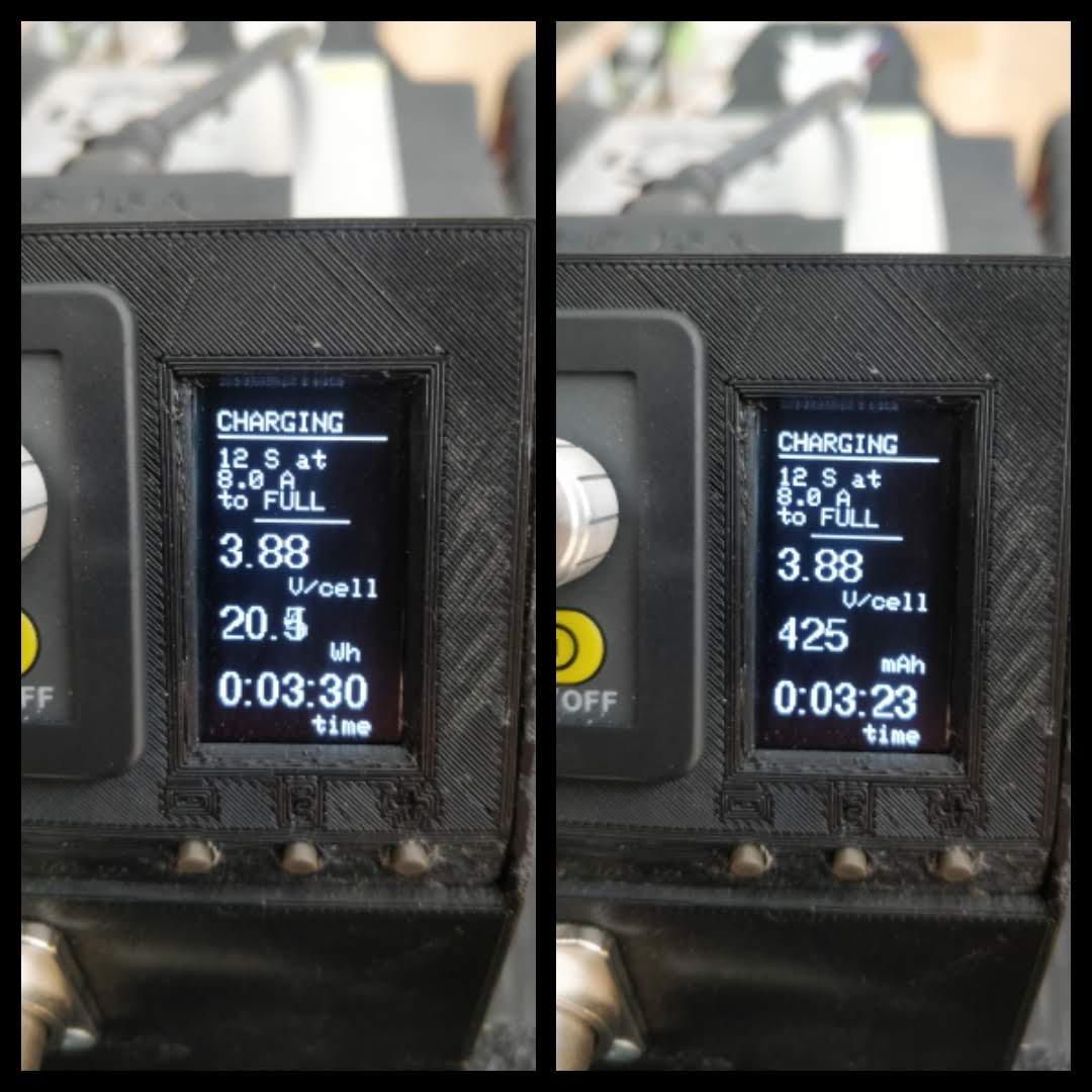

Charge display improvement
By simply pressing the left button, the user may switch between mAh and Wh value display while charging.

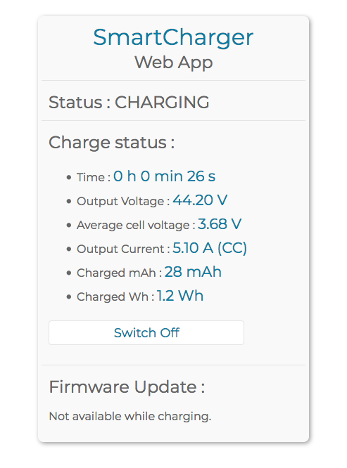

Also added : average cell voltage.
The web app also displays more data
